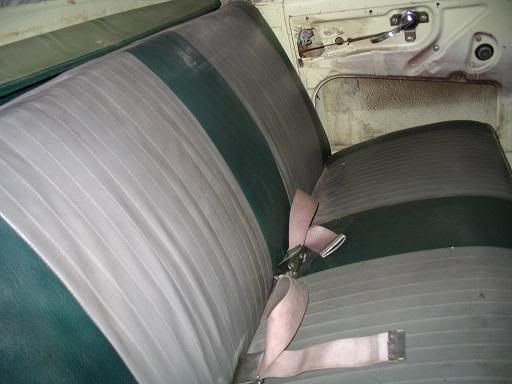

Currently doing up an EK ute & wondering if anybody has a picture of a front seat restored to original - I'm after the number of panels in the insert, and is the back of the seat open, ie the area below the 'flap' that goes to the back window.

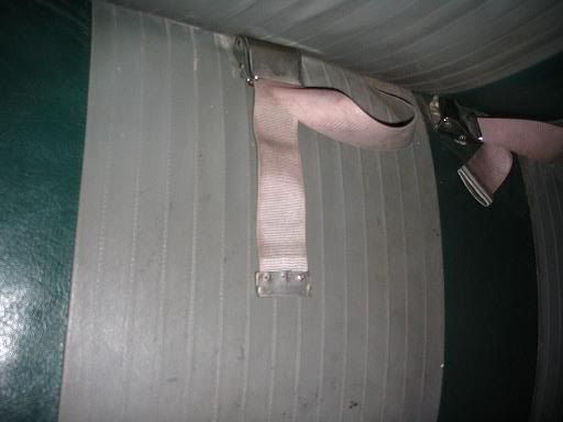

Hey heres some pics of my seat still in original condition hope they help looks like theres 15 strip panels in the grey section not sure on the back cars wrapped up at the moment so it was impossible just to get these pics someone else might be able to help

Not the best seat in the house but looks like its still original :lol:
I counted 15 panels on the grey insert part. What you can see are all the original panels, none are missing. The gap on the left side is where it has come away from the edge, not a panel missing, same as the gap on the second last one on the right, so its 15 on mine.
As far as the back of the seat I cant see without taking it out but it feels like there is no material covering the springs etc. If i take my seat out in a couple of weeks Ill post some oics of the back part.

Posts: 14067
The backs are definately not covered, my FB ute seat is the same on the back with a different pattern on the front.
