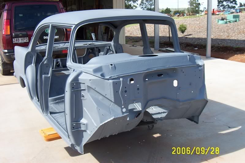

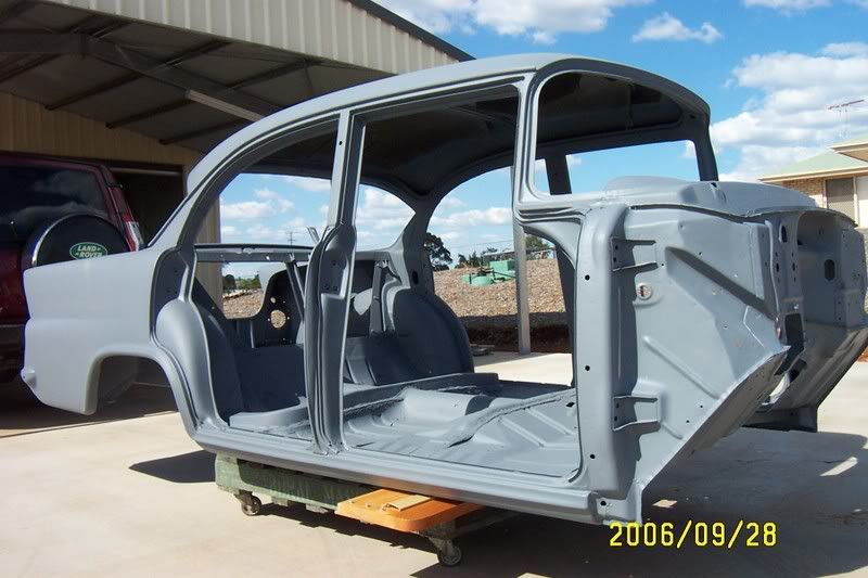

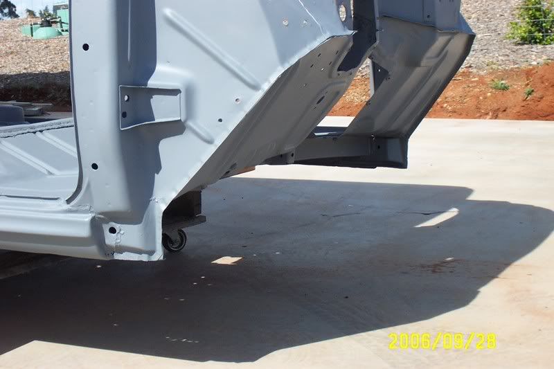

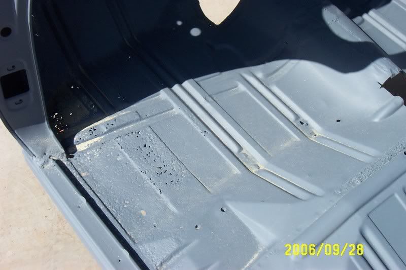

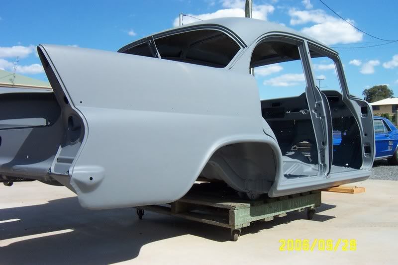

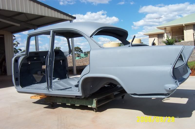

Finally I have the FB back from the sandblasters without to many more surprises.
A couple of the floors may need replacing and the L/H sill panel.
Thats probably the worst of it.
Now the fun begins.

i have installed rarespares floor pans into a EK Sedan, also sills, they fit very well i reckon, you just need to go slow with the cutting out of the old one to make sure it fits properly and its smooth sailing from there!
I've ordered rare's floor pans, hopefully I have a NOS L/H sill so that should be OK. My 4 days of have been very productive, have the cowl panel ends done (proved to be a lot of work), the R/H front floor pan (very little rust) the L/H rear quater (rust), excess fire wall holes filled and the big XB fuel tank fitted.
