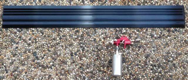

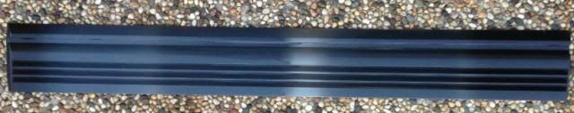

Did a little experiment on getting an original look without paying a motza for Clinker Grey.
Motospray have a "satin black" and mix a little white and you get a nice original looking dash colour.
All acrylic paints so no issues down the track.
Needed to vary the white levels several times to get it right.
Did several samples.
Still has a nice smooth but satin look. A lot nicer than the dull "flat" paint, and without the Gloss reflection and glare.

Thanks Tim, I couldn't get trade price, :sickk: but it was 3 x dearer to get 1 litre of the clinker Grey, and that was still going to come out a gloss, unless I added a flattener, add extra cost again.
$69 for Clinker Grey, $22 for Satin Black (off the shelf) and they gave me a small can of White for nothing.
Happy to hear if anyone can get a litre of Clinker Grey (in Satin) for around $20 even up to $30.
