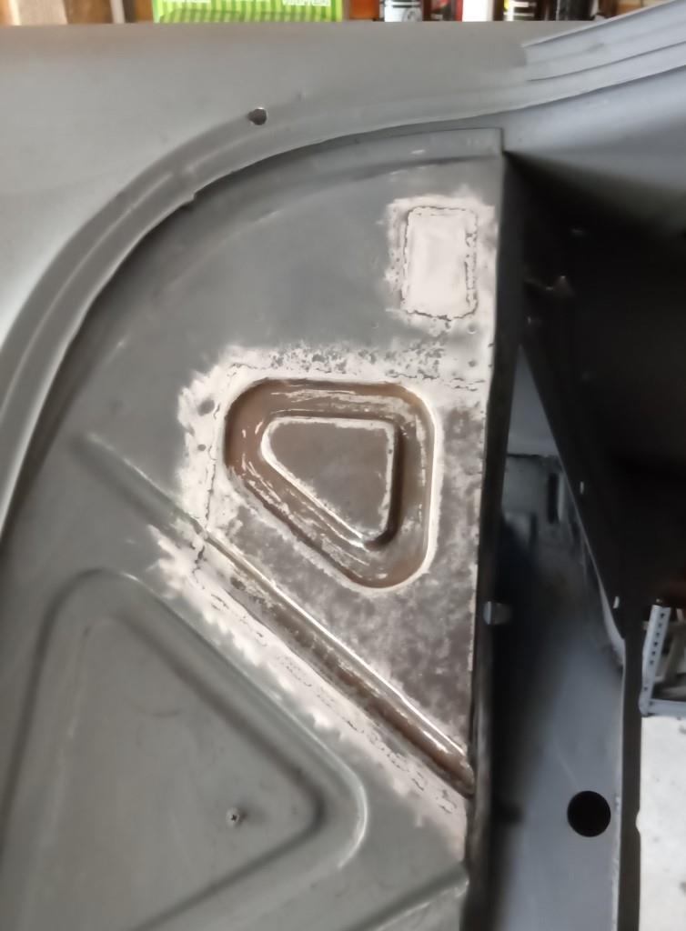

Patched up parcel shelf
Parcel shelf.jpg (62.81 KiB) Viewed 3577 times

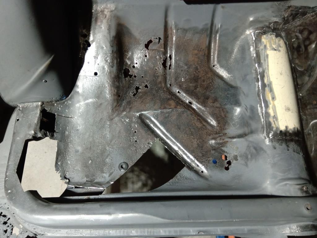

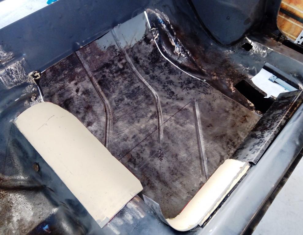

and started working on the rear seat well hole
Seat well 1.jpg (106.01 KiB) Viewed 3577 times
As I had to cut out half the drive shaft tunnel it was never going to be easy so will do it in a number of bits
seat well bits.jpg (187.39 KiB) Viewed 3577 times
Am using what I've got left of the roof cut I obtained. The metal was good, had a curve for the tunnel already started and I was really just practicing for the pan but it turned out ok so will run with it. It will need a number of smaller patches to fill the gaps though.

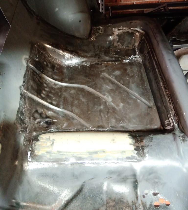

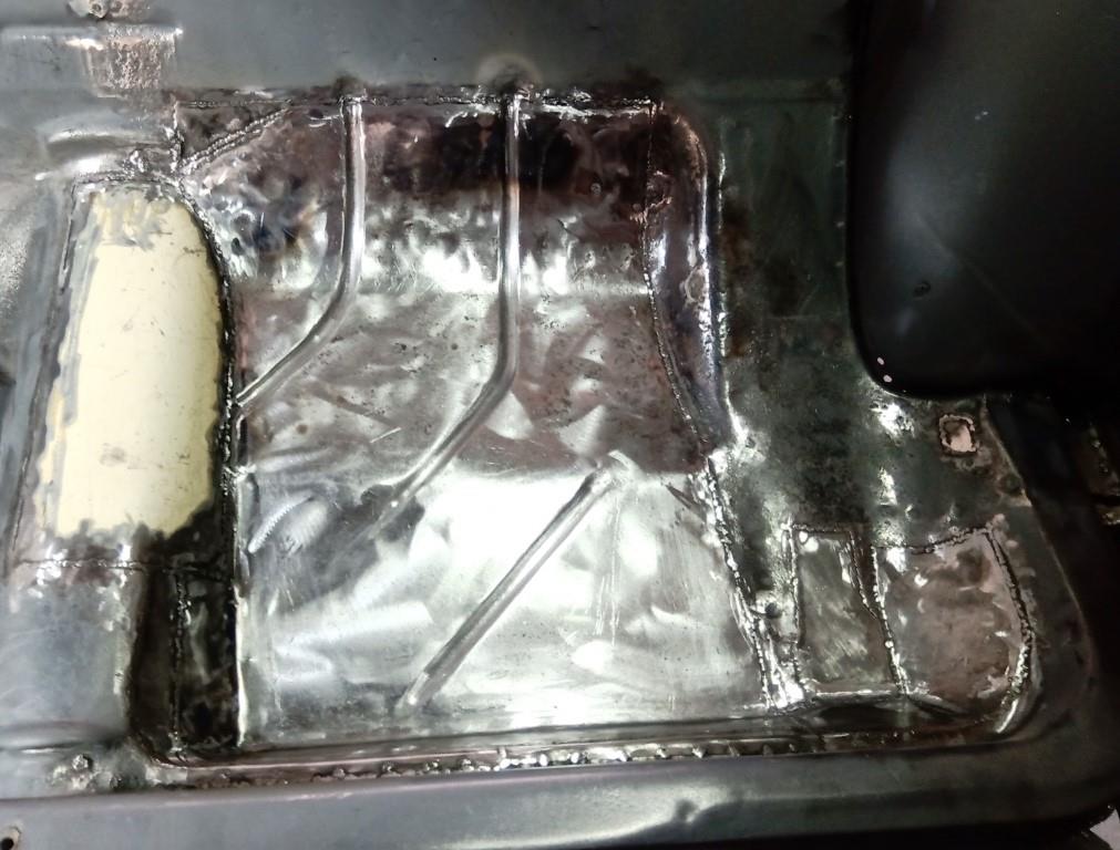

Well 11 patches or so and the passenger side rear seat well is all but done. Just some more finishing on top and underneath.
Rear seat well pax1.jpg (85.62 KiB) Viewed 3549 times
Rear seat well pax2.jpg (104.64 KiB) Viewed 3549 times
It seemed to take a really long time. At least the drivers side ain't so bad...
Rear seat well Driver.jpg (108.82 KiB) Viewed 3549 times
