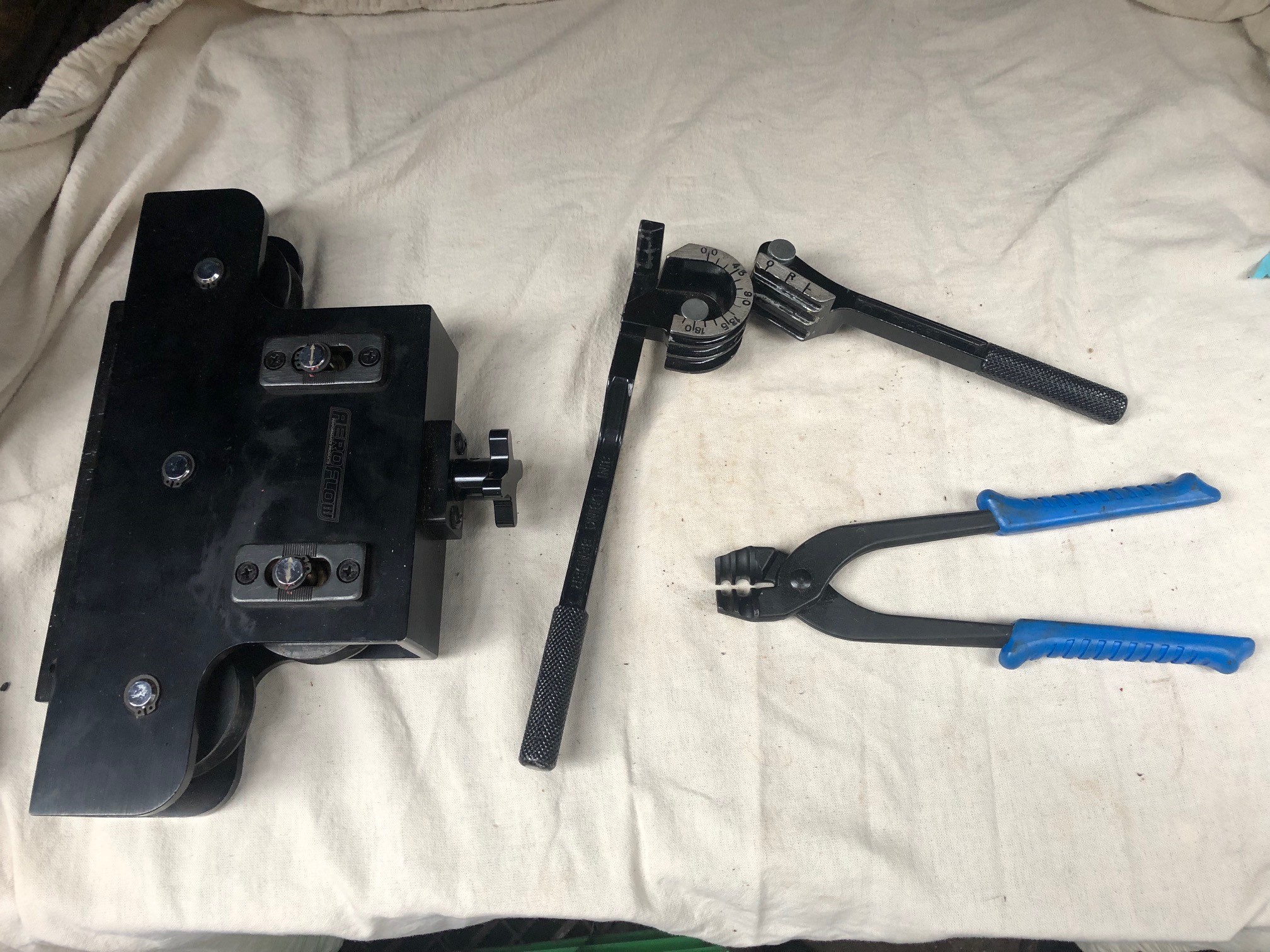

In the Shed wrote: Thu Aug 19, 2021 11:30 am
Hey Drew
I have bending tools your welcome to borrow. My flaring tool is only a single flare and I think you need a double flaring tool.
Geez thanks mate! If appreciate that but I can’t help but think the tube bending tool would be a pretty basic little bit of kit?
Can you post a pic of it somewhere?
I might be able to whip something up on the machines rather than get you to send it to me.
I’ll PM you.
Re: Wilma FB project
Posted: Fri Aug 20, 2021 11:58 pm
He’s only two burbs away Drew but yes it’s a relatively available tool.
Posted: Sat Aug 21, 2021 8:01 am
The black benderer does most of the work. Different grooves for different tube sizes. Teaches you quickly, yet repeatedly, that there is a difference between bending to the left and bending to the right (kinda like a flare tool keeps teaching you to put the flare nut on before flaring).
The blue handled one is handy in tight spaces or short tubes. Will kink long radius bends though.
The big black thing is a tube straightenerer. Pricey, but handy. Takes coiled tube and makes long, straight lengths in seconds. There are other ways to straighten (by hand, straighten through a hole in a wooden block, stretch tube) but I've found this thing to be worth the price for the amount of line I bend.
