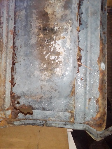

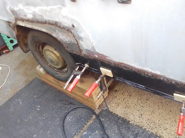

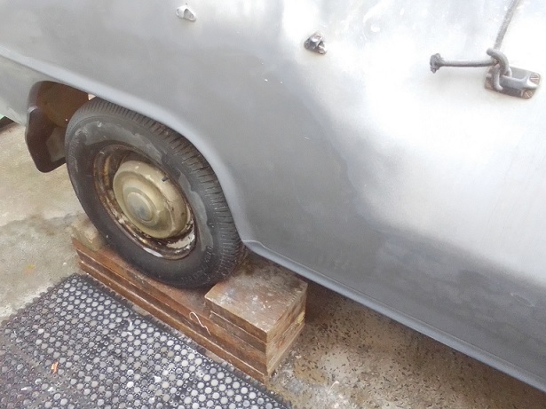

Had a go at round 2 of the driver's side rust repair --- got it sealed up against the weather for now (rain tomorrow)
--- the final shaping can happen later (5 years or so)

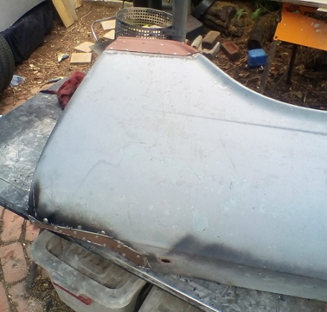

I've been underneath, sealing some bits and pieces and making sure others can drain ... no pics of that but here's a pic of one of the mudguards with some repair pieces tek screwed on ready for welding - top one is an insert, bottom one I decided to overlap (dimensions of the store-bought repair piece lend to overlapping it)

The usual rust. Not as lucky as the doors hey?
You going to spot the overlap? Weld through primer on the overlap?
I would do the top bit especially bolted to the car if you want it to fit.

Hi Clay,
Yep, plug welds through the tek screw holes and some tacks on the edges - hopefully everything will end up a recognisable shape - not too offensive a difference for FB/EK fans

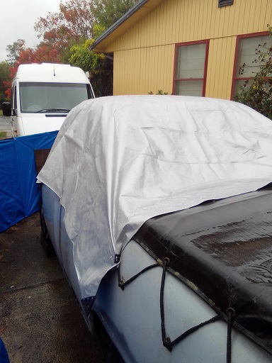

Well the rain appears to have set in for a few days and Saturday's forecast is for a top of 7 degrees.
Bought a new silver tarp (it was always a bit damp under the old blue one).

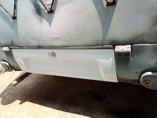

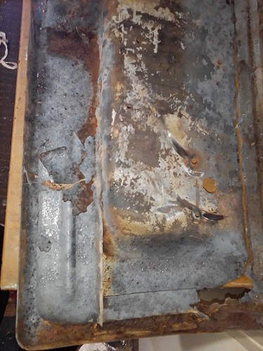

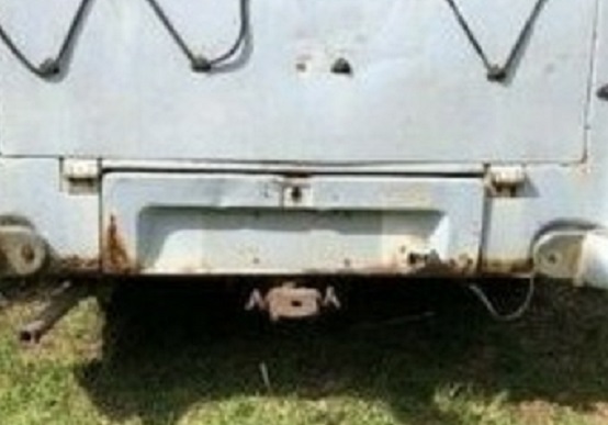

Considering the car was always a bit wet under the cheap blue tarp, when there was a break in the rain I thought I better check out the bench seat (which was out behind the garage under a tarp)...soaked...so I shuffled some bits in the garage and moved it in.
I'd been looking at the spare wheel door for a while but it's pretty far gone...so I picked up one of the plastic ones and a ten dollar cam lock to keep it closed. I screwed it in for now - when I get around to that area, I'll see if it can be adjusted to follow the body line...who knows, a 'real' one might turn up by then.
It used to be the scariest bit at the back - now the tailgate has got the title
Patrick

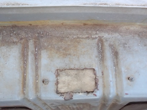

so...what's usually on the parcel shelf worth drilling out? paint label?
Re: Gimme 5 years
Posted: Mon May 04, 2020 7:26 pm
Nothing from factory. Maybe a modification? Not big enough to fit a stubby through.
