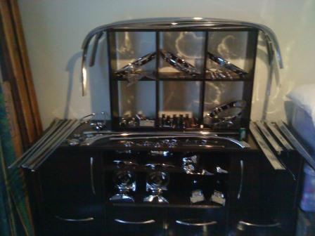

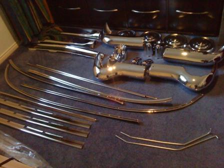

Picked up my chrome and stainless stuff this week!
mmmmmm shiny bits! 8)

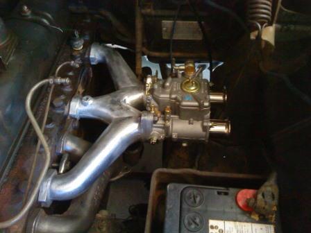

Hi all,
I did a trial fit up of the weber yesterday on the EK ute.
All looks good, just some tube bending to do for new fuel and vacuum lines and some minor tweaking of the throttle linkage.
Measured up for the air filter and there shouldn't be any clearance issues with the inner guard and frame.
All together it will be an easier fit up than I originally thought............tuning might be the biggest problem, but that will be right up my alley 8)
