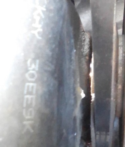

I put a new rotor button in so I had to revisit the timing --- maybe it's the multifocals, but it's a bit awkward seeing the flywheel mark, so I put one on the harmonic balancer where I can see it

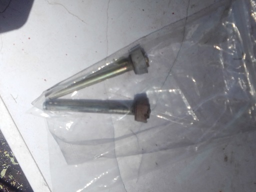

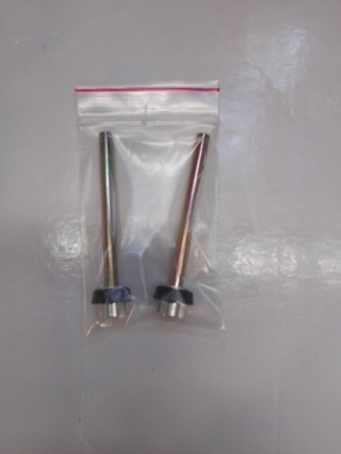

Also pulled the carby off because I wasn't happy with the accelerator pump volume. When I previously rebuilt it, I re-used an old leather plunger because I didn't like the new ones...but I don't think it was sealing properly. I haven't seen any new leather ones lately, so I'll see how one of the new ones goes (got a spare too)

Do you have another pic of the leather washer you ref to?

Hi Stephen ... here's a pic of the leather ones ... Patrick

when I put a timing mark on the harmonic balancer, I also put in a line of whiteout for 30 degrees .. bit scrappy but hopefully with the pertronix I won't need to refer to it too often

Not sure on the diameter of the washers however You should be able to make those leather washers. I have made them before for bicycle pumps and kero blow lamps. They have worked well.
