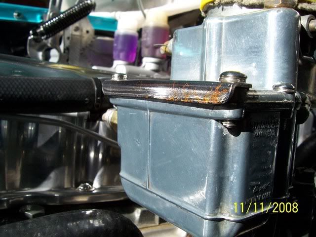

Ok - it had to happen, and I had to do it.......
You may recall I mentioned in the Glisten PC thread that POR made a cautionary note on applying it to bare steel/iron......
As some would recall, I polished and coated my carburettor by hand with this product - and was rewarded with satisfying results...... however..
The re-inforcing plate which holds down the front of the fuel chamber is made of annodised steel..... I used a buffing wheel to bring it up prior to coating it...... and must have unknowingly broken through the coating.
It has been some nine/ten months since applying the Glisten PC coating, but whilst playing around under the bonnet yesterday, was shocked to find what appeared webs of rust under the coating - yes, shocked......... obviously this is going to increase and I am a little concerned now on coating some of my chromework.......
See.... I did state at the start of my POR thread that I would pull apart and report any product which does not perform.......
Where this rust has appeared reveals no indication by feel - and at this point in time I do not know why...... I am currently of the opinion that the coating may have ceased at the edge of the plate - and moisture has "creeped up through the metal (seeped is probably a better way of putting it) resulting on what appears tributaries or "trickles" of rust....
There is absolutely no indication that the metal is oxidising, and I know that sounds a paradox.... but, by feel - it's a surface problem not a structural one..... the Glisten PC coating is doing its job - still rock hard and shining.....
So, before you rush out and jump aboard on this one ..... please consider..
Investigation will ensue and full findings posted in due course.......
pics included.....

Anyone watching this who wants an update on the Glisten problem - I've just put some pics into photobucket and will try to explain what I'm trying to illustrate......
These two pics are of the "spider rust" which POR clearly stated may occur.... it did....
My investigation thus far has been that it is most likely caused by not fully coating the piece - as you would recall, we went through some pretty ordinary weather on our trip to Yamba earlier this year - I feel the whole engine bay got an absolute drenching for two consecutive days - the weather didn't clear until we got up as far as Coff's........
This, i believe has surmounted into water getting "drawn" in by the heating and cooling of the carburettor...... in very damp and humid environment.......
The piece in question (re-enforcement bar) was only coated with Glisten PC on the outside facing edges..... not from the underlying edge.
I believe, this is where humidity was "drawn" through the metal and has tracked along the surface under the coating.
I do not believe there is any structural compromise...... this I feel is purely cosmetic - there is absolutely no evidence of the surface showing signs of breaking down or lifting away from the substrate......
This bar is coated in either zinc or anodised..... I put it to the buff to bring up the finish prior to coating it with Glisten PC..... and.... "may" have broken through the coating - I'm pretty confident this is what has happened...... the spare wheel clamp, boot-lid striking plate and all other zinc-plated components I have coated thus far are all intact and showing absolutely no sign of failure........ relax - it was me not the product...
I did NOT pre-treat this with AP 120.....
POR recommend that they be first contacted if bare steel is to be coated with Glisten PC AND that bare steel be "baked" in an over prior to coating ..... I did not do this either.
I now pre-treat with AP 120 AND use a heat gun on any metal prior to coating it with Glisten PC...
pics....
some time down the track, I will remove this and destroy the coating - I want to be sure that it will not degrade the substrate and will leave it in situ for some time........

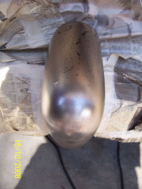

Next project.......

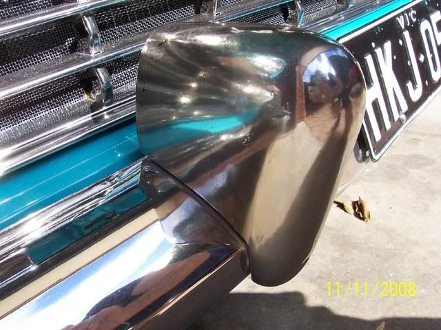

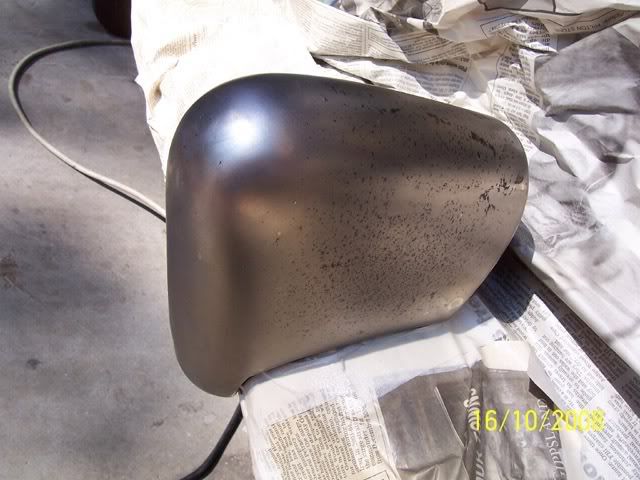

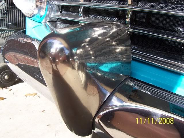

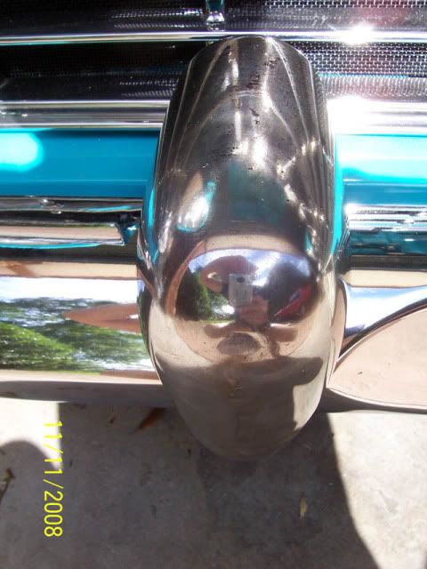

You will probably recall I intended to coat some chrome with Glisten PC... I have had a few attempts at this and so far had very good results.....but there ARE pitfalls.........
My front r/hs over-rider is shot- chrome plating almost worn away and showing signs of rusting - I rubbed it back with wet/dry and buffed it up as best as possible... by me, anyway........
The first attempt of applying Glisten PC to chrome was this piece.... most wouldn't have bothered.... but I wanted "worst possible" and decided to "sacrifice" this piece......
I did not have any strategy for applying it, didn't know mixes or pressures and just "winged" it....... results were pretty ordinary and I had problems on each of the first three attempts to coat this piece....... spotting, bubbling and runs all over the place - not to mention the blasted stuff getting under the covers over the car....... make ABSOLUTELY sure you cover anything you don't want permanently "dusted" when using this stuff.... after four (4) days, it will be rock hard and must be mechanically removed - I have now blocked down the entire upper surfaces of both my cars which were in the garage at the time - even though they were covered in nylon car covers........ I feel plastic drop sheets are the only alternative - if you cannot remove them from the area.........
Back to the story..... or novel...... the first two pics are after three coats - and having blocked them back with 120 grit dri-lube (painters paper) - good luck if you want to block down with wet/dry..... by golly this stuff goes hard.......
What I didn't realise, was that I had also broken through the bottom layer of Glisten..... it didn't show up - as it all looked uniformly "keyed"....... I had in fact "keyed" the underlying chrome (or what is left of it).......
pics...
What you see, is the dulled and ordinary state of what I wanted to dress up - strangely, I believed the lustre and depth of Glisten would bring out some restoration of the reflective qualities of chrome.........
Last pics are of the end result - and I must admit, these have not looked this good since I stopped using those products referred to as liquid emeries.........
If you look closely - you will see where I (as a kid) painted some Killrust black over the rusted areas - these are well and truly pitted and blocking down did nothing to remove them- they lay well down under the surface of the surrounding plating......
And....... there are "creatures" in this coating...... at the time of spraying, the final coat (once I'd learned the mix and pressure/gun settings) was pretty good.......but - creatures being sticky beaks (no pun intended)....... for all to see..... entombed for eternity.... watch for this at your inspection.......
just how long this coating lasts is beyond me- and whether spider rust will form over the exposed bare steel......... again, these were not treated with AP 120 nor dried using a heat gun........
pics....

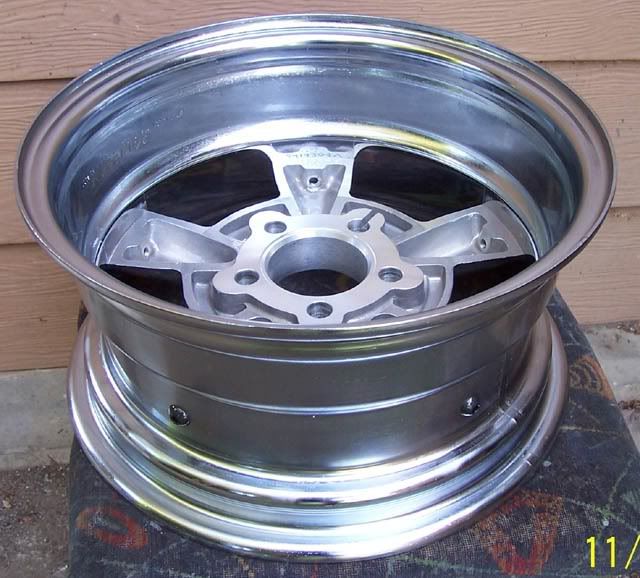

One final addition to this Glisten thread...... the dragway wheels.......
I have now finished coating the inner sides and external inner rim (where the tyre covers) with Glisten Pc.... it has had a week to cure and I feel is quite acceptable...... if you look closely at where the spoke meets the rim - you will see the chrome plating which is mirror finish.... I now feel I will coat the outer chrome rims with this but leave the outer alloy for further work..... I would like to get the alloy up a bit more.... dragway did a very good job in polishing it, but I have done better with my rocker cover and other alloy components.......
pic...
any questions happily answered.....
pics...
pics....

Dragway wheels.....
I have successfully coated the insides of all five (5) wheels and also the internal (inside the tyre) of the rims.
After many different applications on other components, I decided it timely to coat the outer chrome rims of these wheels - I do not want to coat the alloy centres yet - I feel I can get a bit more "finish" from them than as supplied from the factory......
I decided to "trial" coat one of the outer wheels and followed my developed procedure ...
I painstakingly polished, cleaned and masked the wheel and mixed up sufficientGlisten PC to do the three coats as suggested....
I recorded the temperature and humidity (as I have learned to do with all POR products - it is humidity cured, and I want to have access to application conditions should some defect present itself....... it has!).
I have had success with the first wheel - and the coating remains intact after some three weeks.
I spent an entire day off polishing, cleaning and preparing/masking the remaining four (4) wheels and mixed up a considerable amount of Glisten PC to do the job........
Armed, protected and ready to "perform" the ritual - I set about the first of the remaining wheels....... just into the job, I found beading forming on some of the rim but continued - as I did with the remaining three (3) wheels......
I double coated these areas on subsequent coats and managed to "fill" some of these "issues"...... until all were coated with three (3) generous coats of "permanency".......... and left to cure..
You may recall that I hand polished my intake manifold (HR) and decided to coat it in GPC....
During the first coat I found two small sections which "beaded" on application.
Subsequent coats seemed to "resolve" this beading - and I decided to leave it for a number of weeks and "polish" them out with a cutting compound......
After coating the remaining four (4) wheels - the opportunity arose to attack the intake manifold and I set to it with some 2K cutting compound and hard rubber backing blocks...(as used on the front over-rider).....
To my disgust - a small section "flaked" off revealing the highly polished alloy underneath.... I prodded and probed many other areas only to find similar "failures".....
