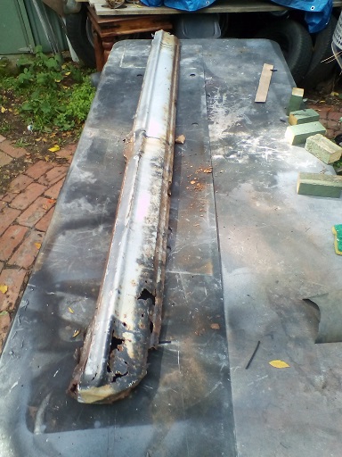

I took the driver's side outer sill off (it's the better of the two).
old sill.jpg (148.03 KiB) Viewed 1195 times

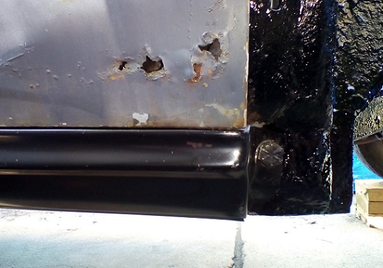

I did a trial fit of the new outer sill. The sill isn't a perfect reproduction, but it's not bad.
A couple of tek screws and it was on - but I thought I better listen to Clay and hang a door. It took a bit of trimming, bending and elongating of the hole for the sub-frame bolt get it to sit low enough at the front.
I'm happy enough now that after I tidy up all the 'ugly' behind it, I'll be able to put it straight on.
sill test.jpg (131.94 KiB) Viewed 1164 times

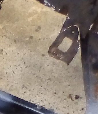

I put in the driver's side floor
...the repair panel comes with a cutout for around the accelerator mount
...which assumes that isn't rusted out
...so patched one in - made it double thickness...(also read FJW's accelerator thread so tacked up the other side of the pedal shaft)
...then I cut away those pesky wires that run to the back of the car (looks like they've been rubbing and been patched many times)

Errol62 wrote: Mon Apr 13, 2020 6:45 pm Repairing and attaching the bottom of the panel rear of the B-pillar is tricky. Haven’t worked out how to do that one yet.
Yep Clay, I don't know about the panel van but in the ute it's nearly impossible to get to from behind. I went with Sikaflex for the edge where it meets the sill.
I've grown to trust Sikaflex - I used it to attach brackets for a solar panel to the roof of the campervan...it's been subjected to highway speeds for about 10,000 kms now.
Not sure about trusting it on a painted surface though, unless you know how well the paint is bonded to the surface.

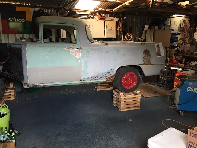

Decided to have a break from being underneath the car and started stitching in some new metal on the driver's side...pic of 'round one' attached
drivers side 1.jpg (59.71 KiB) Viewed 1047 times
drivers side 2.jpg (109.88 KiB) Viewed 1047 times

Wow. Did you get the lower quarter patch from Retro Spares at Eltham?
Re: Gimme 5 years
Posted: Fri Apr 24, 2020 12:08 pm
by 62ekute
Yep, Retro Spares...about $80 each side...needed some manipulation to fit, but still easier than starting from scratch.

I see you have raised the ute to work on.
So much easier than laying on the ground.
