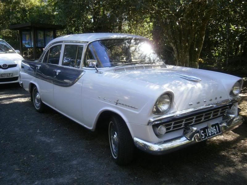

Post by strogger »
Some more recent pics.
Engine bedded in quite nicely, has had first oil change since rebuild and everything has settled.
Electronic ingition conversion - cant tell from outside of dissy.
Rebuilt carby - best money I spent, Man the difference in power / economy, has brought whole engine package together.
Arm rest - comfort and looks :D
Scratch plates make a big difference and tie the package together. :wink:
Dont forget me.!!!! :lol:
Anthony..
FB/EK Car Club of QLD
www.qldfbekholden.com
