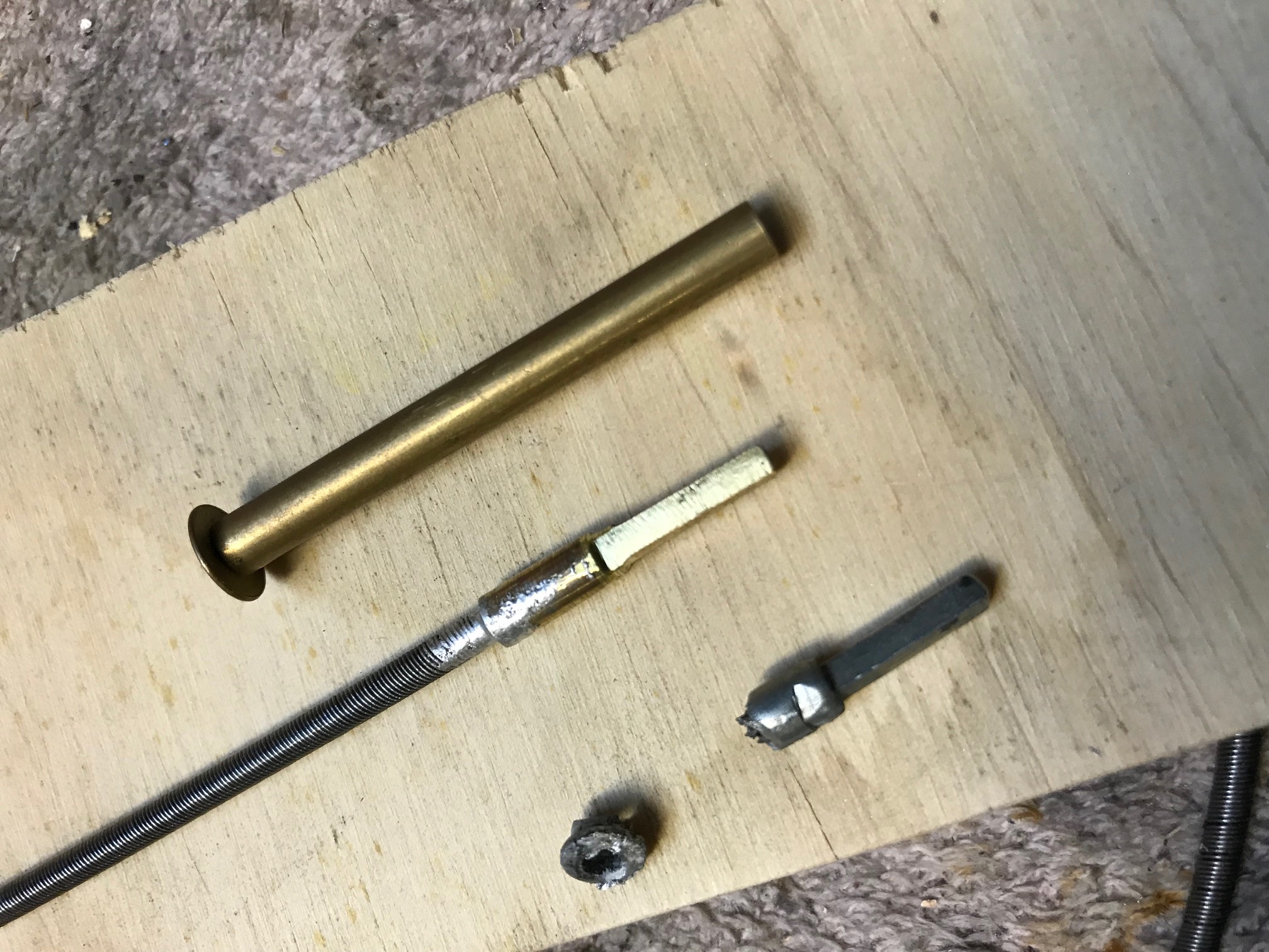

Hey Folks,
On the clubs two day run a couple months ago the speedo gave up. When I got home I had a bit of a look and the inner cable had busted. Tracked down a replacement inner for the sum of $3.00.
Fitted that in and took it for a spin around the block, but the speedo was all over the place. Before I got home it gave up again.
Pulled the cable again and discovered a rather twisted mess of inner cable as well as it broken at the speedo end. Time for a closer look. I noticed the speedo cable had a rather tight radius where it entered the firewall behind the master cylinder. When I attempted to spin the speedo head with my fingers I couldn't move it! Time to get another inner cable and pull the speedo out.
The speedo drive was very tight, so I dismantled the speedo following Harv's thread http://www.fbekholden.com/forum/viewtop ... lit=Speedo, but noticed my speedo was slightly different. With a little bit of fine oil and a clean it was all good and ready to go.
Made up another cable and thought I will crimp the end on with my pliers. Unfortunately I busted it off. So I ended up making a square drive out of brass and soldering it onto the cable. Refitted the cable passing it in front of the master cylinder and now have a working speedo again.
Posted: Tue Jun 18, 2019 8:01 am
Great result Stephen. There are two different speedo heads. One labeled just Holden, the other VDO.
Your inner cable solution is excellent mate. I’ve got a box of speedos if you need one.
