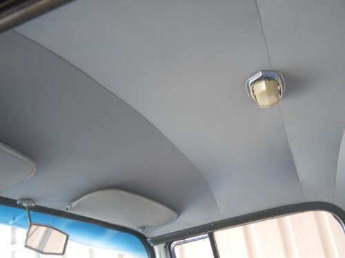

I think the upholstery is original, but in need of some TLC.SunnyTim wrote:nice ute looks to be quite original still. Is it still original upholstery?

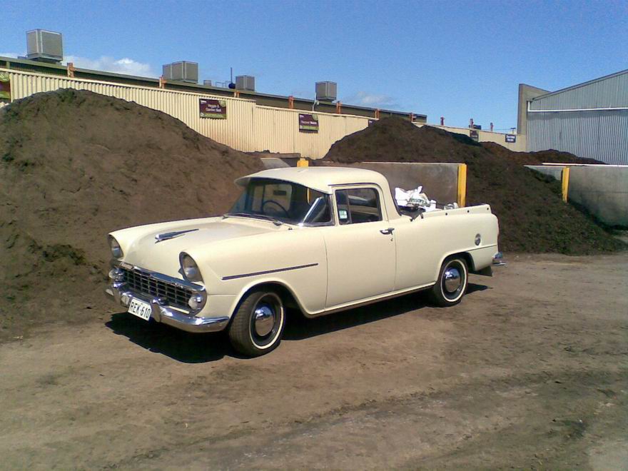

- Put the ute to work picking up some soil

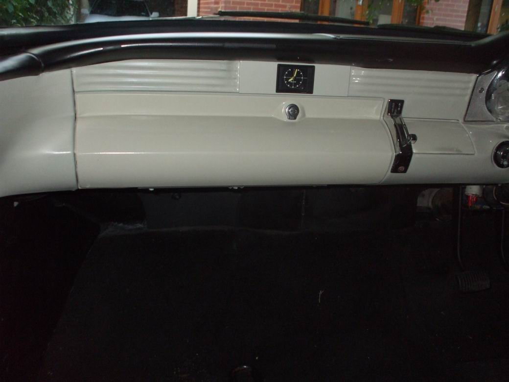

Done a bit to the wheels including fixing an oil leak on the fuel pump and getting a wheel alignment. It handles much better now. I have also fitted a VDO clock. Unfortunately not the original accessory but a clock out of a VB / VC Dunny Door. I scrounged a piece of aluminium for the face plate and managed to squeeze it in where the radio goes. For $20 it works well and keeps good time.
Mr J, appreciate the confirmation on the paint colour.

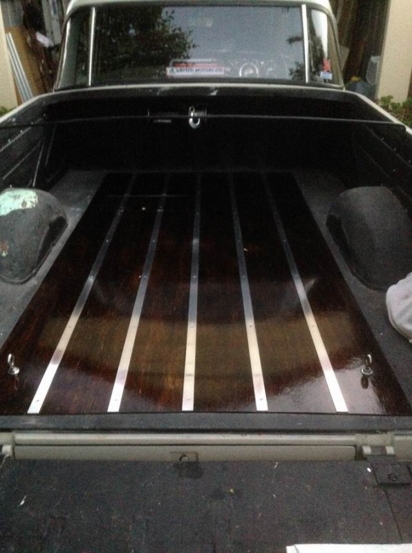

Hi All
Been a while since the last post but have done a bit of work, put a new floor in the ute. I used 15 mm ply but as the floor set down in the ute is only 12 mm the underside had to be skimmed around the perimeter with a router. That enabled the floor to sit flush with the body floor. I have secured the floor into the ute using rivet nuts then installed polished aluminium cargo strips over the floor screws so they are concealed. The timber has been stained then had 5 coats of clear floor finish.
As there is a heap of wasted space under the floor we cut a trap door in the timber floor. A recycled stainless steel hinge was used off an old chip fryer! I have wired up a LED strip light under the floor operated by a door switch so I can find what I am looking for. All secured with a lock.
I have also installed some recycled stainless steel eye bolts in the floor to secure my bike. To get the bike in the ute I have fitted a 12 volt winch under the parcel shelf with a remote control. This makes it easy to pull the bike up into the ute.

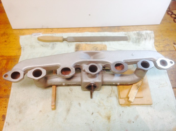

To keep the ute on club rego I had to remove extractors as they aren't original which is fair enough. So pulled extractors, found a manifold in the spare parts dept and soaked that in a molasses bath for couple weeks. Whilst I had the spanners out I decided to fix an oil leak on the harmonic balance. So pulled the cover and balance and noted the balance had a grove in it. At this point decided to put a new timing gear on it and harmonic balance.
Cleaned up the manifold, painted it and fitted it up with a new gasket. Off to the exhaust shop to fit a new engine pipe, muffler & tail pipe. All good except it sounded like a truck! Had a closer look and it was leaking between manifold and head.
Pulled the manifold for a closer look. With a straight edge I had a 35 thou gap on the ex port for cylinder 2/3 & 4/5. I was going to take it in and have the manifold machined but thought I would have a go myself. I used a large rasp, steel ruler and feeler gauges to file the other ports down to close the gap. I set the manifold up against a white board with light to assist in guiding my progress. When close I glued some 120 grit paper on a board and then lapped the manifold on the emery paper. The end result was I got the gap down to 5 thou.
Reassembled the manifold up with a new gasket and it runs nice and quiet. A good outcome and saved myself a few bucks.
