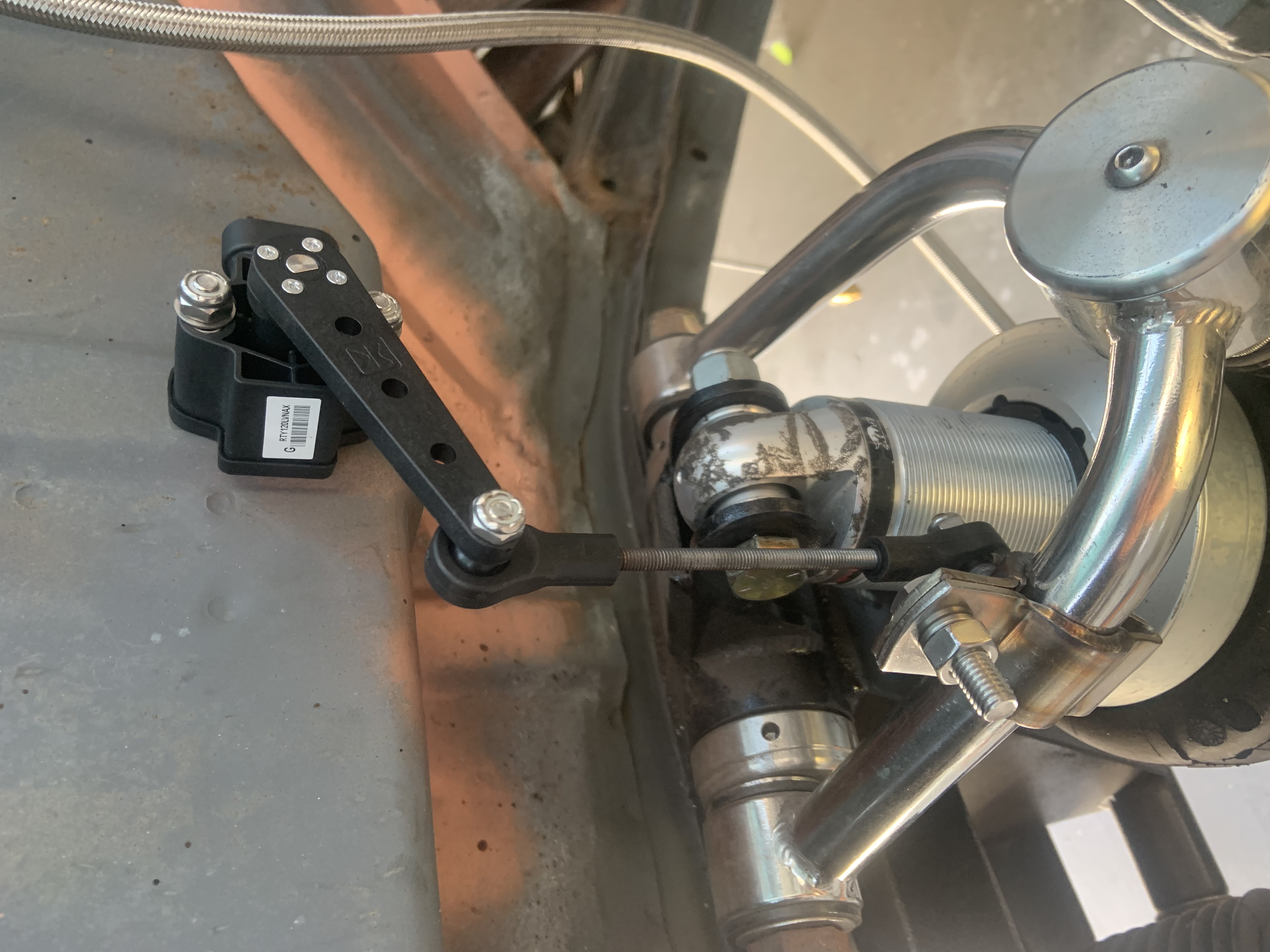

Rear height sensor dummy mounted using modified pipe clamps as the mounting brackets. Get these squared of tomorrow and then tackle the front ones.

All height sensors mounted, pictures shown on full droop. And yes more wiring gone in. Even pinched the hand brake switch from the statesman donor car 🤣🤣
Negative was spending 2 hours looking for the polished stainless steering shaft uni joints. I think I may had thrown them out 😢.
