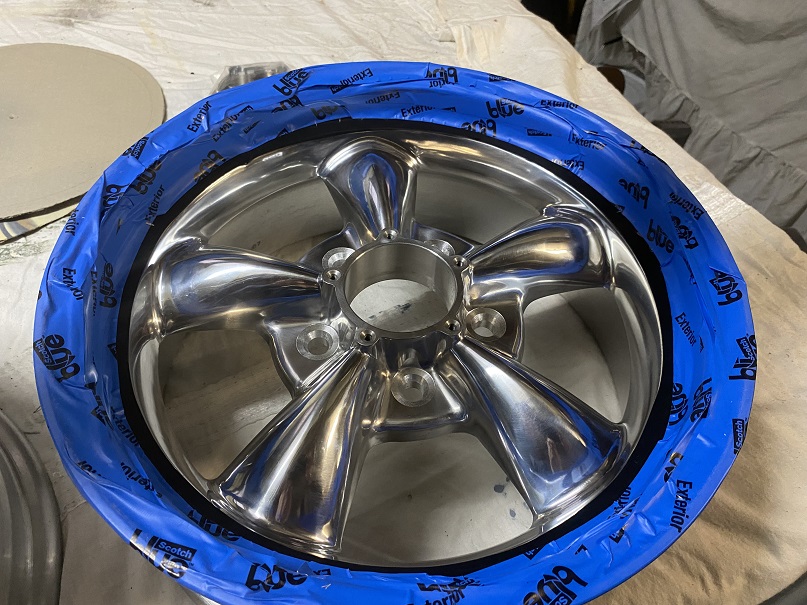

These bloody wheels are giving me the s%#t.
Powder coaters have limited colours and me crash repair painter told me cost would very high as the wheels will need to be scruffed / hand sanded.
So what to do.
Do it your self I hear. :lol: :lol:
Lots of research on the internet with most doing 2K. I will probably use enamel for ease of use and I can do it in the shed.
to be painted.JPG (205.47 KiB) Viewed 7856 times
taped (1).JPG (223.41 KiB) Viewed 7856 times

It was so strange rubbing off the shiny surface when most times we are doing the opposite to get shine.
All done with old 320 grit and I think my fingers are a little shorter now. :lol: :lol:

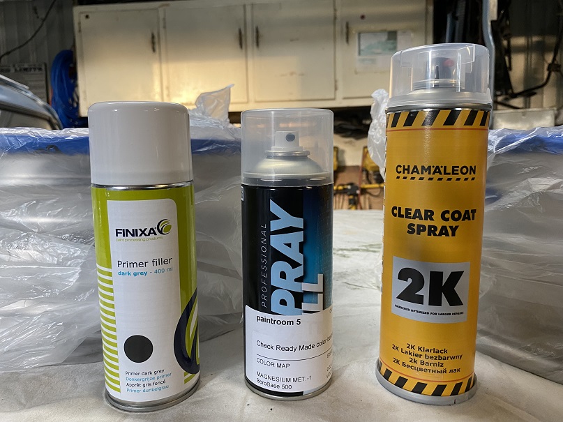

Chased around looking for VHT wheel paint without any luck but I was direct to a company, Paint Tech in Windsor Gardens.
These guys could not help me enough. Searched through several colour catalogue until we found a match.
There is 10 different colours in the mix, which is surprising for a dark grey.
I have 3 cans of 2K colour, a can of primer amd a can of clear.
Just need a warm day now.

A warm day and a charcoal mask, the paint will cure inside your lungs and never be expelled, be carefull.
Prime let dry then smooth with a scuff pad, apply your colour till it flashes off then apply the clear. This is what i have been taught to do.

I changed the filters in the mask first up.
Followed the advise from the paint shop and now I have 2 front wheels that match the rears.
