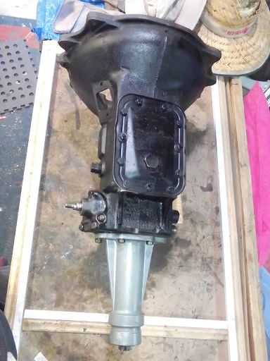

Finished putting the gearbox together today - clutch kit is in the couriers truck so should turn up next week
gearbox 17.jpg (86.67 KiB) Viewed 786 times
Patrick

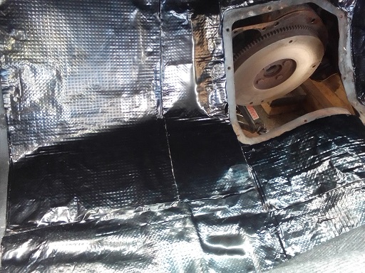

I had some left over sound deadener, so while the carpet was pulled back, I doubled up on the front bits
sound deadener 2.jpg (120.58 KiB) Viewed 757 times

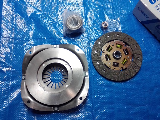

I ordered the clutch kit from Automotive Superstore because they came up a fair bit cheaper (and I had a voucher from them as well)
...it turned up today in a sealed Exedy box with all the bits
clutch 2.jpg (126.52 KiB) Viewed 729 times
clutch 4.jpg (60.27 KiB) Viewed 729 times

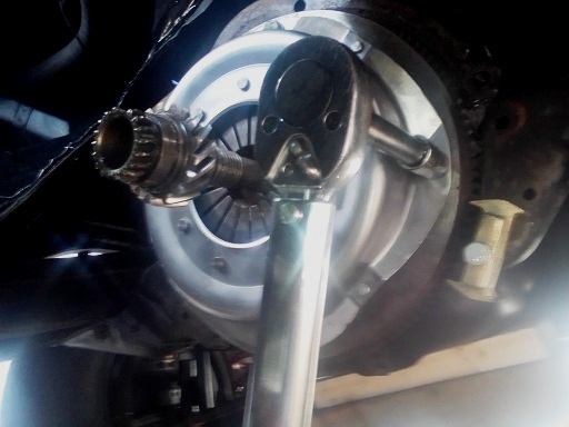

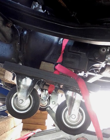

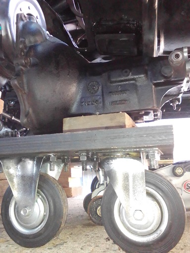

I wheeled the gearbox back under the ute today
gearbox 19.jpg (83.18 KiB) Viewed 701 times
and jacked it up to the engine
gearbox 20.jpg (73.69 KiB) Viewed 701 times
before I lifted the engine and gearbox up all the way, I put the driveshaft in and poured about 180ml of SAE90 into the rear extension via the speedo gear hole
gearbox 21.jpg (66.23 KiB) Viewed 701 times
Patrick
Re: Gimme 5 years
Posted: Tue Mar 30, 2021 7:20 pm
by Brett027
That's a handy set up😀
Re: Gimme 5 years
Posted: Tue Mar 30, 2021 7:36 pm
by 62ekute
Brett027 wrote: Tue Mar 30, 2021 7:20 pm That's a handy set up😀
Hi Brett,
yeah, I actually put blocks under the wheels as well to stop things tipping sideways - not too bad with a 27kg gearbox - more useful with a 150kg VW engine.
Patrick

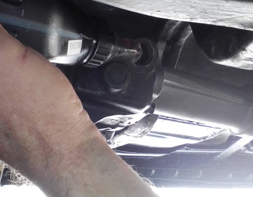

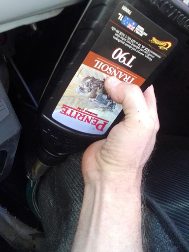

I put the oil in the gearbox today
gearbox 23.jpg (72.15 KiB) Viewed 660 times
And connected up all the fiddly bits
gearbox 24.jpg (64.21 KiB) Viewed 660 times

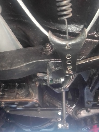

Hi Patrick , what's that steel bolted to the gearbox bottom plate? Part of clutch mechanism?
Re: Gimme 5 years
Posted: Fri Apr 02, 2021 1:52 pm
by gpi
this is a hotrod so he has a floor shifter
