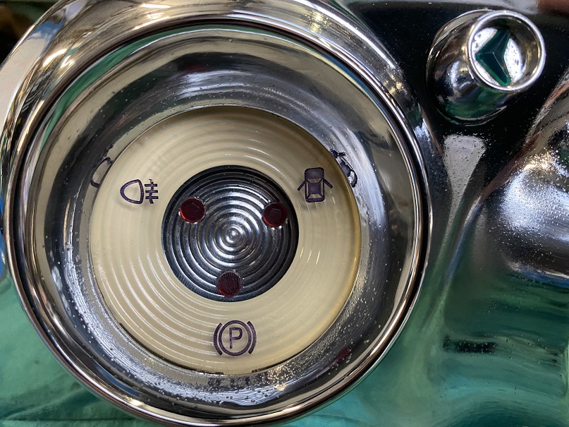

I have managed to wire the gauge cluster with a couple of multi pin plugs - thanks Brett for sharing your setup.
A word of warning to anyone who is thinking of changes to your gauge.
Firstly Holden made all of tabs just long enough to the job they intended.
The acyclic I used is 3 mm for the modern engraved symbols and the orginal is 2.6 mm. Not much but enough to cause issues.
upgrade 2.JPG (242.33 KiB) Viewed 2171 times
upgrade 1.JPG (218.35 KiB) Viewed 2171 times
Another problem I caused was not drying the spood face completely so I have a couple of water bubbles in the grooves.
Note to O in Holden.

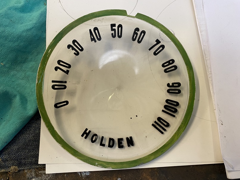

Any suggestion on how to mark the dashes on the speedo ?
need to mark.JPG (161.35 KiB) Viewed 2171 times
Posts: 14281
Re: Ammo's Ute
If you have another speedo to pull to bits I would take it to somewhere that does laser engraving and see what they can do with it ?
Dont know if the picture would be sufficient ?
Posts: 5743
Re: Ammo's Ute
Wrongway Roger wrote: Wed Feb 28, 2024 6:12 pm Any suggestion on how to mark the dashes on the speedo ?
Small lengths of adhesive tape, cut to length with a sharp knife/scissors, then stuck onto the ivory background. Pick a thin tape so you only have to cut to length, and a quality one so it does not peel.
http://b2b.rollsliner.com.au/listwcs018 ... -tape.html
If you are playing with the signwriters, think about buying some plastic razor blades at the same time. They come in a couple of grades of hardness - some for scraping stuff off hard things like chrome, softer ones for scraping off plastic or paint. They are mighty handy.

Wrongway Roger
Posts: 763
Re: Ammo's Ute
Post by Wrongway Roger »
Thanks for all of the suggestions. I decide to go with 3mm and 2mm black vinyl tape from Office Works.
