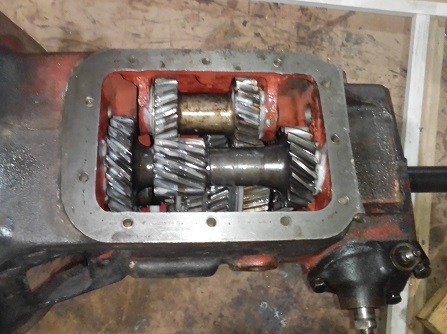

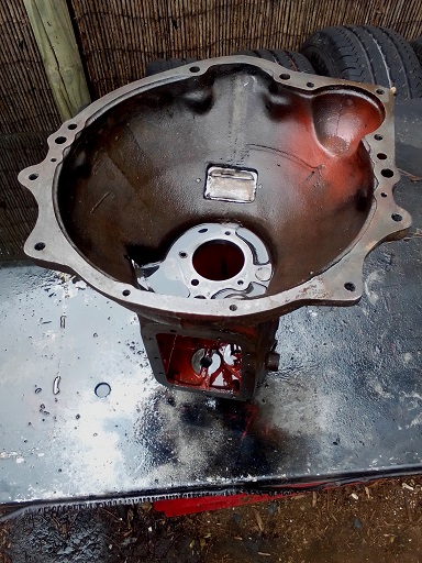

got a spare gearbox - just not sure which one it will be yet
gearbox 7.jpg (96.57 KiB) Viewed 1090 times
Patrick

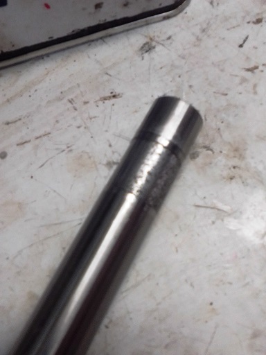

found another noisy bit from the ute gearbox (gbox a) - counter gear shaft is a bit rough

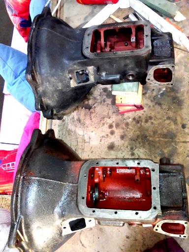

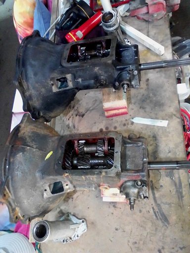

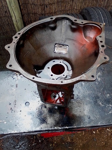

still have to pull apart the other gearbox (gbox b) - but I can already see why it was decommissioned
gbox b 1.jpg (45.84 KiB) Viewed 1063 times

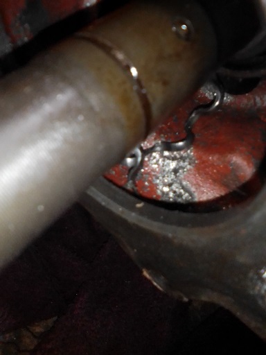

If the rear main bearing's outer race has spun in the gearbox case, it may be "challenging" to find the ends of the bearing retaining clip, because it will have spun along with the outer race.
Re: Gimme 5 years
Posted: Sat Mar 20, 2021 3:57 pm
by 62ekute
ardiesse wrote: Sat Mar 20, 2021 2:50 pm If the rear main bearing's outer race has spun in the gearbox case, it may be "challenging" to find the ends of the bearing retaining clip, because it will have spun along with the outer race.

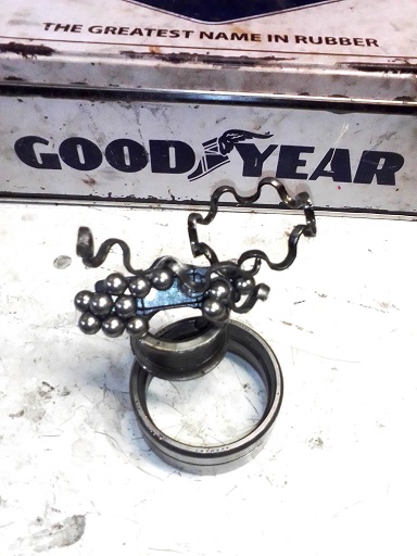

Hi Rob - yeah, luckily just the rear cage of the double bearing gave way ... but as I disassembled the gearbox and pushed the shaft forward the other lot fell out so I had the outer race tight in the box and the inner race tight on the main shaft.
taking the outer race out went as per normal (with the original style snap ring with the tag on it)
... for the inner race I had to hold the gears in place with rags and wooden wedges so I could tap the shaft through
Patrick

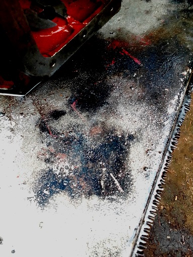

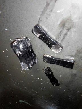

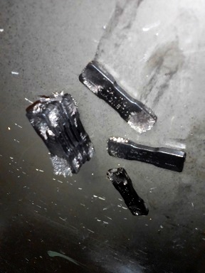

I emptied out gbox b today - there's enough good bits between the two of them to put one together without buying a kit (that's how it would have gone with my first couple of cars forty something years ago) - but I've ordered the double row bearing kit for this one
it took a fair bit of flushing to get rid of all the glitter - and then I went through with a magnet - took half a dozen passes until it came out clean
the front race of the bearing was still holding the shaft in place and the glitter appears to have been contained in the speedo drive area (though I'm sure it travelled a bit with the oil) - speedo drive lost a tooth - everything else checks out good ... I'd say it wasn't driven after it squealed

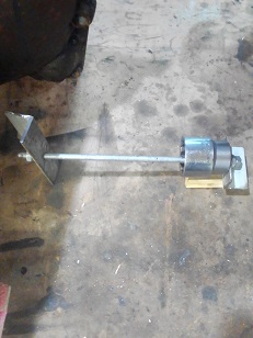

some rough tools

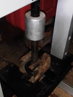

I thought that while I'm waiting for the gearbox kit to turn up, I may as well get some bits ready. I started by pressing the bearing off the clutch gear (it wasn't coming off with light tapping). I'll probably be using the press and a bit of pipe to press the new one on as well.
t clutch gear bearing.jpg (28.72 KiB) Viewed 989 times
that got me thinking about the main shaft rear bearing - which I'd prefer to press in rather than tap in (I didn't mind tapping the old one out because it was going in the bin anyway) - so I got a couple of bits together ready for that
t rear bearing 1.jpg (31.75 KiB) Viewed 989 times

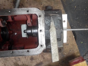

when I was pulling the bearings out of the cases, I changed the profile of my snap ring wedge a few times from the one I'd seen pictures of, until I was reasonably happy with it (by pushing the tool in from underneath I could see where it was making contact - I also chamfered the edges)
t rear bearing 2.jpg (36.65 KiB) Viewed 989 times

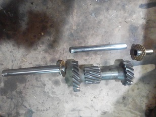

a few more bits to pull the main shaft through
t main shaft.jpg (29.96 KiB) Viewed 989 times
and some bits of 16mm chrome curtain rod (painted ones leave paint behind) to load the counter gear rollers and hold the rear thrust washer ... my plan is to leave the rod in place and push it through with the new counter gear shaft
t counter gear.jpg (33.69 KiB) Viewed 989 times

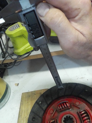

I should have finished the outside jobs before this rain set in. I wanted to put in an order so went out to remove the clutch and check it out - at least you don't get rained on once you are under the ute
supposedly you can let them go to 0.3mm (12 thou) off the rivets but at 0.64mm I can't see the point in putting this back in and have ordered a new kit ... I'll stick with 200mm

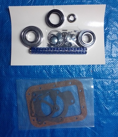

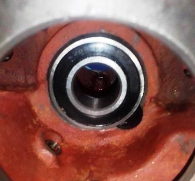

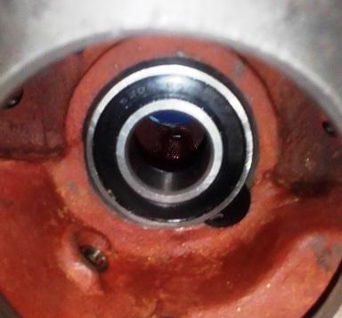

the gearbox rebuild kit turned up today, just before bourbon o'clock, so I only had time to press the rear bearing in
gearbox 11.jpg (81.7 KiB) Viewed 906 times
gearbox 12.jpg (26.09 KiB) Viewed 906 times

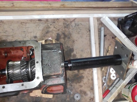

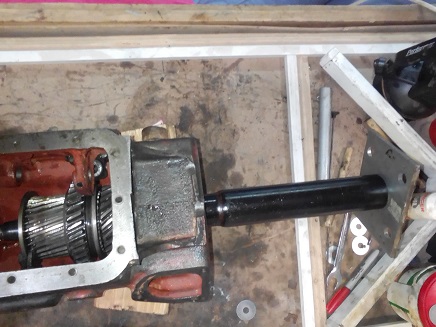

I decided to pull the mainshaft through the rear bearing today
gearbox 13.jpg (68.25 KiB) Viewed 885 times
It was all going well so I kept going until all the gears were in
Patrick
