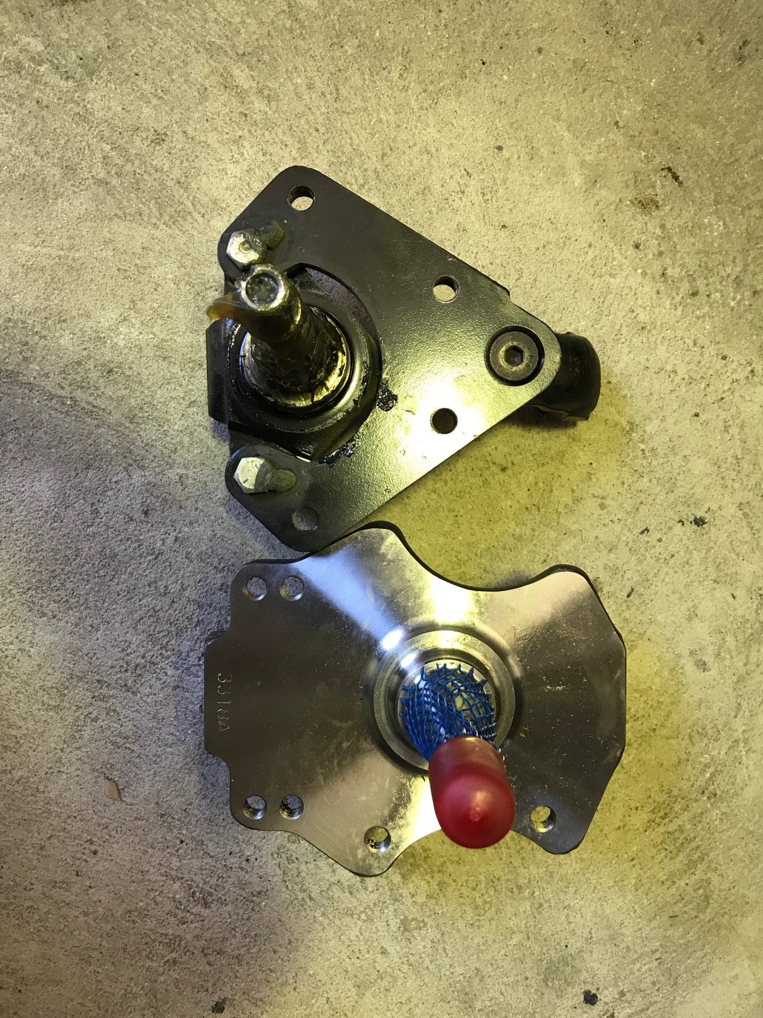

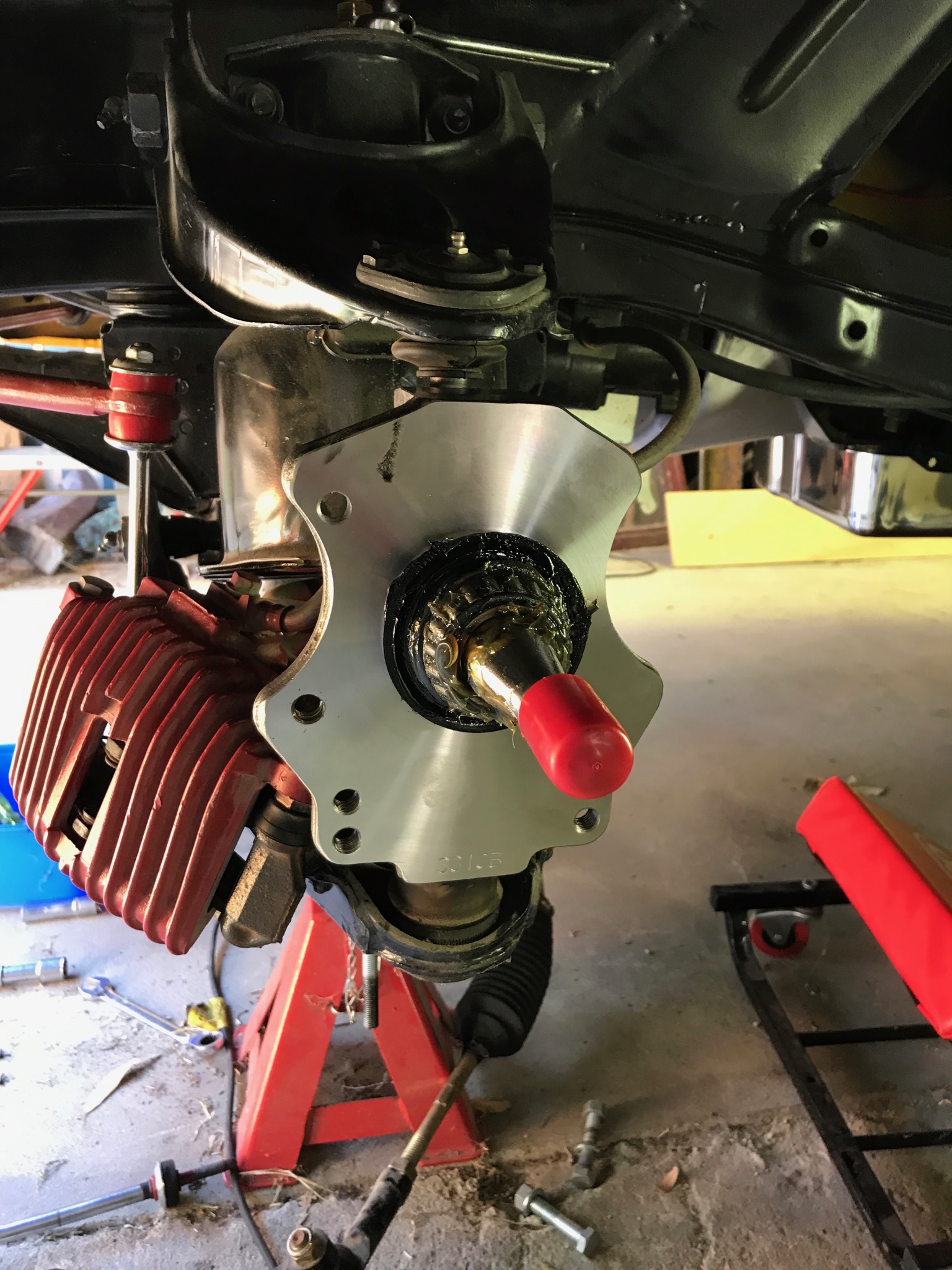

I got the drop spindles on yesterday, didn't want to have to fight with the springs so made up something to keep the springs in while I changed the stubs. Simple but effective
I had HR drum brake stubs with adapter plates for the VP brakes so side by side you can see the difference in position of the axle. Stub axle on And of course there is never a job that gets done where you don't have to modify something, had to take a small amount off the caliper to get it to sit flush against the stub axle plate. All done So after that went back to my wiring a finished connecting up the blinkers, they're now working front and back side to side and actually flashing

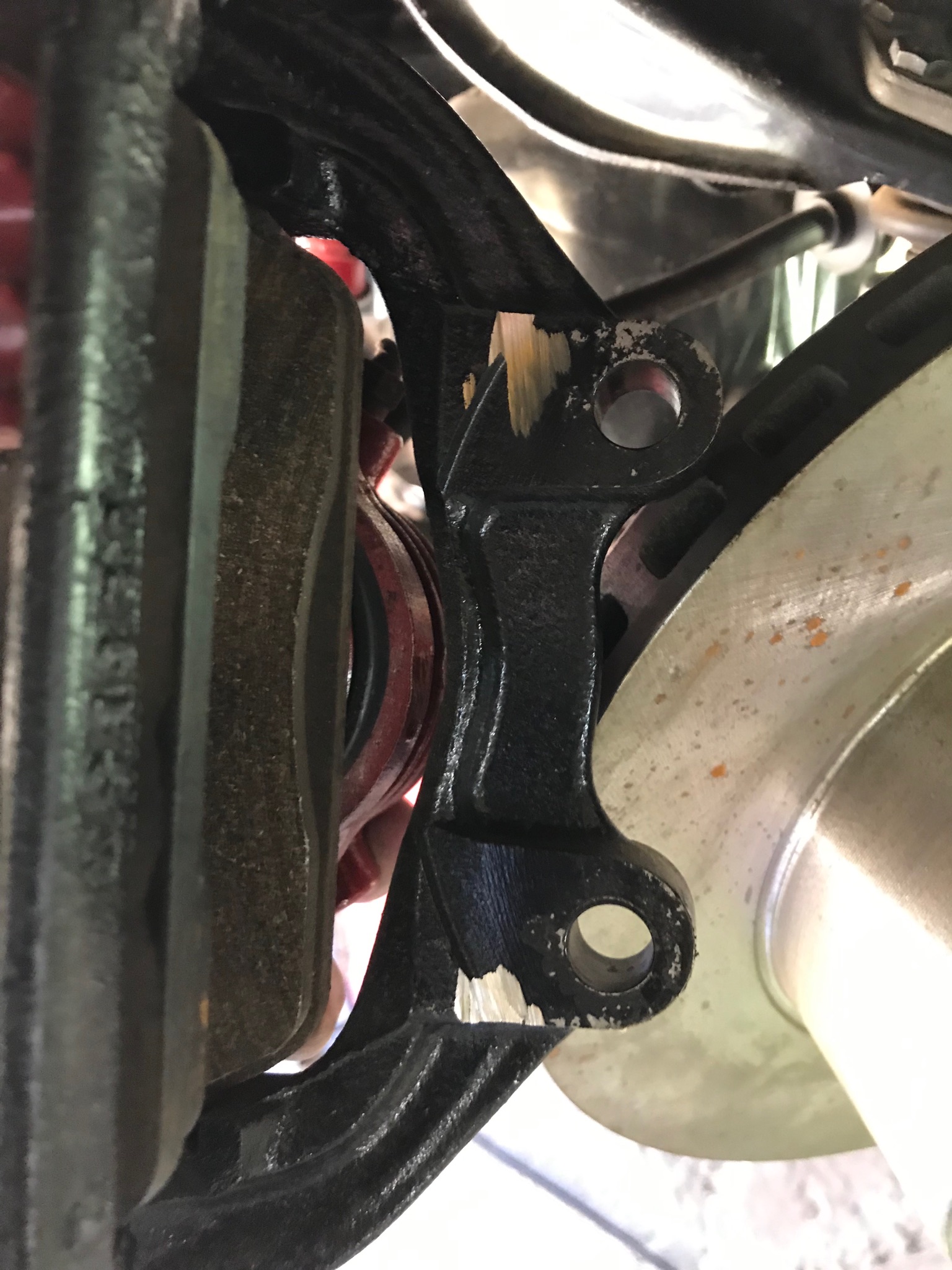

It might be the angle of the photo but are your callipers on all the way ?
It looks as if they still need to go in toward the stub.

Good stuff indeed. No issues with rim clearance to the top ball joint. Wonder how the bottom clears Neil.

I agree with EK283 caliper doesn't look right, the outer rim of the disc should follow round to the curved ridge in the caliper, my guess in the earlier conversion they may have machined down the disc. I attached the link to download the dba catalog to give you the diameter of the disc, which I think should be 279mm. I have VS commodore which I looked at before posting this as guide and cant see it being just the photo.

Hi Guys thanks for the comments on the brakes and after doing a little research I am pretty sure you are right.
Apparently Holden made a 270mm rotor for commodores that had 14" rims and on the calais etc they made a 290mm rotor I also contacted CRS and sent them the photo so waiting to hear what they say.
I will check it out tonight when I get home but it adds up when you look at it. At least it wont hurt the pocket too muc around the $100 for the larger rotors.
