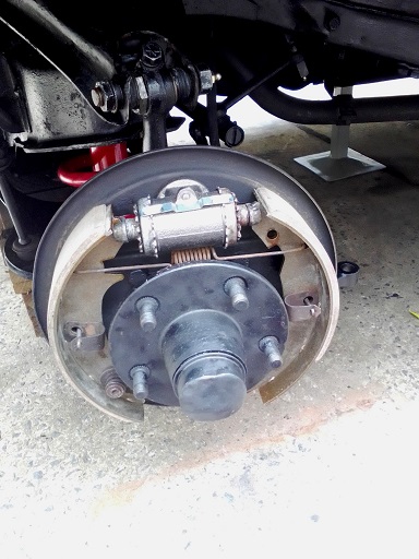

I put the wheel cylinders and brake shoes on

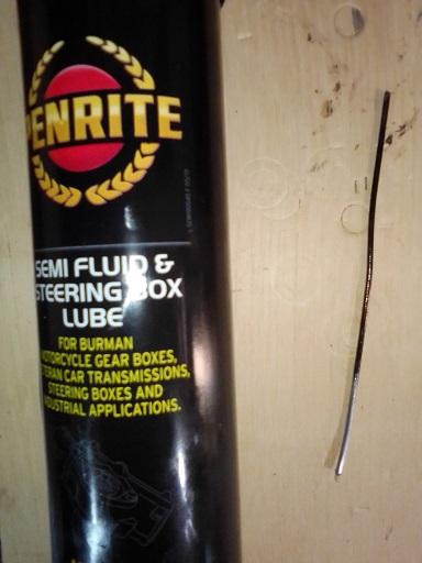

then thought I should re-grease the steering box so I got some semi fluid grease and a dipstick...though I think with grease a dipstick isn't much use until the grease has self levelled (which isn't quick)

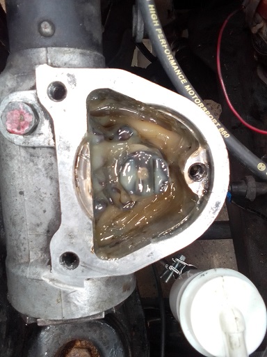

I took the top off the steering box, cleaned out as much of the old grease as I could get to and put some new grease in (and helped it along a bit with it's levelling)

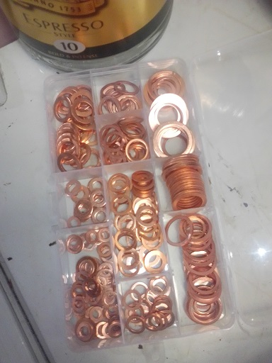

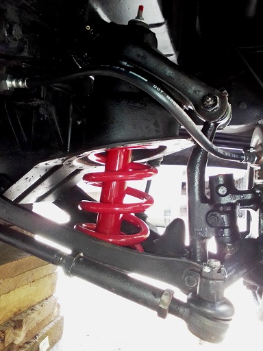

while I was waiting for the grease to self level I thought I may as well put the flexible front brake lines in...you'd think that either the hose supplier or the wheel cylinder supplier would provide a copper washer. I noticed this a while back so another eBay purchase took care of that (280 for $18).

I put the hoses and tie-rod ends on and went back to check the grease (I helped it along a bit more with it's levelling)
brakes 9.jpg (82.59 KiB) Viewed 808 times

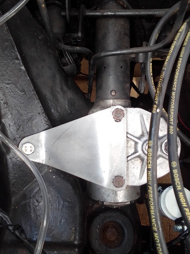

bled the brakes, decided the grease was right, checked the clearance between the adjuster screw and t slot and put the top back on the steering box...I decided not to put a hole in the brace for the filler because it's pretty close to the top mount and it would lose some strength - (anyway, by rights after I re-check it tomorrow, it's packed for life, if I check the level it will be through the bottom bolt hole and if I add grease I'll take the top off)

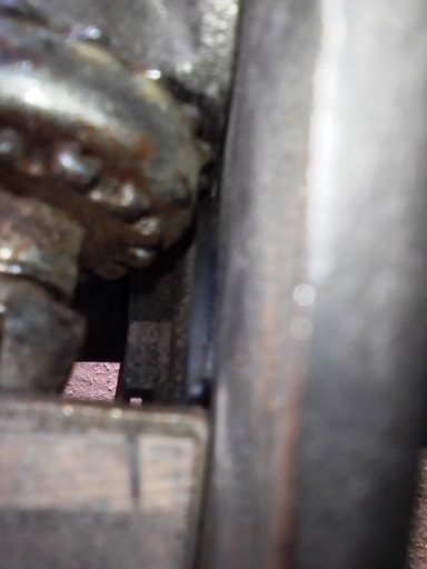

trimmed down the brake adjuster hole plugs for the front wheels - by the way - there's even less room in between the front brake adjuster and backing plate - easy to see how brakes can get stuffed by the aftermarket part in standard form

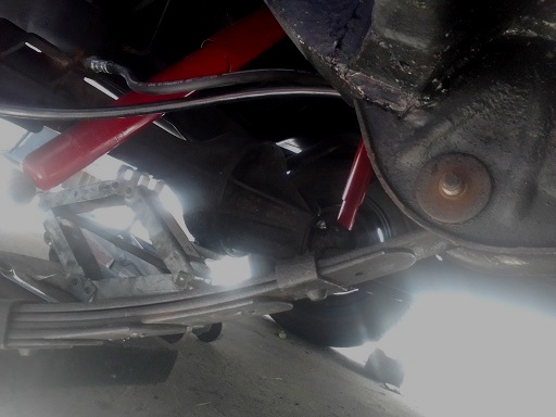

I replaced the shackle rubbers and spring pads on the driver's side today. I'd read a few posts about BFHs etc so over the weekend I sprayed penetrating oil on everything a few times (replacing the rubber so didn't worry about it deteriorating from penetrating oil).
It went well - I think when you are doing all of them it makes a difference because you can set it up so there isn't any tension on the joints.

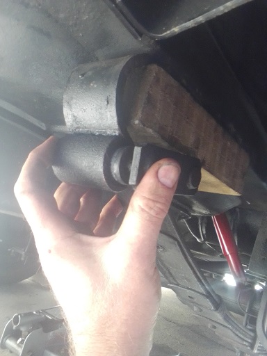

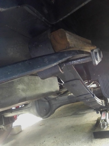

As per the workshop manual, I put in a block of wood and adjusted the jack until I found the spot with no tension so I could pry out the rear shackle (some light pitting but not too bad)
rear suspension 4.jpg (59.78 KiB) Viewed 739 times

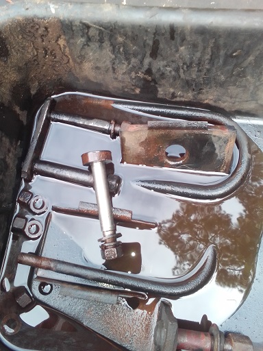

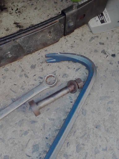

I undid the u bolts and rested the spring on the ground so there wasn't any tension on the front pin - gave it a tap and then stuck a small crowbar under the head and slid it out

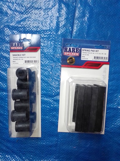

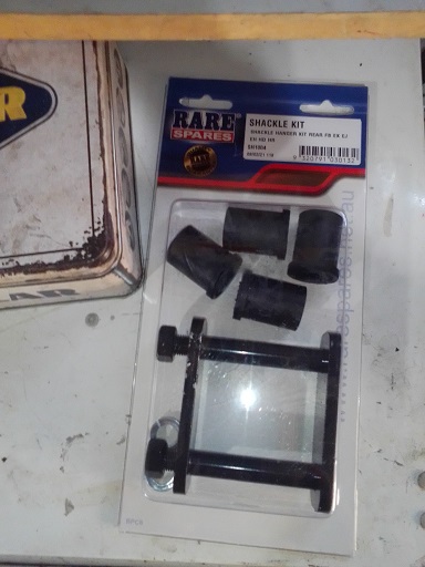

I hadn't bought the bits yet because I didn't know how much would have to be replaced ... all the hardware looked good so I only needed to buy new rubber
rear suspension 6.jpg (96.41 KiB) Viewed 739 times

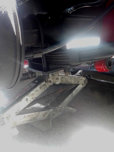

jacked the middle into place and did up the u bolts
rear suspension 8.jpg (55.19 KiB) Viewed 739 times
put the block of wood back in and adjusted the jack until the rear shackle could be pushed in (bit of silicone spray)

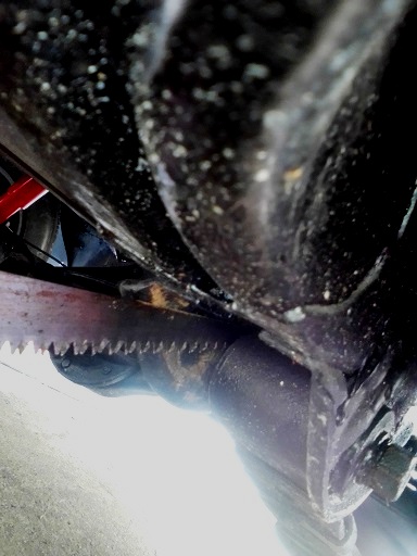

thanks Clay - yeah, maybe the penetrating oil helped - I actually got a gyprock saw and cut the rubber back down to bolt before soaking it in the stuff)

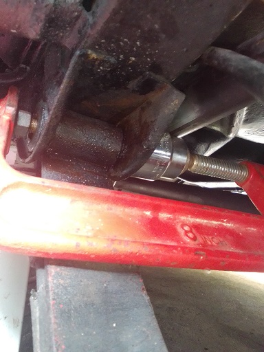

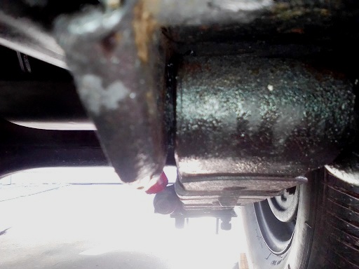

The front pin put up a bit more of a fight - I didn't want to hit it too hard so I pressed it out (g clamp with a socket and a bit of pipe on the handle for leverage).
rear suspension 10.jpg (75.37 KiB) Viewed 706 times
The pin looks good - it was just caught on the head
rear suspension 11.jpg (97.81 KiB) Viewed 706 times

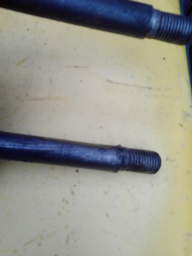

One of the rear pins was a bit worn
