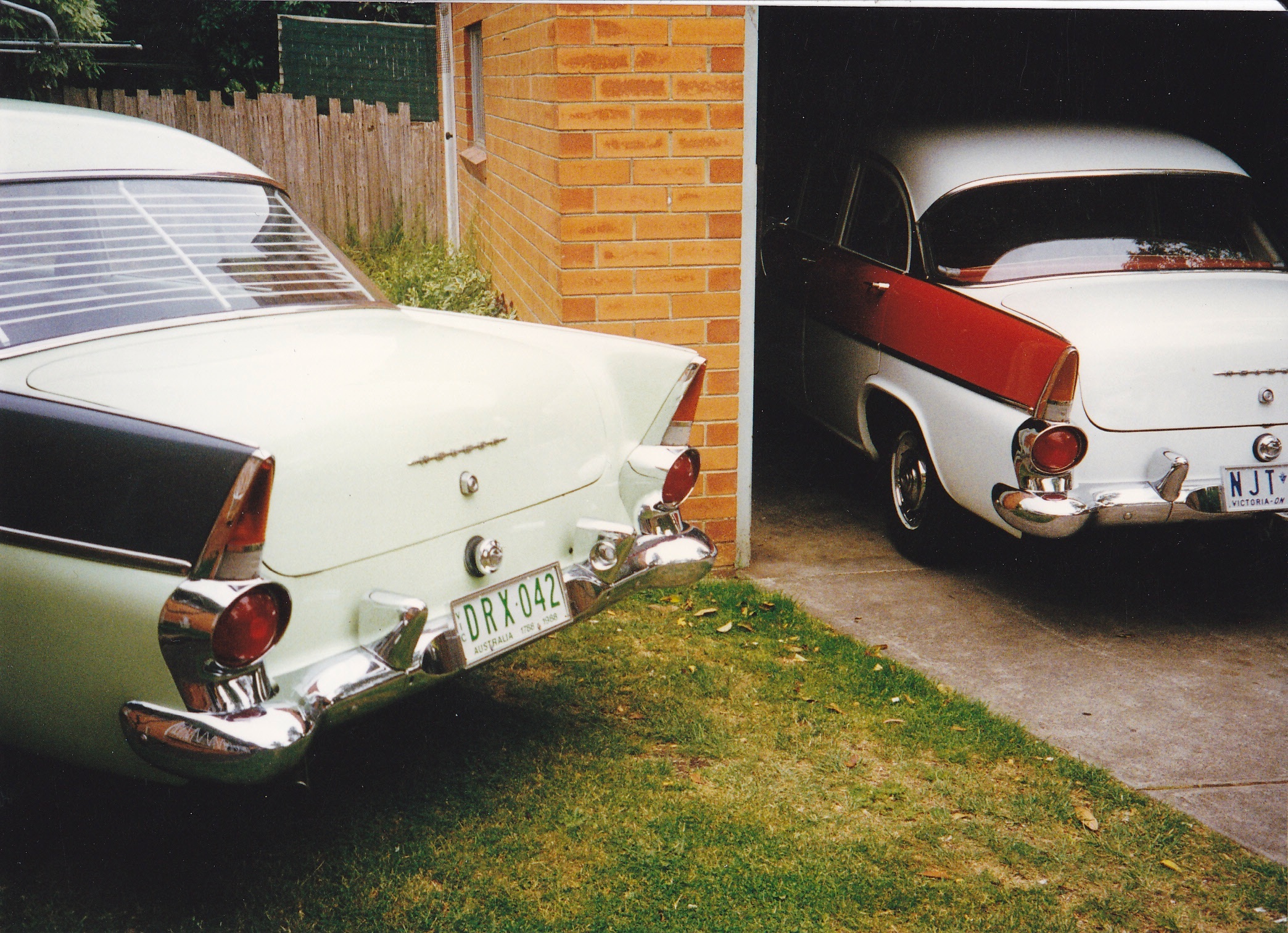

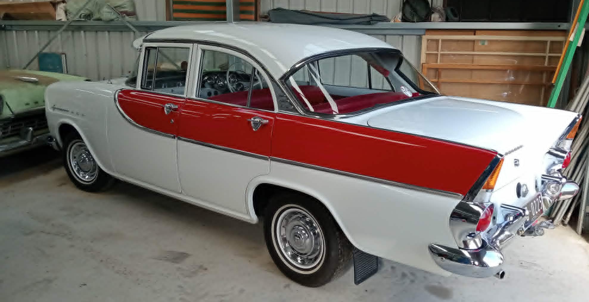

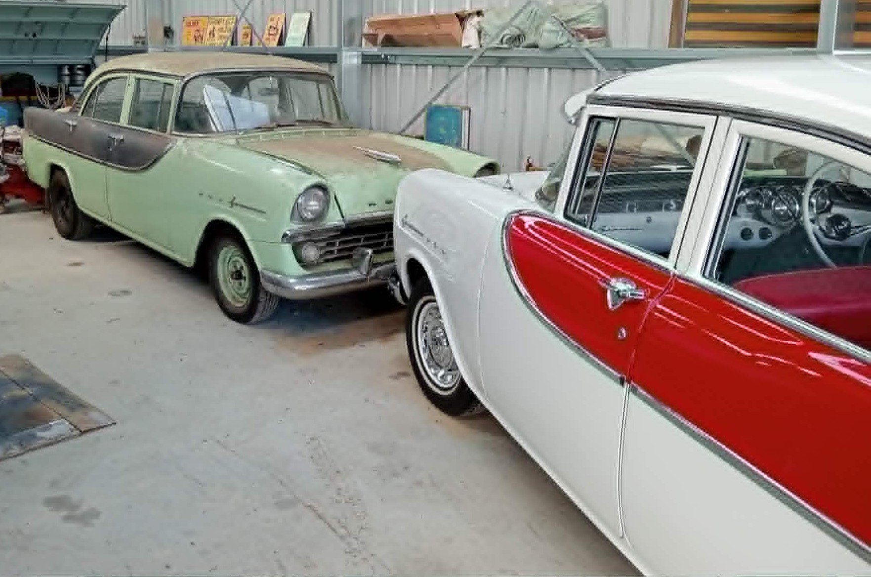

Plucking away at the tune. Todays fuel consumption figure 26mpg. Getting there.
A little reminiscing today too. It's been some 35 years since they've been together.
Ol Green and Grey sits in waiting for it's rebirth...
