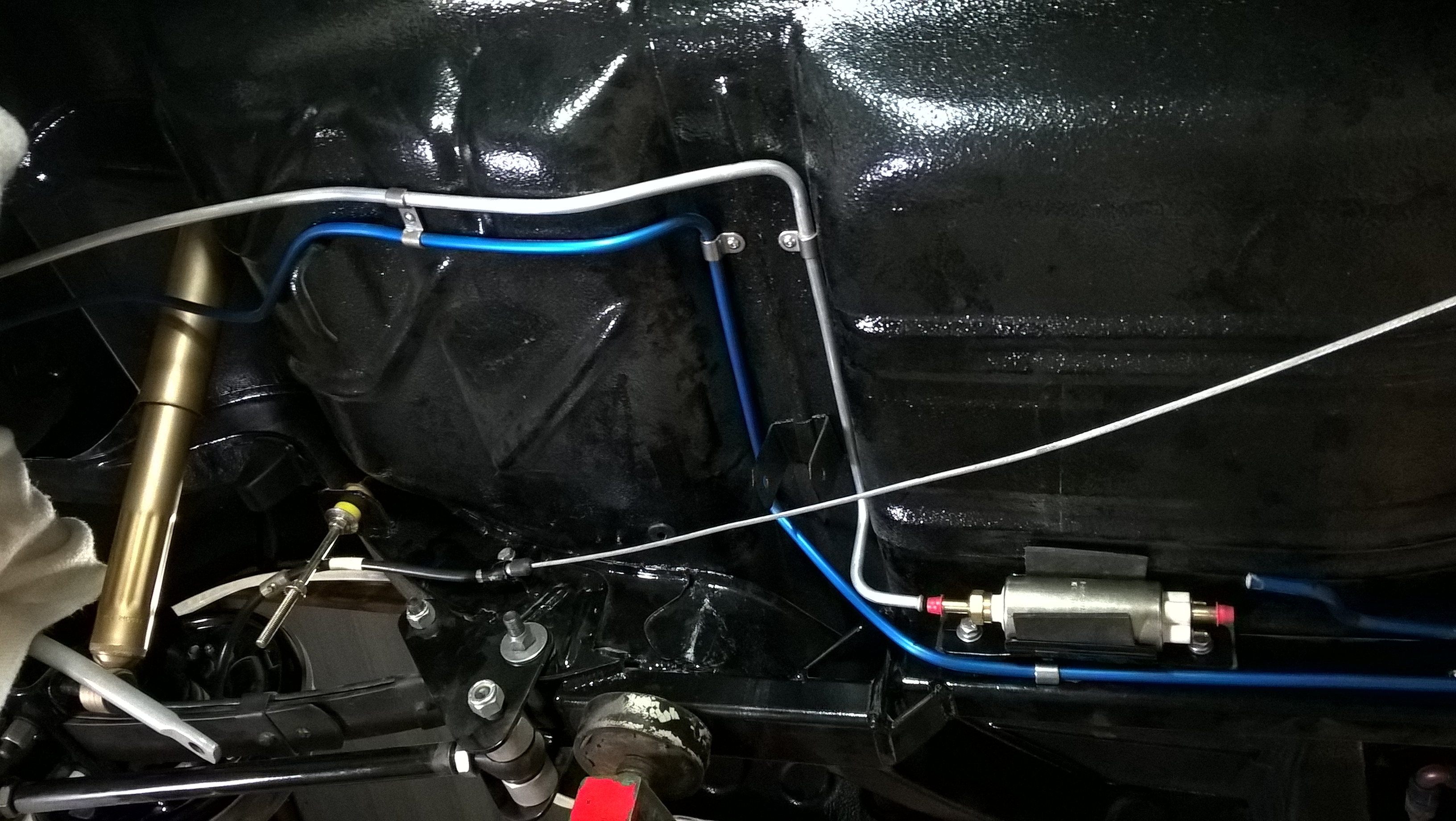

A bit more fuel line tonight, bugger of a job very time consuming !
Silver pipe is gravity fed from the tank to the pump and the blue is pressure then return.
