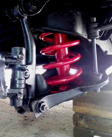

a while back someone was selling their stash of control arm nuts bolts, bushes, eccentric bushes etc so I grabbed them
bolted them up with the seals, king pins and some red bits
front end 1.jpg (91.12 KiB) Viewed 645 times
Patrick

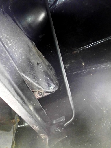

62ekute wrote: Sat Dec 12, 2020 1:46 pm shortened the tailpipe so I can open the tailgate all the way
Patrick
https://www.legislation.gov.au/Details/F2011C00102
see 10.2.2

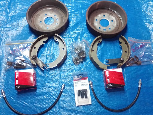

rainy day but I did get a bit of a chance to tidy up under the guard - took the opportunity to put the brace on while the wheel is off
got the brake shoes ready
brake shoe.jpg (73.82 KiB) Viewed 602 times
Patrick

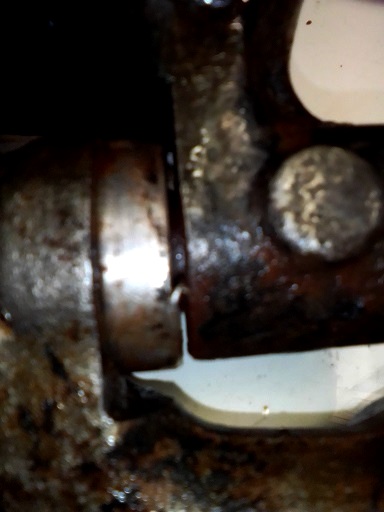

In the Shed wrote: Tue Feb 02, 2021 5:54 pm Hmmm.... close but nah, thrust bearing probably collapsed.

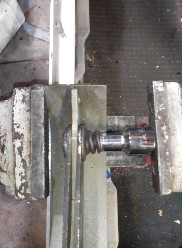

Hi Stephen, yep, here's a close up. Patrick
took a few days of soaking in penetrating oil and trying various ways every now and then to get this bush out ... no particular reason for taking it out - just the sport of it

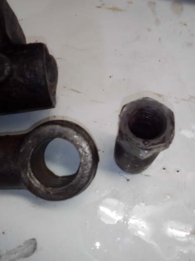

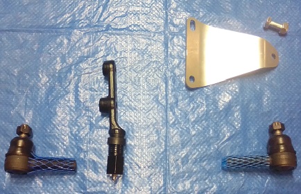

spent some time disassembling and cleaning up stuff on the passenger side of the front end and noticed a bit of play in the idler arm support ... so picked up a few more bits for when I put it back together
steering 1.jpg (69.9 KiB) Viewed 557 times
Patrick
Re: Gimme 5 years
Posted: Mon Feb 08, 2021 8:21 pm
The idler arm support seems to be one of the things that gets the most wear.
With the steering box brace, consider putting a hole in it so you don’t have to remove it to check and top up steering oil.

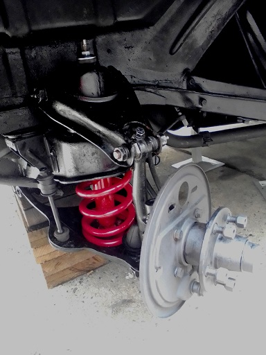

bit of a slow start to the day but I did manage to put the passenger side front suspension together
front end 2.jpg (75.29 KiB) Viewed 536 times

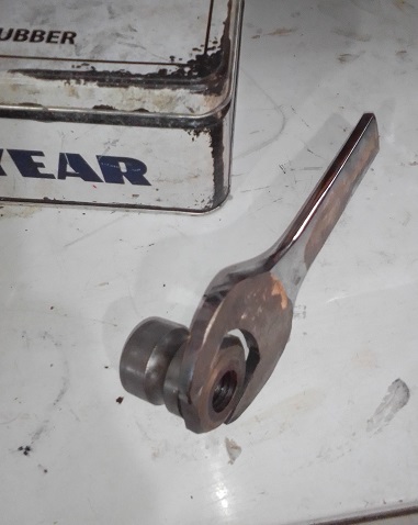

then I ground down a spare spanner into a camber and castor adjusting tool

Re: Gimme 5 years
Posted: Tue Feb 09, 2021 5:51 pm
Clay’s hierarchy of king pin wheel alignment
1. Obtain maximum possible caster
Ditto:
2. Maximum camber
3. Maximum upper control arm outer pivot centre height.
Set in that order.
I don’t think it is possible to set enough of either caster or camber in these but then I do like my highway driving and hard cornering. The higher outer pivot lowers the roll height, which results in notably improved handling, so the learned RS tells us.
Nice tooling mod. My dad in laws old crescents fit without this.
Re: Gimme 5 years
Posted: Tue Feb 09, 2021 6:31 pm
by 62ekute
thanks Clay :thumbsup:
Re: Gimme 5 years
Posted: Tue Feb 09, 2021 6:46 pm
by ardiesse
What Clay said.
I bought a Trojan "stumpy" adjustable spanner, and it works a treat. But the ground-down open-end spanner looks like a proper person's tool.
