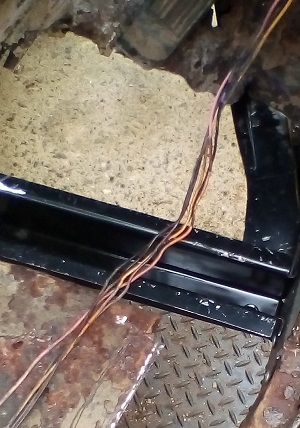

by 62ekute
put in one of these
and one of these
x (2).jpg (124.82 KiB) Viewed 966 times
Re: Gimme 5 years
Posted: Fri Apr 17, 2020 8:32 pm
Thosenumber one body member bits are easy to fold up in the vice with 18# sheet

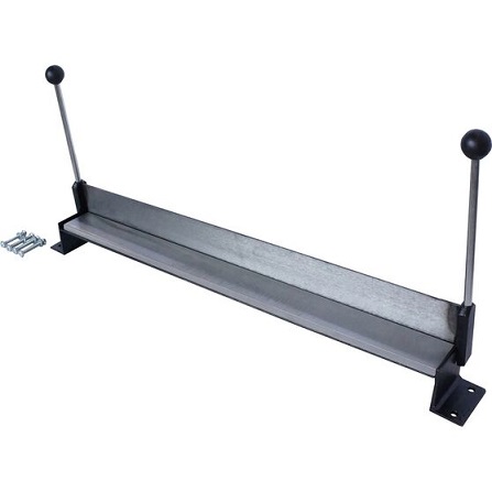

yeah, I've got a manual sheet-metal bender which is pretty handy for making patches ... but, it was so easy (lazy) to go through all of the available repair sections and buy them in one go
Re: Gimme 5 years
Posted: Fri Apr 17, 2020 10:42 pm
Very handy machine. What length can you bend?
Re: Gimme 5 years
Posted: Fri Apr 17, 2020 11:14 pm
by 62ekute
It's 750mm wide. I picked it up from Supercheap a while back for about $50
It's advertised as being able to bend up to 1.4mm thick. One of the reviews says it struggles with anything over 1mm and 500mm in length.
I usually work with 1.2mm and haven't had a problem. I clamp the top plate down with a couple of pairs of vice grips.

I have the same little bender it works pretty well but as you say just have to clamp the centre, I just use a couple of G clamps.
