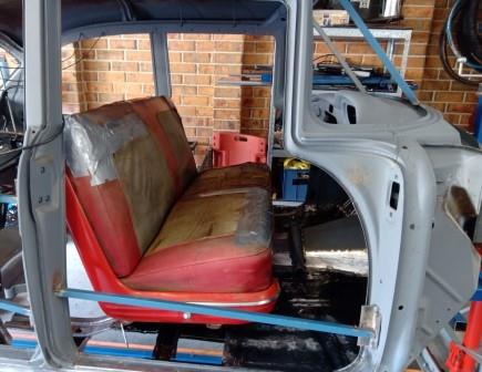

Thanks Clay. Well I dug out the front seat from the shed
seat in.jpg (36.53 KiB) Viewed 1202 times
and the clearance looks good
seat clearance.jpg (27.24 KiB) Viewed 1202 times

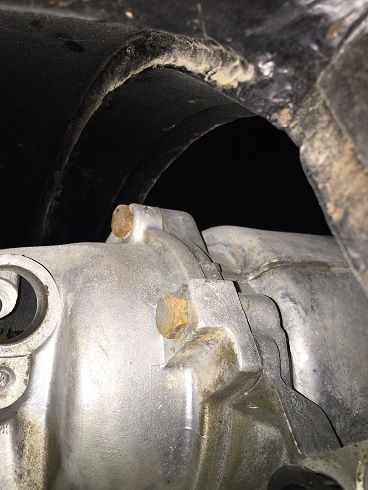

May as well leave it out now and start working on it. I've only got 1 good attachment point, the rest rusted away...

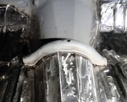

Speaking of rusted away, I think I can save the internal tunnel brace after amputating the rust infected legs. But it seems like an overly large bit of kit for what it does?
Tunnel Brace.jpg (30.46 KiB) Viewed 1202 times

Dave, delete the internal tunnel brace as the carpet over the top will look lumpy. I have Hydro floor not aftermarket tunnel.
carpet (1).JPG (96.91 KiB) Viewed 1199 times
I suggest bending some rectangular tube 50 x 20, by pie cutting it, form it to the floor and weld to the underside or fabricate from sheet sheet.
A bit hard to see with the trans in place.
under brace 1.JPG (77.67 KiB) Viewed 1199 times
under brace 2.JPG (60.6 KiB) Viewed 1199 times
Hope this helps but it's your build so do it your way.
Posted: Fri Sep 10, 2021 3:43 pm
I’m happy now you know it fits. I guess the original tunnel top sits level with the floor where the seam forms to box section so it is unlikely to foul.
As Roger suggests, take in to account your intended flooring. I like the original style rubber that M Vigo makes which is moulded from his original Hydramatic floor pan I believe. Hence if it were me, I’d keep it. But then most fit carpet.

Thanks Roger and Clay. I might leave the tunnel brace until I test fit the Hydromatic (in the waaaaay off future) and if there is room put it underneath as Roger has done. I'd like to have carpet and smooth as possible.

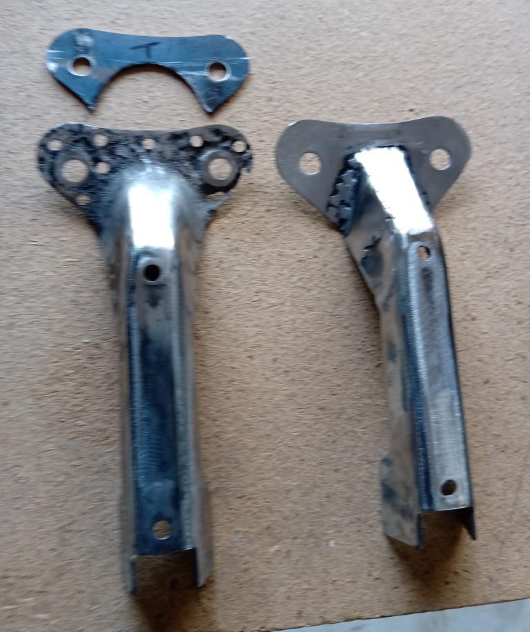

So test fitting the front seat distracted me and I've stripped it down:
Front seat stripped.jpg (227.55 KiB) Viewed 1143 times

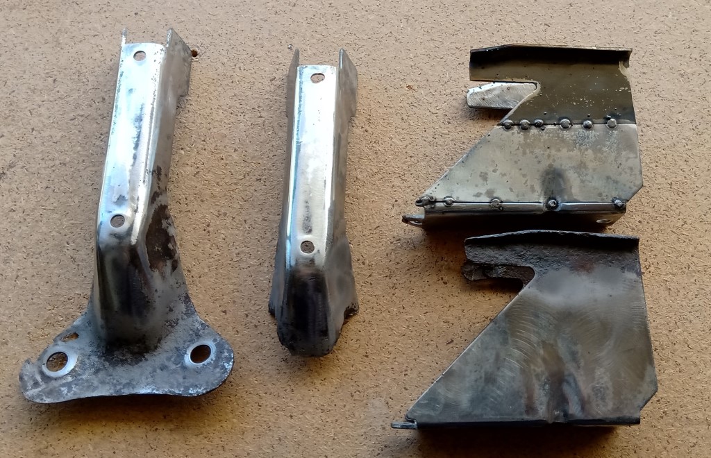

Only 4 bits of broken springs. I was able to fix 3 and the 4th is high up in the backrest so probably won't bother. Seat mounts were nasty...
Front seat mts 1.jpg (230.89 KiB) Viewed 1143 times
One of the front ones was missing the bottom 'hooks' altogether (initial repair in photo above), the other front one I ended up putting reinforcing plates on the outside of the 'hooks'.
Had to fabricate the attachment point for one of the rear mounts. Lucky one of them was in one piece to use as a template but it was pretty thin so ended up putting a reinforcing plate on it.
Seat mts 2.jpg (122.18 KiB) Viewed 1143 times
Seat mts 3.jpg (95.26 KiB) Viewed 1143 times
Lots of rust preventative spray, primer and matt black later and it is all prepped and ready to go to the trimmers at some point, when I've got the other relevant bits ready to go and settled on colours - yes Orange!

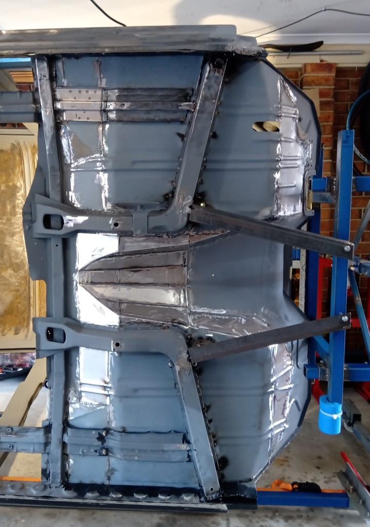

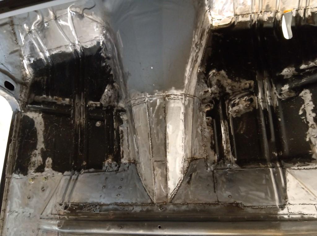

Finished off front floors - made plenty of mistakes with my patch panels so patched the patch panels and now it looks like a patchwork quilt of patched patch panels... but I'm getting good at welding gaps...

Wow Dave the floor is looking fantastic. Especially like what you've done around the trans hump. Looks like you have mastered the bead roller too
As for roof, if you can get that done right, you might as well put up a shingle outside 'panel beater works here'. Couldn't get any harder than getting roof panels finished with the right curve and dent free. If anyone can do it, you can.
Posted: Tue Oct 12, 2021 6:44 pm
Looking good Dave. I’m in the same boat with front floors. I’m thinking about replacing some of my joins between old and new with additional patches. The repair panels didn’t really extend out far enough, and I’ve had to butt weld to some dubiously thin bits.
