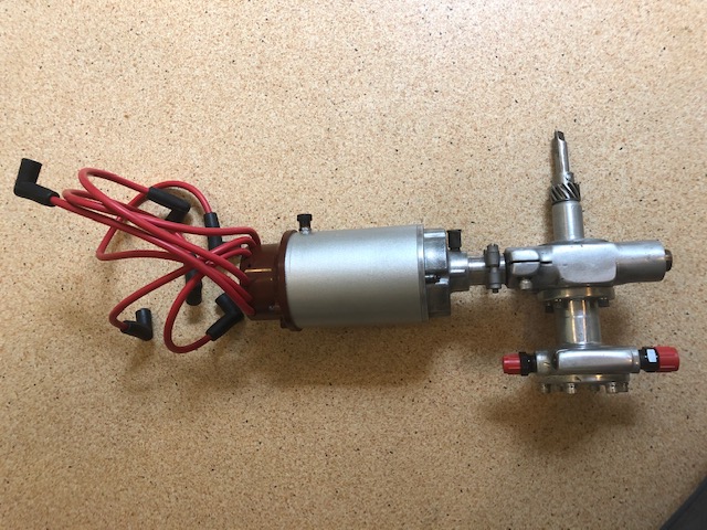

Also got the angle drive screwed together, and mated up to the pump and magneto:
Angle drive 1.JPG (129.21 KiB) Viewed 7023 times
Angle drive 2.JPG (108.54 KiB) Viewed 7023 times
I fitted some black AN fittings (-8AN suction and -6AN discharge), and covered them with the red plastic caps to keep crap out. That is one damn heavy assembly... 5kg. No wonder that the angle drive has a tendency to crack off the "tang" in the block.

That's the plan. Scintilla made a hefty ally ring that clamps around the maggie body. They were originally used to mark magneto rotation (timing). I bought a couple in a job lot of maggie parts a few years back. I plan to use one of them with a short tab to take the magneto weight onto an engine sideplate screw... something like this:

The layout will be interesting.
Injection and supercharger live on the drivers side. The injector is likely to be pointing skywards... no way it is fitting under the bonnet.
Angle drive sits into the dizzy hole, then runs the magneto forwards towards the fuel pump. Maggie head will be ~9" forward of the dizzy hole, pointing towards the grille.
Dry sump tank will live on this side too, on the subframe step.
Passenger's side has the headers only.
Front of the engine will get complex - need to sneak in the supercharger drive belt, plus the dry sump pump hanging off the end of the cam (through the timing cover). May have to move the radiator forward of the radiator top support.
Lots of brackets and adapters to make.

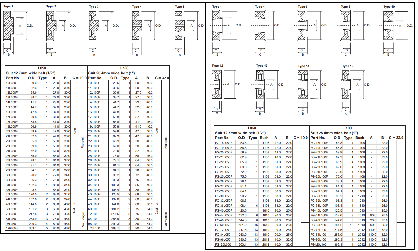

Similar replacement pulleys are available from Naismith Engineering:
https://www.naismith.com.au/list_products.php?m=42
The table below shows their L-profile belts:

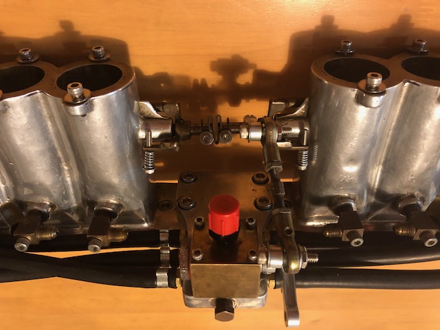

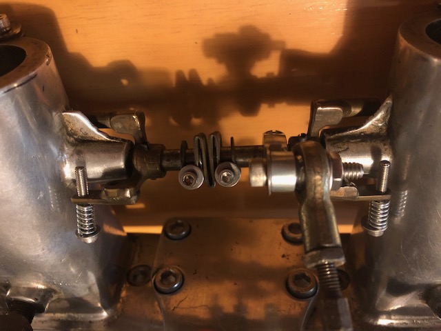

I think I have the linkage nutted out. The linkage was a hodge-podge of nut sizes and types, some stripped. I've replaced the lot with stainless capscrews (there were a lot of funky fine UNF and UNC threads in that lot). I've retained the W-clip - none too happy, but little choice given the shaft misalignment. The el-cheapo pressed-steel throttle arms have been replaced by Stromberg SuperLink Throttle Arms (part number 9090K - https://www.stromberg-97.com/product-in ... kage-parts). The arms are diecast zinc (a lot lighter than the similar Hilborn brass arms), and closely resemble a H-beam conrod. They needed to be drilled out slightly to suit the McGee shafts.
I'm not quite happy with the hex-link (the piece with a rose joint at either end). The hex-link is pretty much extended out, and I can't quite get the throttle arms parrallel. This give a tendency for the arms to want to go over-center. When the arms go over-center, there is a tendency to want to not come off idle (bad idea during a drag race). I think I can swap out the guts of the hex-link for a longer rod (it is a funky rod, LH thread one end, RH thread the other). Need to check my linkage spare parts department and see what I can cannabalise... suspect the guts out of an old Redline Performance hex-link will do the job.
throttle arms and hex-link.jpg (75.8 KiB) Viewed 6943 times
W-clips and throttle stops.jpg (101.41 KiB) Viewed 6943 times
With the arms in place, I need 1.5" (~37mm) of throttle arm travel to move from idle to WOT. The original GMH firewall lever (attached to the accelerator pedal via linkage) only moves some 12mm. It's kinda on the wrong side of the engine too for a Repco head. Chances are I will need to remove the firewall linkage, and move to a cable setup. By extending the lever that pokes from the pedal through the firewall (by welding or bolting on some flatbar) by an extra 40mm I can get a cable pull of 35mm - perfect.

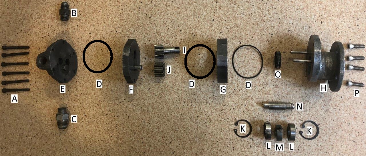

Some more assembly photos. First one is another McGee belt drive. This is a little different from the one posted earlier, as it is hex drive (earlier one was a tang drive to suit the earlier fuel pumps). The hex is 3/8”AF.
Belt drive assembly.jpg (132.85 KiB) Viewed 6919 times
A: Drive pulley
B: Drive pulley retaining setscrew (1/4-20UNCx37/64”, square head)
C: Bearing retaining circlips
D: Bearings (R8LL, ½”x11/8” x ¼”)
E: Brass bearing spacer
F: Brass bearing spacer retaining roll pin
G: Body
H: Shaft
The second assembly photo is a McGee “hex head” pump.
McGee hex head pump assembly.jpg (335.13 KiB) Viewed 6919 times
A: Body screws (#10-24UNCx1.75”)
B: Inlet nipple (-6AN to 9/16-18UNF ORB)
C: Outlet nipple (-8AN to 9/16-18UNF ORB)
D: Body sealing rings
E: Inlet/outlet cap
F: Gear retaining body plate
G: Volute body plate
H: Base assembly
I: Drive gear
J: Driven gear
K: Bearing retaining circlips
L: Bearings (R8LL, ½”x11/8” x ¼”)
M: Steel bearing spacer and grub screw
N: Shaft
O: Lip seal, radial dual lip (TC) oil seal, ½”x11/8” x ¼”, part number RS05011225LNC made in Buna-N.
P: Pump to drive retaining capscrews (1/4-20UNCx0.75”)

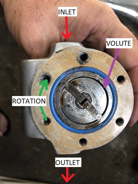

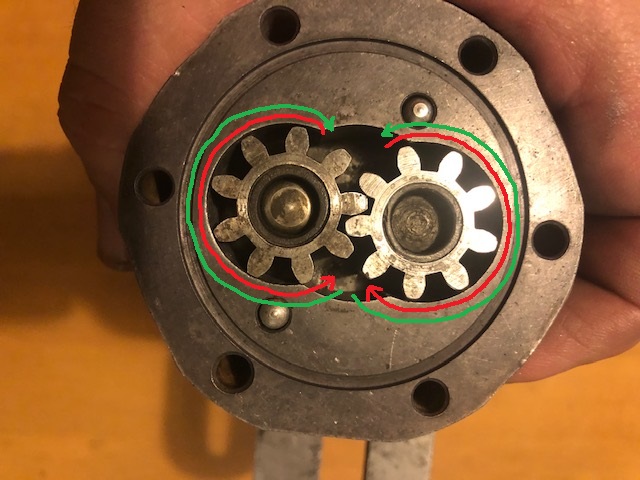

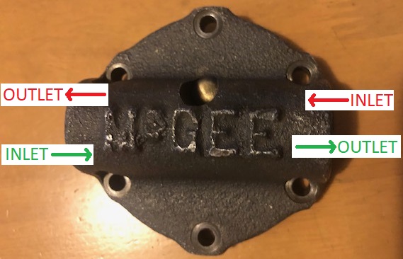

The pump is a gear pump (different to the earlier McGee sliding vane pumps), and is reversible. If the pump is driven clockwise looking onto the drive pulley (e.g. driven by belt from the crank), then the fuel flows as per the red lines in the diagram below. If the pump is driven anticlockwise looking onto the drive pulley (e.g. driven by belt from the camshaft or direct driven off the dizzy), then the fuel flows as per the green lines in the diagram below.
McGee pump circulation.jpg (101.39 KiB) Viewed 6919 times
As the pump inlet/outlet cap only goes on one way, this means that the pump inlet and outlet depend on pump rotation (as per the diagram below):
McGee pump flow.jpg (96.08 KiB) Viewed 6919 times

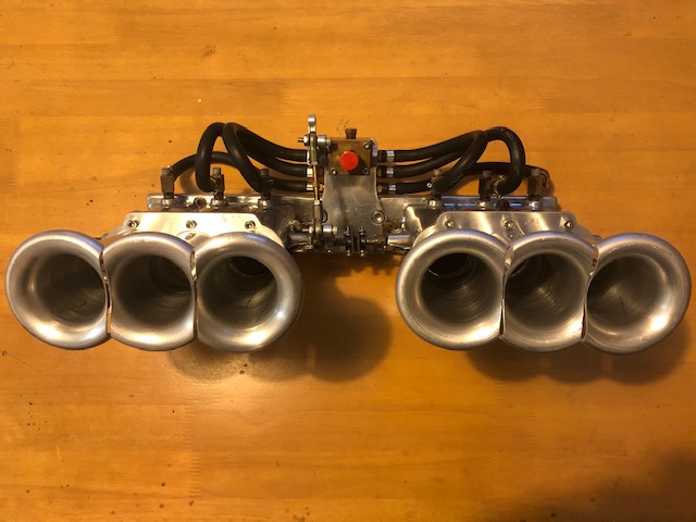

Got the ram tubes done, with base plates and TIG work by a local sheetmetal mob:
Ram tubes side view.jpg (88.69 KiB) Viewed 6890 times
Ram tubes top view.jpg (75.07 KiB) Viewed 6890 times
Jim Henson would approve :mrgreen:
