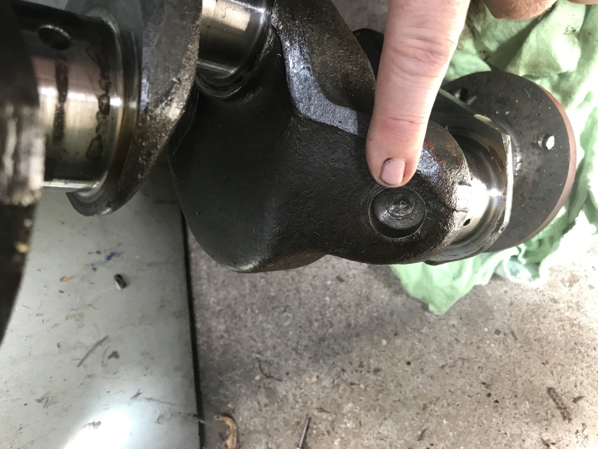

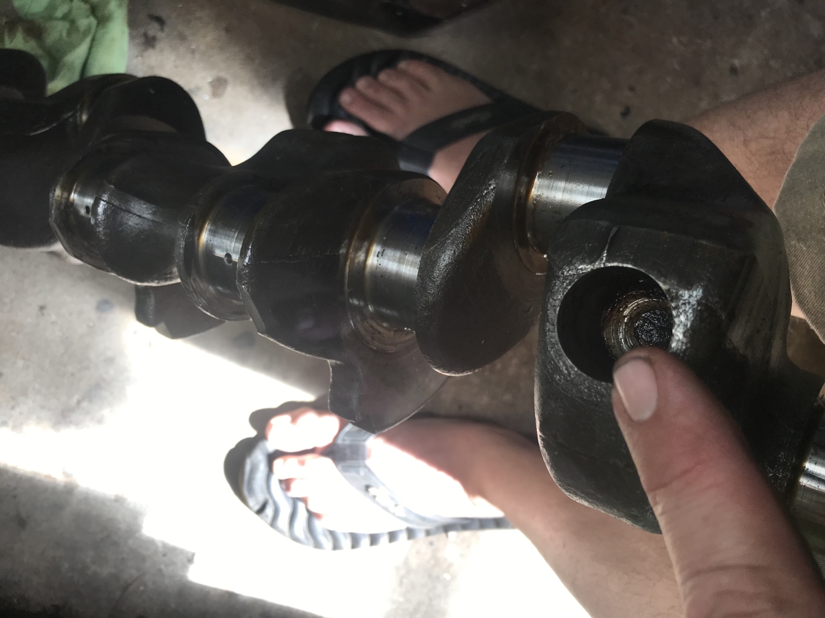

Not sure if this is normal, a reco job, or a lightened crank (?).
Holes in the face and edge of the counterweight - holes are 1" diameter and 1.25" deep (rough):

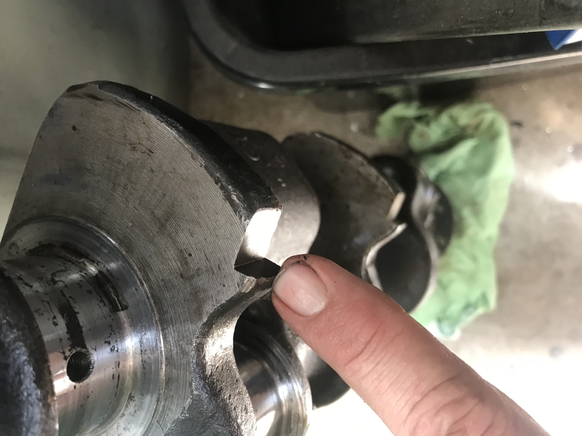

Notched throws:
Optimized-Notched throw.JPG (597.62 KiB) Viewed 1352 times
Posts: 2816
Re: Harv's meth monster project
Not sure about the notched throws Harv but the holes do look like balance holes but yes look pretty big from the photo.
ardiesse
Posts: 1207
Post by ardiesse »
Harv,
I reckon the notches are index marks to define "zero degrees" when the crank was being machined in the factory. They seem to line up with nos. 1 and 6 crankpins.
