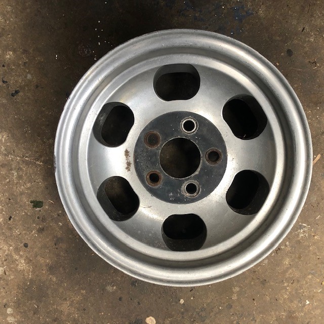

With lockdown over, I got Number 1 Son to pickup the Sampsons I bought a while back. (edit: these are not Sampsons... they are Performance Wheels Australia Spitfires).
These are the 6" ones:
6 inch Sampsons.jpg (116 KiB) Viewed 5783 times
Back space: 3.75" (96mm)
Front space: 3 11/16" (94mm)
Offset: 1/32" (probably zero)
Flange-to-flange: 7 7/16" (189mm)
Center bore: 2 5/8" (67mm)
These are the 8" ones:
8 inch Sampsons.jpg (105.86 KiB) Viewed 5783 times
Back space: 4 9/16" (116mm)
Front space: 4 3/8" (111mm)
Offset: 3/32" (2.4mm)
Flange-to-flange: 8 15/16" (227mm)
These are wiiiiiiiiiide:
They have got a 235/50/13 rubber band on them now, and can go up to 245mm. I can get a Michelin radial in that size... or a Dunlop slick at 240mm :mrgreen: Will have a play on the weekend and see if it fits on the back of the meth monster.

They'res no Sampson markings on them. The 8" have OFFROAD USE ONLY cast inside, and both sets have PERFORMANCE 8x13JJ (or6x16JJ) cast into the front.
Do you have any brochures, adverts etc that show the difference between Spitfires and Sampsons? Have heard of Sampson Magnum and Eliminators too, but other than peoples memory I can't find anything conclusive to tell them apart.
EDIT: Hmmmm... some Googling has some answers. Looks like my last two are Performance Wheels Australia "Spitfire" models. The PERFORMANCE cast into them was the trick.
