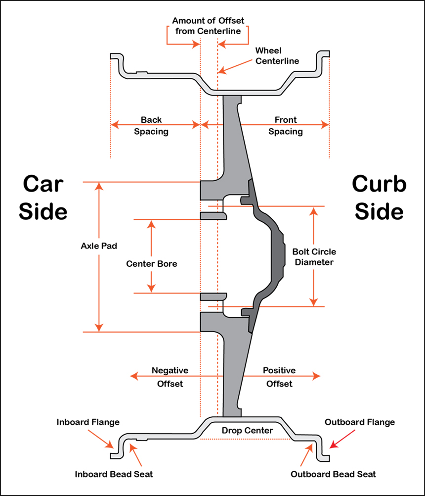

Perfect
Hoping we can get a few photos and measurements of the different early Holden wheels posted up.
A diagram so that we are all talking the same thing:
And some starting info:
FX-FJ Holden rims are 6½” bolt circle diameter
FE-HG and Torana rims are 4¼” bolt circle diameter
HQ-WB rims are 4¾” bolt circle diameter
Commodore rims are 120mm bolt circle diameter
FJ-HK wheel nuts have a 45º taper
HT-VF and Torana wheel nuts have a 60º taper
FJ-WB wheel studs are 7/16-20 UNF thread
VB-VZ Commodore wheel studs are 12x1.5 metric fine thread
VE-VF Commodore wheel studs are 14x1.5 metric fine thread
FX-FJ Holdens have 15” wheels
FE-HR have 13” wheels
HK-WB have 14” wheels
WB Statesmans had 15” wheels
Commodores had mixtures of 14, 15 and 16” wheels
