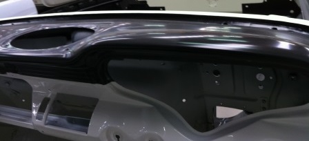

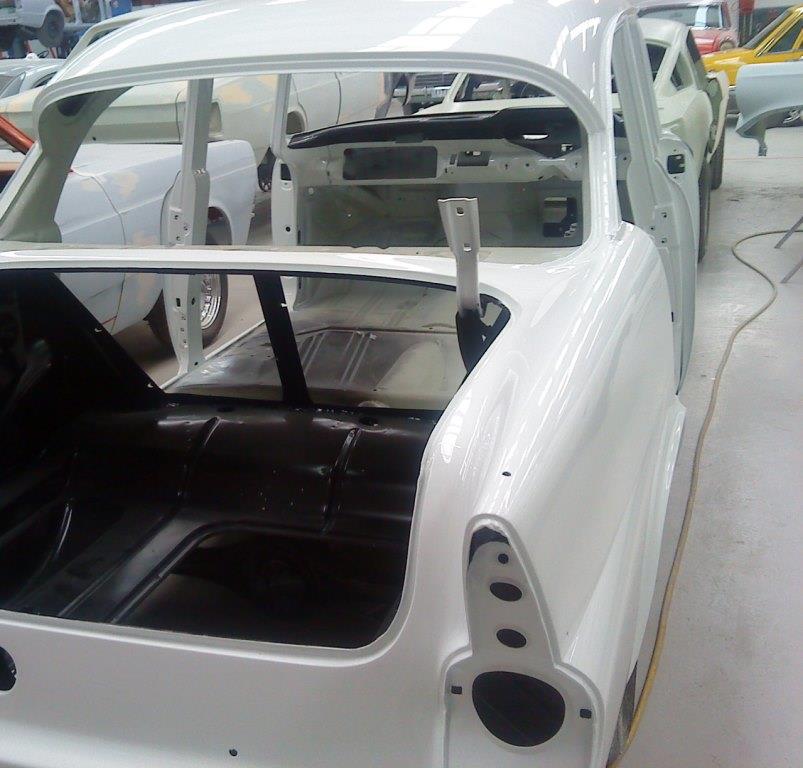

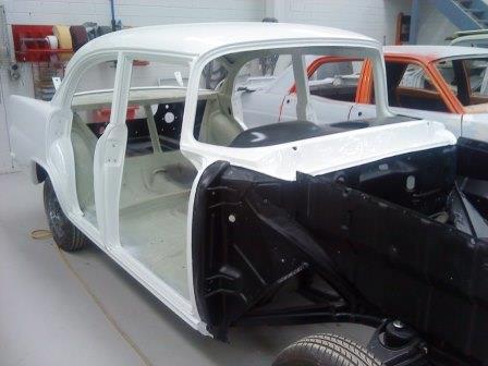

just a couple of pics after the first coat of paint went down this week. Am pretty happy as it come up pretty good straight off the gun.
All underneath is finished paint wise. Next lot is guards and doors then then we can hit it with the Apache red down the side. Cant wait to see the red when it gets on. Still waiting on all my chrome work which is due in couple of weeks.

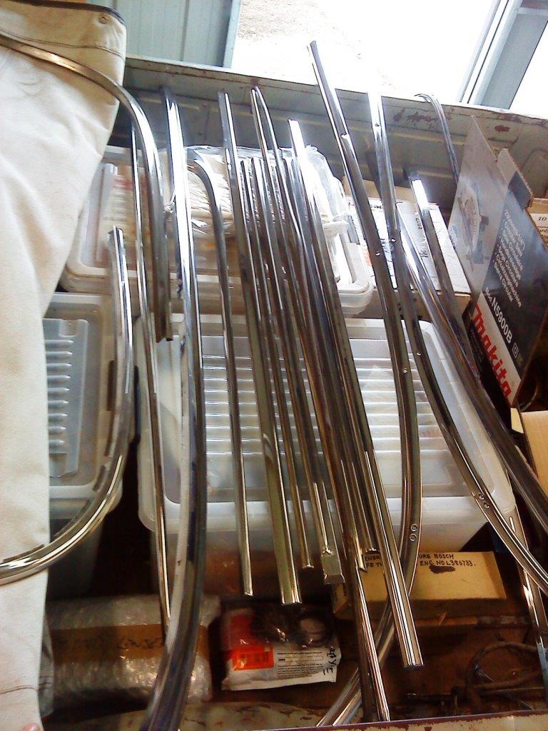

Yet another day of polishing all the stainless bits.........tedious isn't the word :roll: Worth it though when you see the end result.
Posted: Sun Mar 17, 2013 7:51 pm
by WayneXG95
Stainless polishing 101?
Dont they look great on their wheels in primer... :clap:
