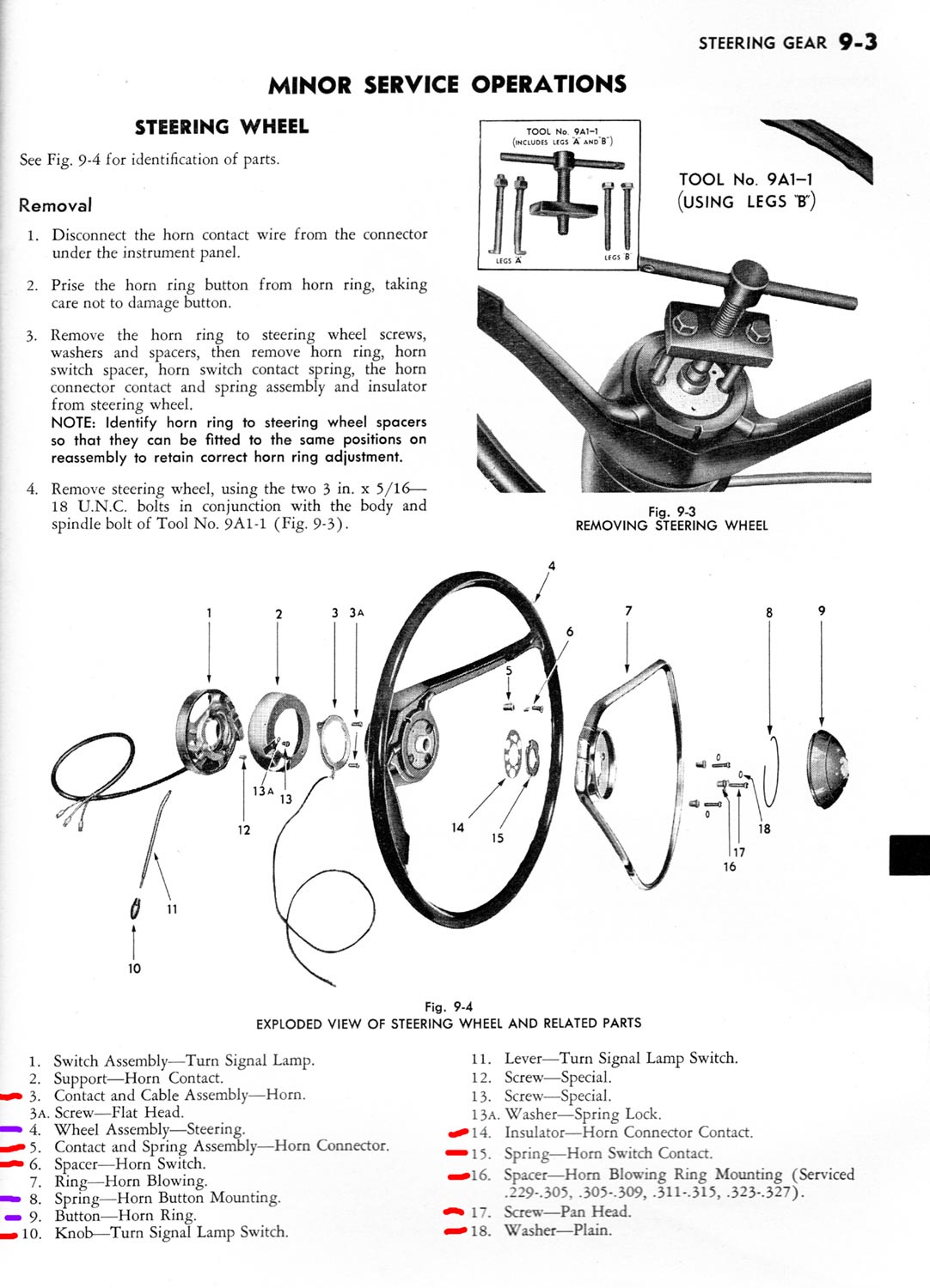

Ponked the crappy steering wheel out today, and found out it had a coupple of pins on the back of the steering wheel, which have left some nasty grooves on the inside ends of the horn contact ring, and also the contact ring is bent a little at the right edge.
looks like the previous owner bashed the different steering wheel on with a hammer, had to get a fat mate to gorilla the thing off (pulley puller we have didn't fit)
so far, we need MOST parts.
Have marked Red lines on bits that are missing/Damaged. and Purple lines on what we COULD get in better condition.<br /><br />(DONT WORRY, LINES WERE NOT DRAWN ON ACTUAL BOOK, JUST A SCAN ON THE PC)
