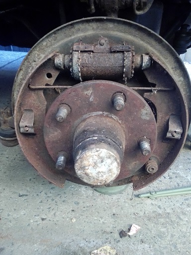

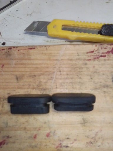

Harv wrote: Tue Jan 19, 2021 3:07 pm A word of caution on those rubber blanking plugs. I fitted some to the FB, and all looked good. At some stage though they caught on the adjuster cap, and canted it. The cap canted the shoe, and all hell broke loose. Squealing, and worn lining. I had a good discussion with Burt Bros about it, and they reckon the aftermarket plugs are deeper than the originals. I can't be sure - I've never seen an original. Worth a good check though once they are in.
Thanks Harv :thumbsup: :thumbsup: :thumbsup: ...
here's how the plugs look with the drum off
plug 1.jpg (61.85 KiB) Viewed 755 times
the backing is 5mm so I halved it
plug 2.jpg (53.66 KiB) Viewed 755 times
plug 3.jpg (56.52 KiB) Viewed 755 times
Patrick
Re: Gimme 5 years
Posted: Wed Jan 20, 2021 4:52 pm
That's the way paddy. Originally they would've been metal clips which are no doubt shallower. I've got the clips on my front brakes. Nothing on rears but I will have to get on to that.
Re: Gimme 5 years
Posted: Wed Jan 20, 2021 5:44 pm
Good outcome 😀
Re: Gimme 5 years
Posted: Wed Jan 20, 2021 6:07 pm
by FJWALLY
Good Solution and thanks for the heads up Harv - better to fix before it's F...d.

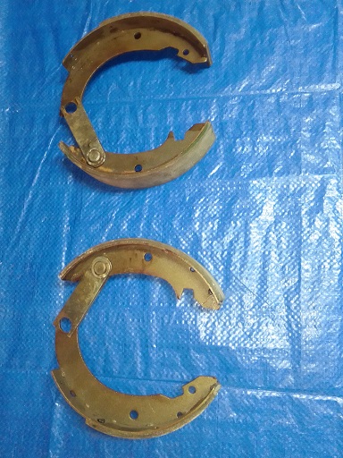

passenger side front brake shoes are near new (although the trailing shoe lining is debonding)
driver's side nothing
Front Brakes 1.jpg (96.26 KiB) Viewed 724 times
I'll get the originals re-lined; but, I've got these ready to go in anyway

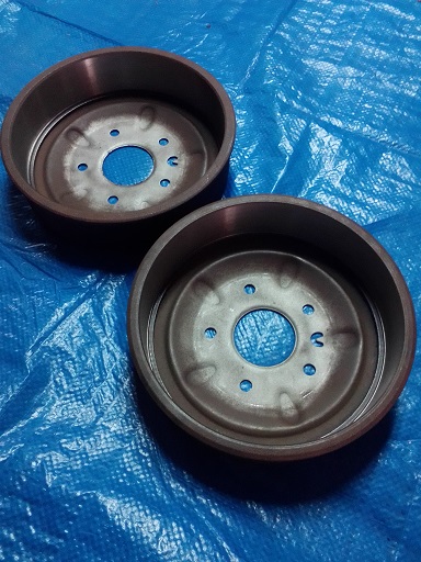

got ACT Brakes to put these on the lathe for a bit
Patrick

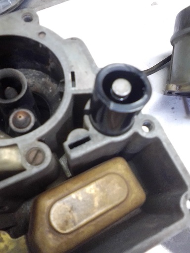

I noticed a flat spot if I blip the accelerator so had a bit of a look ... the accelerator pump was just dribbling instead of squirting. I took the top off the carby and could see a water bubble in the rectangular hole above where petrol is supposed to squirt out. I tried different ways to blow, suck and pump it through but in the end poured some metho in to get rid of it

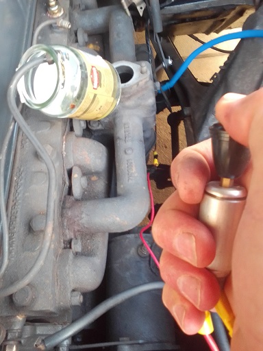

hopefully it's just a one off - I thought I better check if I got some in the tank so I made up a remote starter and pumped some petrol into a jar - all good.
remote starter.jpg (77.89 KiB) Viewed 636 times

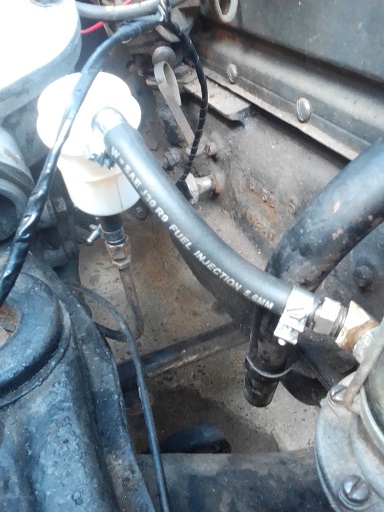

also decided to put a fuel filter in
fuel filter.jpg (85.06 KiB) Viewed 636 times

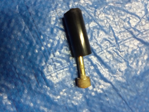

considering I'd been squirting carby cleaner in and using metho, I decided to go back to a leather plunger seal - I had a good one in a spare carby...though I assume they make the new ones out of something durable anyway
I don't have tool 6A20 but I do have poly pipe
accelerator pump 1.jpg (91.38 KiB) Viewed 636 times
accelerator pump 2.jpg (56.96 KiB) Viewed 636 times
Patrick
Re: Gimme 5 years
Posted: Mon Feb 01, 2021 5:14 pm
Good ol single strommie. Hopefully that’s sorted. Don’t be surprised if flat spot persists until she warms up nicely.

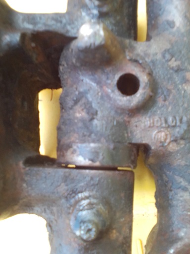

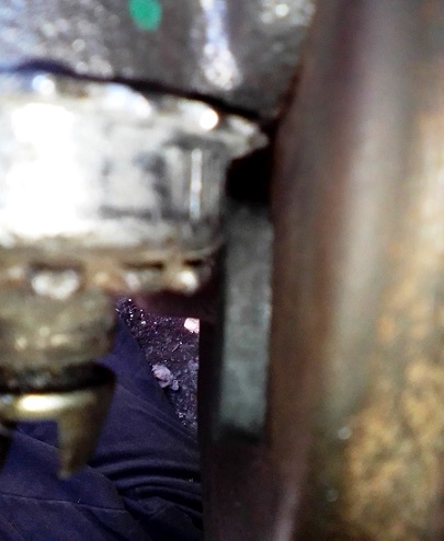

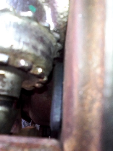

The weather is a bit better today so I made a start on the front end
got out the book - it said to get a feeler gauge and measure this gap - max 4 thou
only 76 thou over
king pin 1.jpg (55.46 KiB) Viewed 600 times

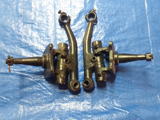

I've got these to go in
king pin 2.jpg (114.79 KiB) Viewed 600 times
Patrick
Re: Gimme 5 years
Posted: Tue Feb 02, 2021 5:54 pm
by In the Shed
Hmmm.... close but nah, thrust bearing probably collapsed.
Re: Gimme 5 years
Posted: Tue Feb 02, 2021 6:37 pm
by Brett027
Hi Patrick, I tried those Rares reco units too and found that the inner and outer wheel bearing mounts had been machined too much by Rares and the bearings were not a snug fit. There's ways around it, but in my case I decided to put kits through my old ones instead. If you go down that track, reamer is here if you want to borrow it. Brett
Re: Gimme 5 years
Posted: Tue Feb 02, 2021 6:47 pm
by ardiesse
The king pin retaining cotter pin is missing on all three (yours with the excess clearance, and the two reconditioned ones).
