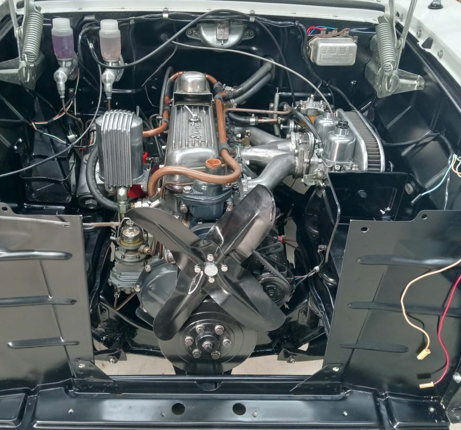

Engine and box in. Happily the damper clears the crossmember and sway bar.
Posted: Sat Apr 18, 2026 6:11 pm
Very tidy to say the least. Is that 1/2” copper and have you SAE flared it?
Posted: Sat Apr 18, 2026 9:25 pm
by Craig Allardyce
It's 5/8 tubing. No SAE flares needed. Once clamped, tarnished copper sticks to rubber really well.
