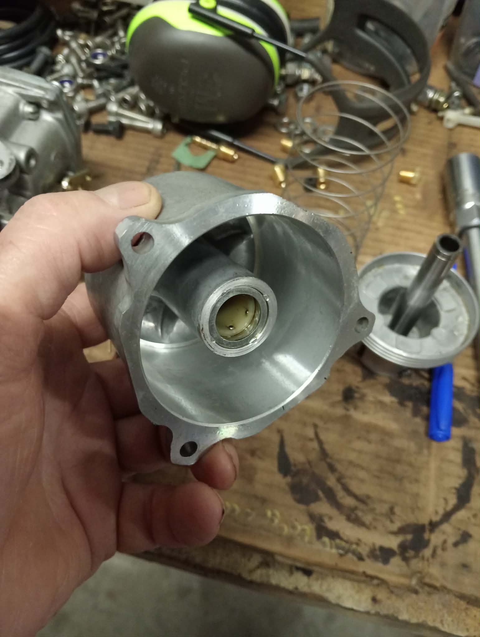

Anyway, one thing got the better of me. It stuck in my mind that it always takes more force to initially move something than to keep it moving. These carbs (HIF type SU) were always spec'd with ball bearing suction chambers. I never fitted them, and stayed with the old style. They looked better, and you could run large or small diameter piston springs, which gives you more options with combinations of the two types. These older ones always had a slight drag due to oil/fuel film on the piston tube and the suction chamber (very close tolerance).

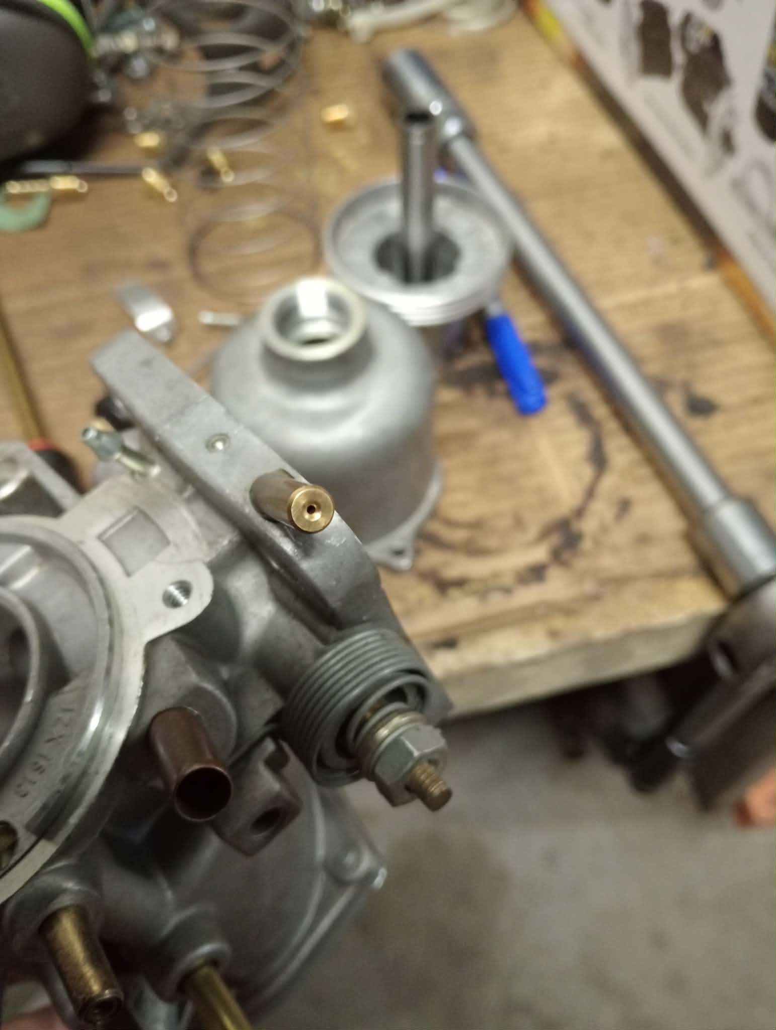

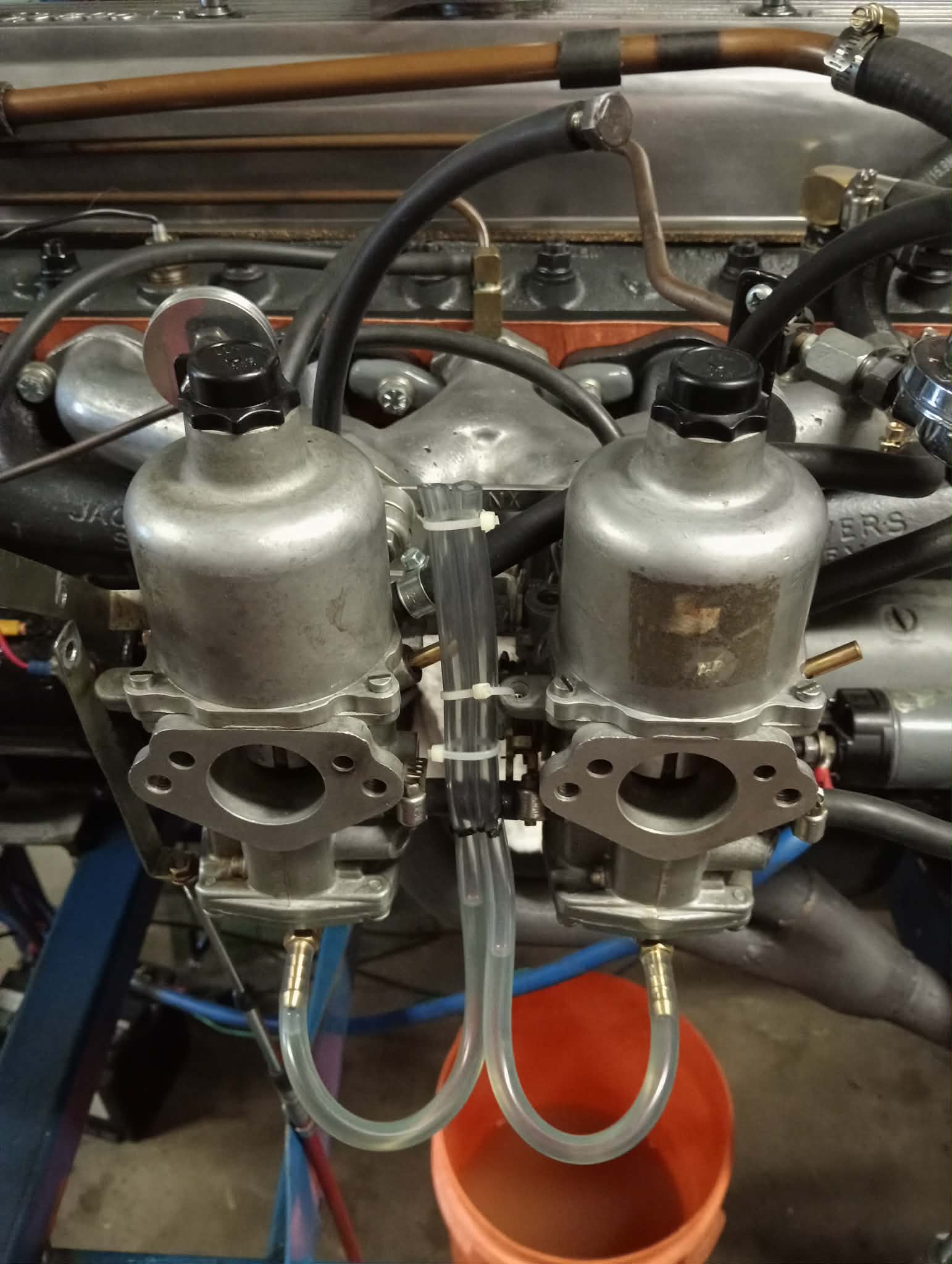

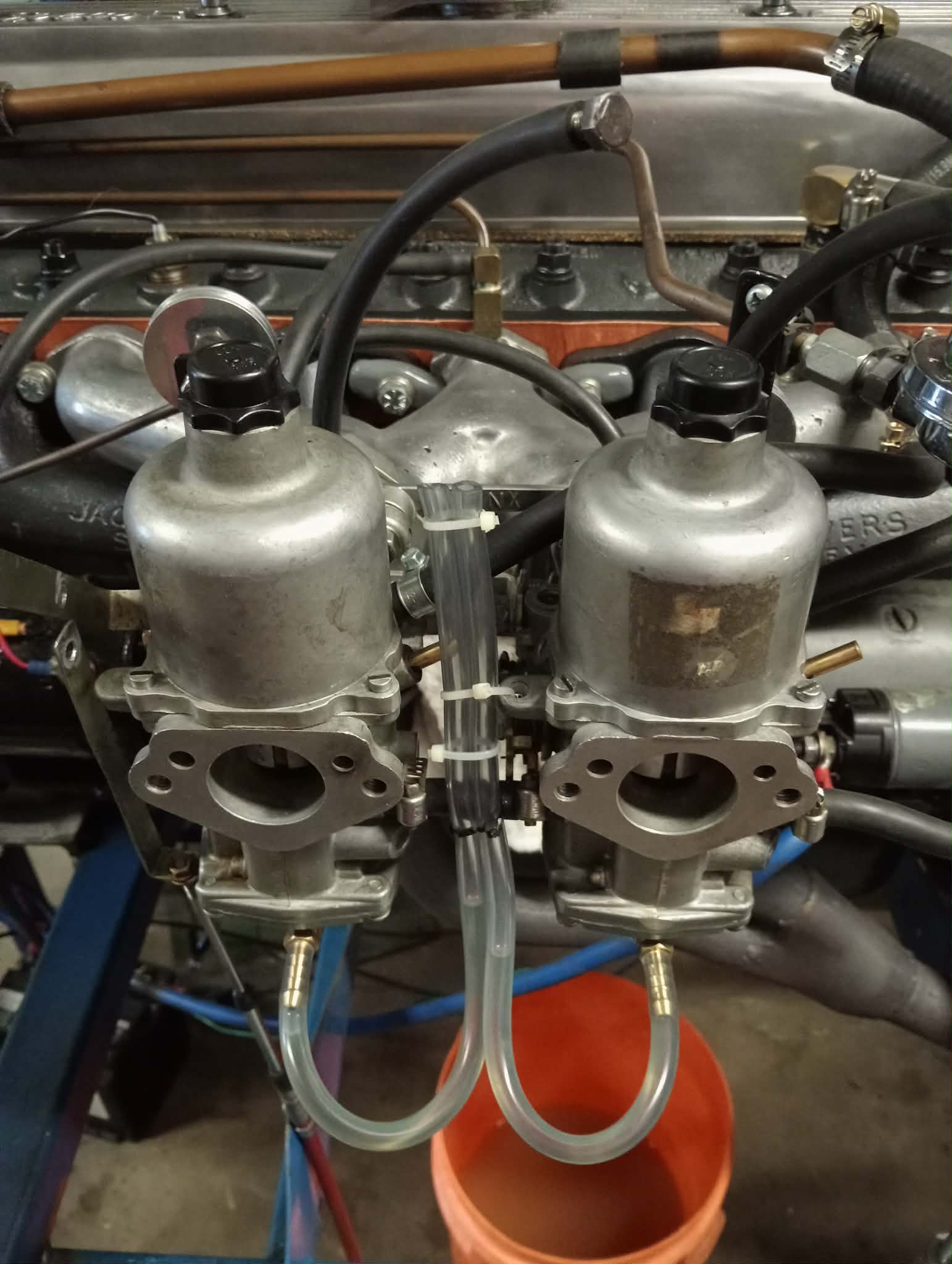

As my initial problem was going rich during the first part of the piston lifting, I decided to try the ball bearing chambers. Low and behold, it has dramatically improved. I'm now going to go with running the low pressure suction restrictor on the float bowl vent line. Using the manometer tubes, and with the vacuum line fitted to the float bowl vent tube, I can see and control the amount of fuel drop in the main jet. I just have to get the restrictor the right size so excessive fuel isn't leaned out at higher airflow through the carby. Good thing I have one to measure with some jet drills.
Point to note, the fuel bowls are still vented normally to atmosphere. The vacuum via the restrictor is teed into this line. I was quite suprised how little negative pressure you need to alter the fuel level in the jet. It's not even readable on analogue vacuum gauge at idle, but drops the fuel level an inch or so.
It also look like I have to polish up another set of vacuum chambers now!

Hi Craig,
Looking at the vacuum chamber photos, I see they have a tall style cap on the damper piston ends. Does this differentiate the ball bearing type chambers? The ones I have have the same style caps as HS6, and I’ve been told this probably means they are HIF6 rather than HIF44.
Posted: Mon Apr 06, 2026 3:17 pm
by Craig Allardyce
Yes, and a fatter neck on the suction chamber, BUT, HIF 4,6, & 7 carbs ran either normal or ball bearing suction chambers. Metric versions, HIF 38 & 44 ran only ball bearing chambers.

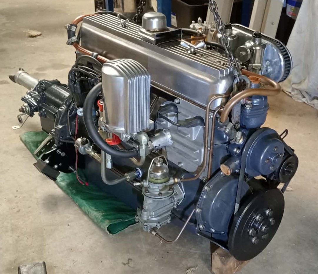

Well that's a wrap on the engine and box. I completed what I hope is the final solution to a leak free grey motor being a screw in dipstick. For those that know, the crank rotation at higher rpms tends to push oil up the dipstick and past the crappy felt seal.
Previously I had also repaired an external leak at the layshaft section within the bellhousing. This area is where the layshaft is pushed into the gearbox and is held in place by the input shaft retaining housing. The shaft is only sealed by its interference fit. Luckily I decided to leave the box inverted for a while to see if anything was leaking! It was. A bit of loctite wick in, and a custom gasket with retainer plate that is sandwiched under the input shaft housing fixed it.
Now onto refitting the steering box as I pulled it to check the internals again. I have an annoying amount of steering play and wander in comparison to what my EK ute was like to drive. Nothing was found and I'm suspecting the radial tyres with their sidewall flex is the issue. My EK was fitted with the latest Bridgestone crossply's and it steered and tracked really well.

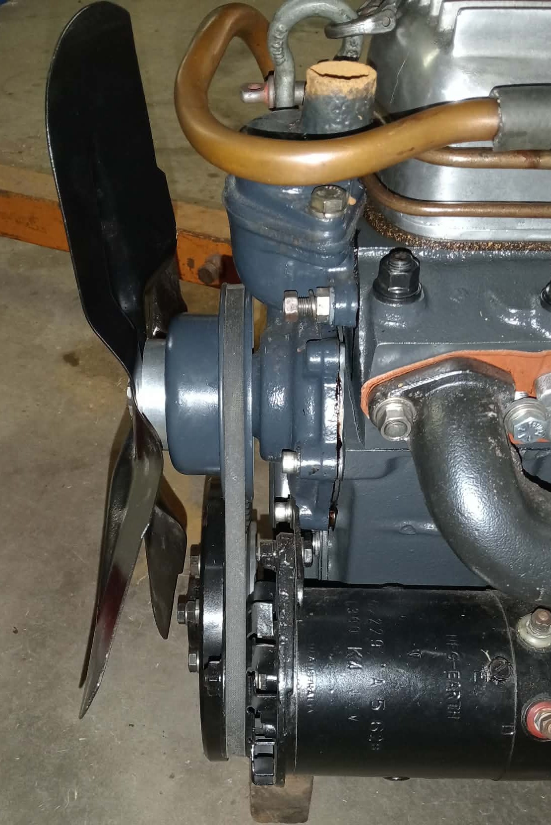

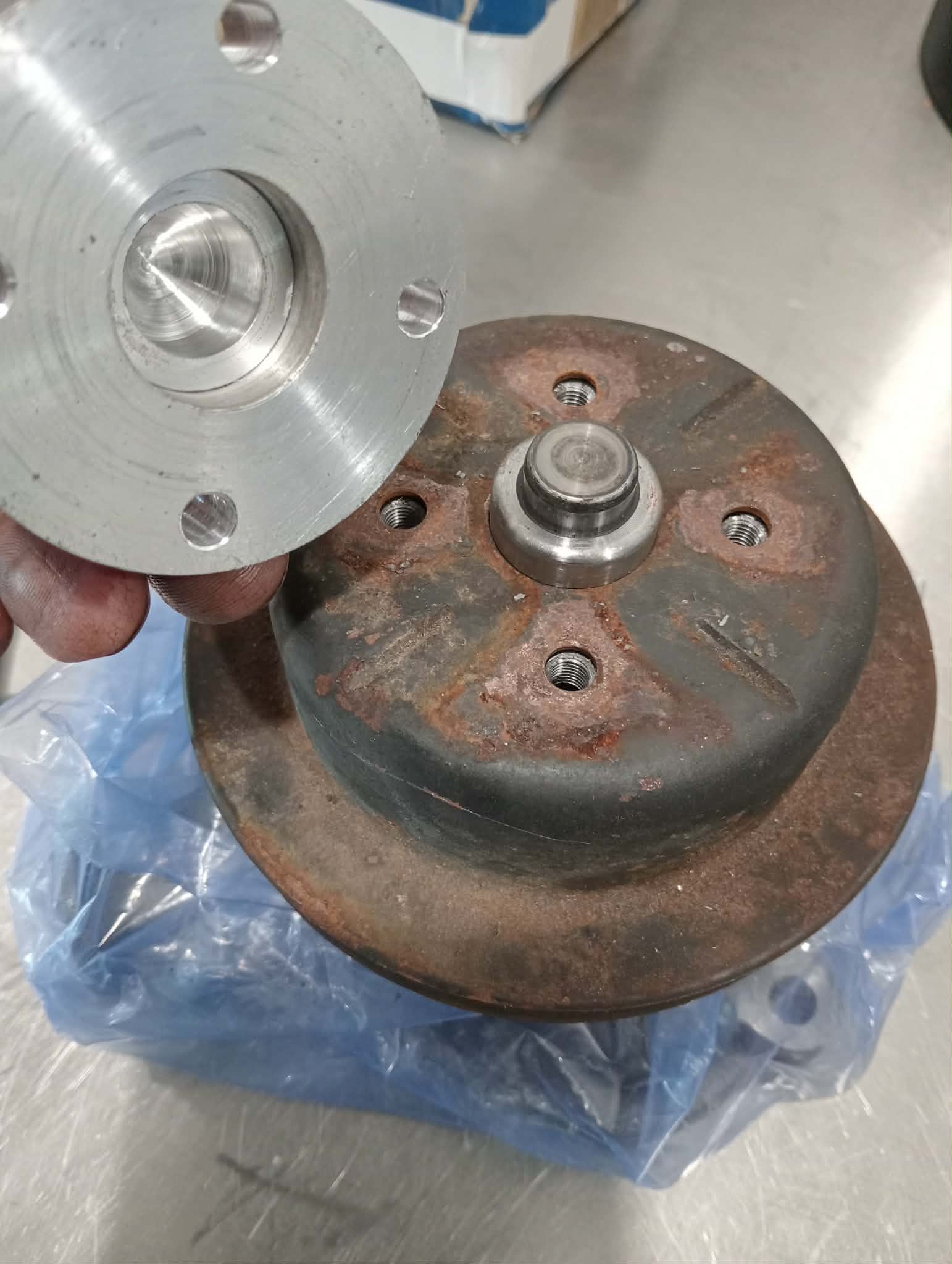

I have two more mods to do with regards to the new crank vibration damper. One is a 1/2 fan spacer that I'll have to knock up so the fan has clearance to the larger diameter damper. The other is removing the two crossmember splash guards as they will need to be slotted for the damper (slightly).

Knocked up the 1/2" fan spacer and fitted it today. Fan clears the vibration damper nicely.
