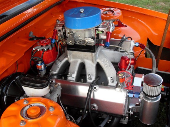

- 95674473-C90B-4ECC-BD19-B57503400C01.jpeg (84.43 KiB) Viewed 944 times
So Boys, I have this sitting in the shed, it’s a 308, do you think it will pass the engineers test lol
