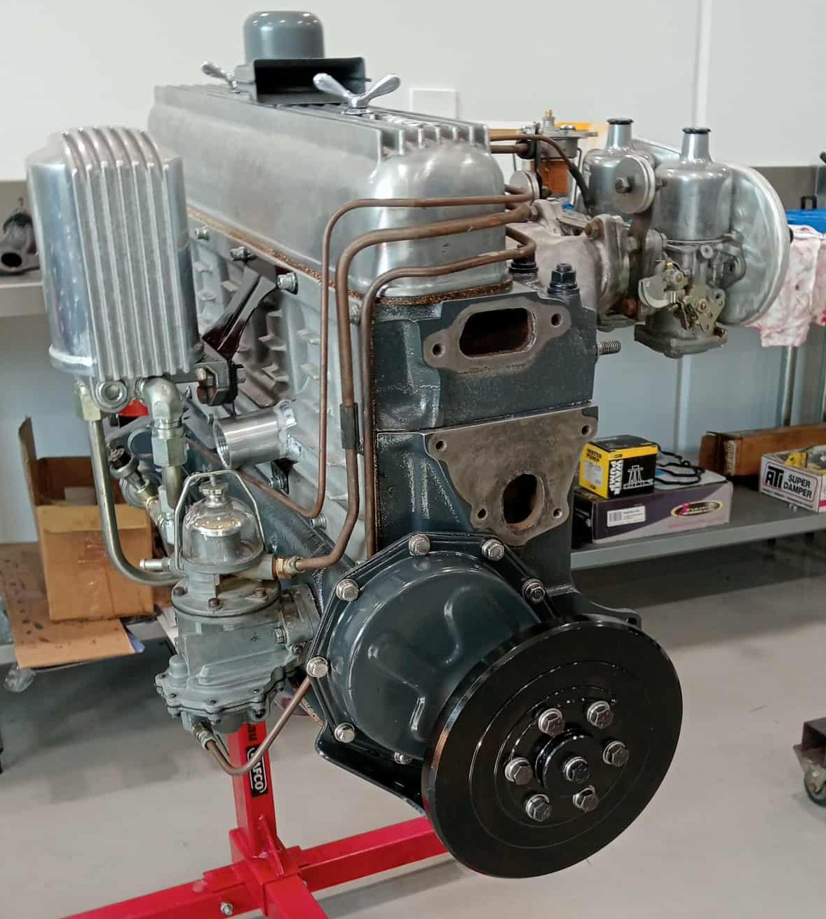

Getting close to going on the dyno. New crank damper fitted up and primed oil system. Working through port matching with the new manifold gasket.
111e9db9-61fa-4423-922c-5db984c34a5f (1).jpg (287.64 KiB) Viewed 2577 times
Posted: Thu Oct 16, 2025 9:52 pm
That oil filter cover looks awesome.

Thanks Harv.
Had to keep with the fin theme.

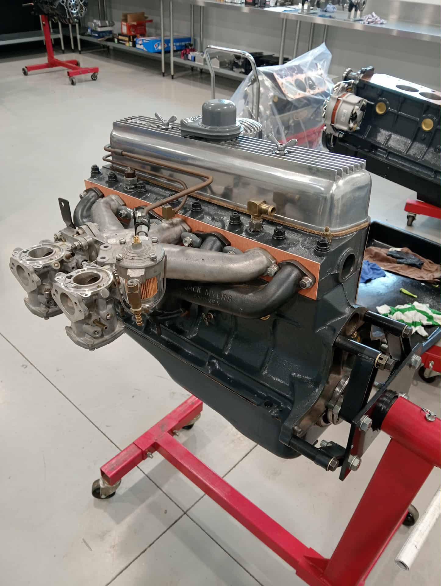

Finished the port matching check. All good but had to go to the card style gasket due to insufficient material in the composite style gasket.
Currently working on a support bracket for the fuel filter and cleaning up the air cleaner housings. Also my OCD has made a start on polishing stuff again.

My OCD would make me trim back the composite gasket.. or externally port match it.

gledge wrote: Fri Oct 24, 2025 11:24 pm My OCD would make me trim back the composite gasket.. or externally port match it.Image
Don't worry, I've been looking at that...........................

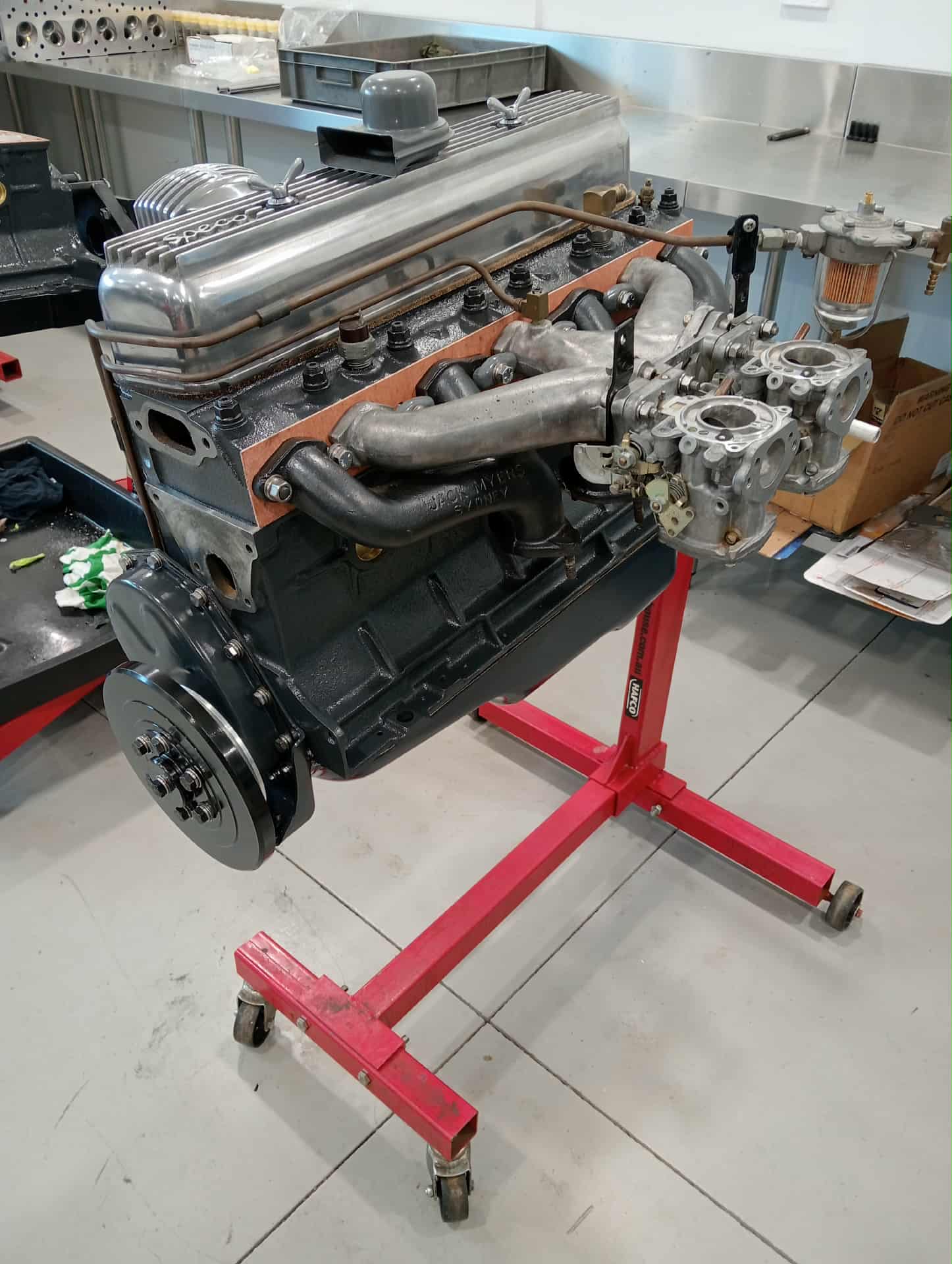

Finished off a few things that needed polishing and a bracket for the fuel pressure regulator. Yes my OCD had me trim up the manifold gasket too. Hopefully test run next week and bedding in cam, then home for run time and tuning on the dyno.

Craig, I am interested in your placement of the Malpassi filter/ regulator. Is vapourisation a potential issue with the glass bowl above exhaust?
Posted: Fri Nov 07, 2025 7:00 pm
by Craig Allardyce
Brett027 wrote: Fri Nov 07, 2025 6:48 pm Craig, I am interested in your placement of the Malpassi filter/ regulator. Is vapourisation a potential issue with the glass bowl above exhaust?
No, I've never suffered any vapor lock issues with this set up. Under bonnet temps are pretty low and there's plenty of air flow and distance from the exhaust. It's actually way further away from the exhaust manifold than the standard set up.
