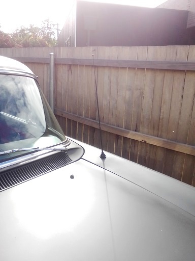

been out to the ute on and off ... only small jobs
put on a nice new black antenna

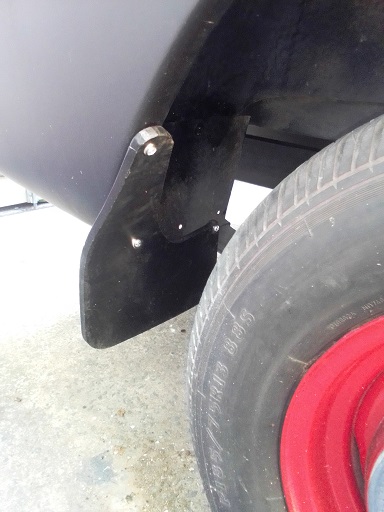

put the old mudflaps back on

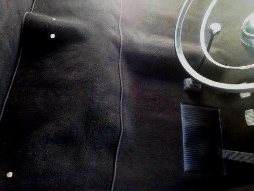

put in the carpet and carpeted kick boards

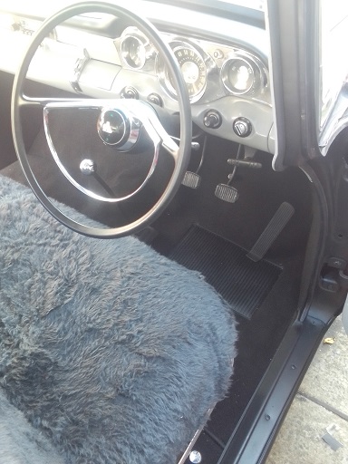

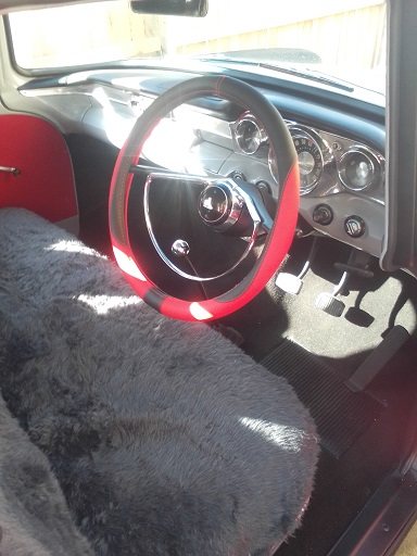

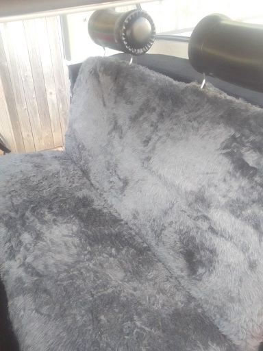

put the fluffy seat in - not bolted down yet because I still need to get to the seatbelt mounts
seat 6.jpg (80.49 KiB) Viewed 826 times
seat 7.jpg (70.87 KiB) Viewed 826 times

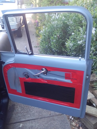

I thought I would break up the greys and blacks inside the ute
so I sealed off all of the holes in the door
door card 1.jpg (85.3 KiB) Viewed 798 times

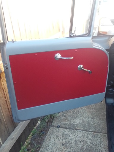

and made a couple of door cards
door card 2.jpg (58.56 KiB) Viewed 798 times
and added a steering wheel cover
steering wheel cover 1.jpg (78.18 KiB) Viewed 798 times

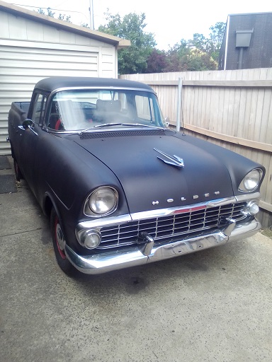

I spent most of the morning sorting spares into tubs - then it got to 34 degrees so I stopped. There's been a cool change this arvo, so I just put the mirrors on - found a spot where the mount follows the body contour and the quarter windows don't hit them

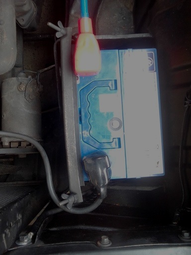

I put in a new battery that I picked up at one of the 30% off sales ... luckily the battery hold down was in one of the spares boxes that came with the ute ... while I was at it I made up an extra earth (to the body) ... and put in a new positive cable that was left over from a previous project

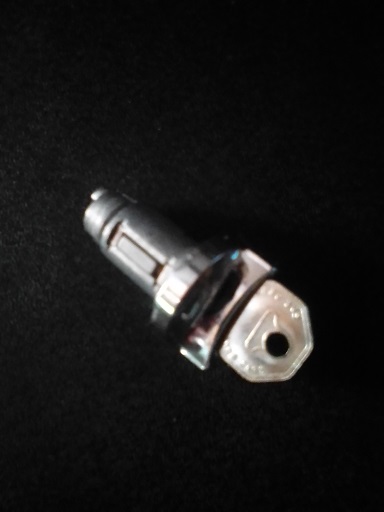

the original ignition tumbler was seized and I wasn't even sure the key in the spares box was the correct one ... I freed it up a fair bit but it was still notchy and would catch unless you pushed downwards on the (only) key - I thought about getting a new key cut and trying it out ... but in the end, for $35 I just picked up a new tumbler with 2 keys)

Posted: Wed Dec 30, 2020 10:04 pm
by In the Shed
Hey Patrick
Looking good. Did I miss what you did for the door cards you made? They came up tidy.
Re: Gimme 5 years
Posted: Thu Dec 31, 2020 8:09 am
by 62ekute
In the Shed wrote: Wed Dec 30, 2020 10:04 pm Hey Patrick
Hi Stephen,
yeah, the door cards that were on the ute were rubbish. I did consider re using the vinyl but because it had been detached here and there for who knows how long it had shrunk (and it was torn anyway) ... I used a bit of each of the old cards to make most of a template and did the rest freehand
the door cards are made from 3.2mm white masonite painted the same colour as the wheels (colonial red) ... I didn't want to put too many new holes in the door so at the moment they are held on by seven screws with painted plastic caps - EK doors are reasonably flat but once you've screwed the door card in at the front and back to follow the shape it bows a bit and needs a couple at the top and one at the bottom ... I've got a cardboard template marked with the positions of all of the old holes and door contours so the card doesn't need to come off if in time it needs more screws (eg. the door handle spring is pretty strong)
I thought I'd give this a go and if I didn't like them it's something that is easily replaced ... anyway for about $20 in materials a piece they need to earn their keep for a bit longer :ebiggrin:
so far I like them
Patrick

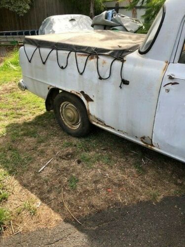

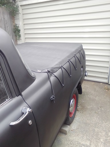

first job for the year ... put the tonneau on just like someone thought it should be in the '60s ... good test for the paint :ebiggrin:
tonneau 3.jpg (44.64 KiB) Viewed 643 times
tonneau 4.jpg (62.73 KiB) Viewed 643 times
