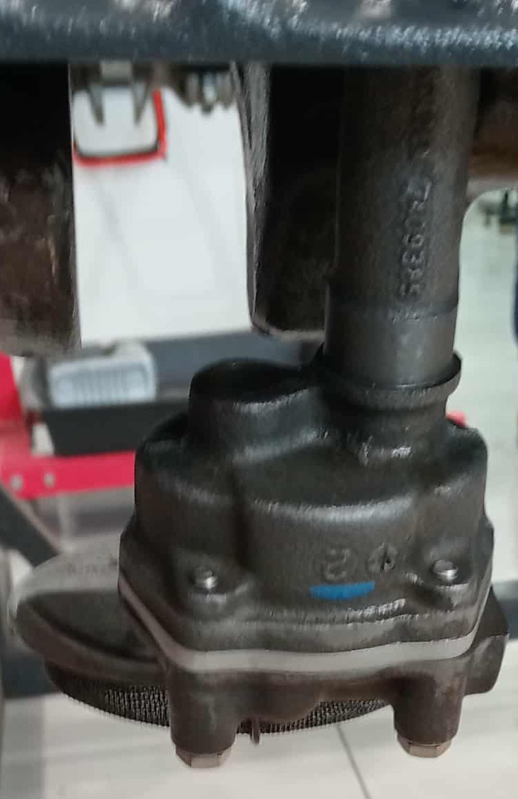

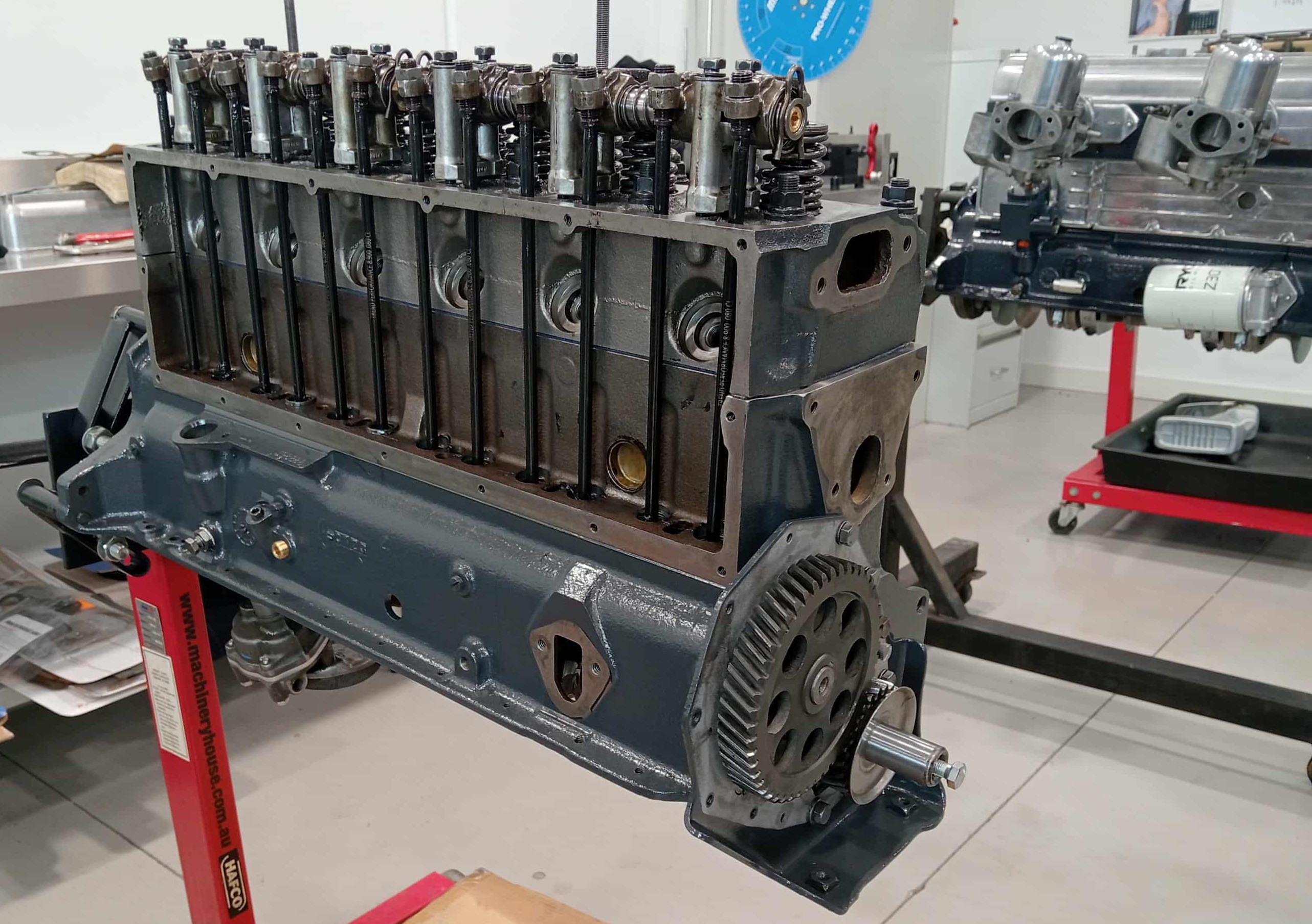

Getting there now with the head on, cam, hydraulic lifters, and new pushrods fitted. Oil pump pick up shortened to allow for the longer gears and now lower pick up height.

Craig Allardyce wrote: Fri Sep 12, 2025 8:56 am 9.9:1
:ebiggrin: :twisted: You doing anything fancy with the main caps ? They look to be stock with stock bolts in your photos - not planning on revving the pizzle out of this so no need ?
Posted: Fri Sep 12, 2025 9:53 am
by ardiesse
. . . but it's what's in the background that's caught my eye, with which I spy -
- a Repco head
- a right-angle magneto drive
- steel main bearing caps
- a most clever full-flow oil filter conversion using the fuel pump flange for mounting and the existing hole in the crankcase to get the oil in and out
- two SUs canted over at a ridiculous angle for road use, suggesting
- marine application?

Blacky wrote: Fri Sep 12, 2025 9:04 am
No, it's a stock bottom end apart from the vibration damper. It's all in moderation mate. I'm getting old haha.

ardiesse wrote: Fri Sep 12, 2025 9:53 am . . . but it's what's in the background that's caught my eye, with which I spy -
- a Repco head
Rob your almost right on all accounts. The right angle drive was originally a twin distributor drive possibly for a Waggott head as I believe the later versions may have been twin spark plug. I'm running a single distributor. The existing hole in the block will be only used to get the oil into the block. There is another one I put in the block just forward of that for the exit point for oil from the pump. I'm still working out what I will do with my dry sump set up. The SU's are set up at 12 degrees which is the shaft angle in the boat.

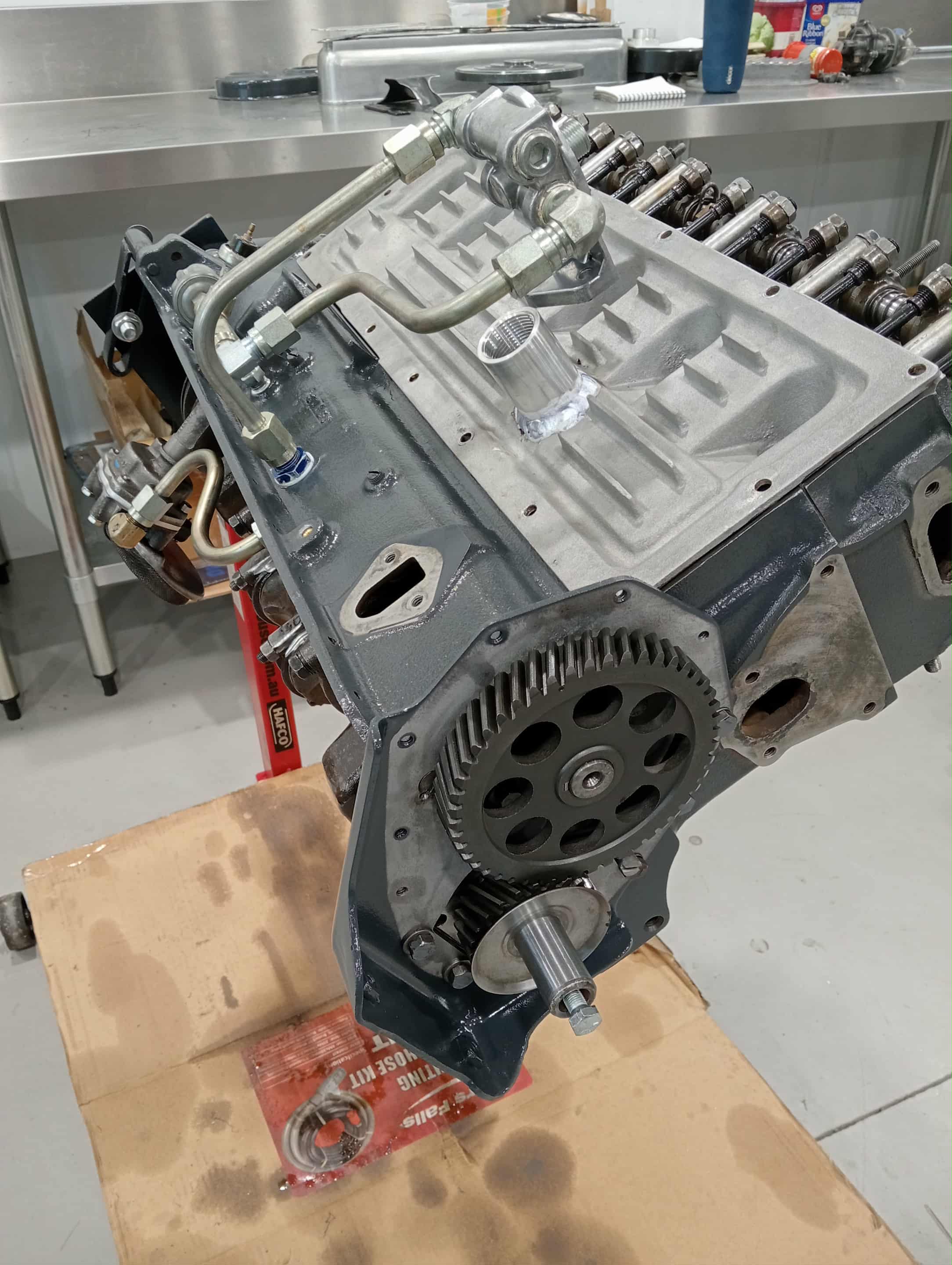

by Craig Allardyce
Plumbing adjustment done for the oil pump spacer. Also modified the side plate breather port as I'm going PCV.
