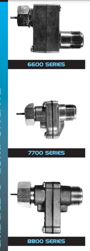

I bought a speedo corrector box off Close Enough Engineering in Castlemaine - it works a treat :thumbsup: One thing the numptys on the other end of the phone dont tell you is the bloody thing wont just screw into the gearbox as advertised because the subframe rail is in the road - you need to buy a short speedo cable to go from the gearbox to the corrector box and if you are really cashed up a shorter speedo cable to go from the corrector box to the speedo - I skipped the last bit .
Posted: Wed Nov 17, 2021 7:17 am
Did you get the clash issue on a grey motor crashie Mr Black? I'm going to need to do a similar converter box for the meth monster project, but have only done part of my homework (I think the dog ate the rest :)).
From what I understand, CRS are selling the Clark Instrument speedo correction boxes (see page 54 onwards in the catalog below):
http://www.clarkbrothers.net/pdf/MC794_CBI_Master3.pdf
Have you got a photo please of the clash issue? Not sure if CRS sent you the straight through 7700/8800 series adaptor, or if the 6600 offset one would have helped:
Clark instruments speedo adaptors.JPG (35.02 KiB) Viewed 706 times
They also make right-angle adaptors to turn the cable... depending on the answers above, one might be needed:
http://www.clarkbrothers.net/pdf/SC795_Catalog2.pdf
To help the next bloke ordering, the cable for a grey motor crashie is 0.104" square, and the cable-end thread is 7/8-18UNS.
