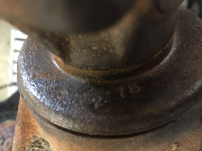

Purchased a LJ Torana diff this morning. Just need to cut off the unwanted mounts and weld on spring saddles.
I'm hoping the brakes are a straight swap over as this one is lacking everthing.
LJ diff 1.JPG (146.76 KiB) Viewed 1759 times
LJ diff 2.JPG (91.39 KiB) Viewed 1759 times
Don't think I will have an issue with the 2.78 ratio as the motor is a blue 202.
Diff came out of Torana with a big block 161.
Re: Ammo's Ute
Posted: Tue Jul 26, 2022 5:46 pm
Straight swap to EJ HR brakes with a bit of pipe relocation. Tall diff will be good on the run to Perth. Don't go too tall on your back tyres. Be good with the auto.
