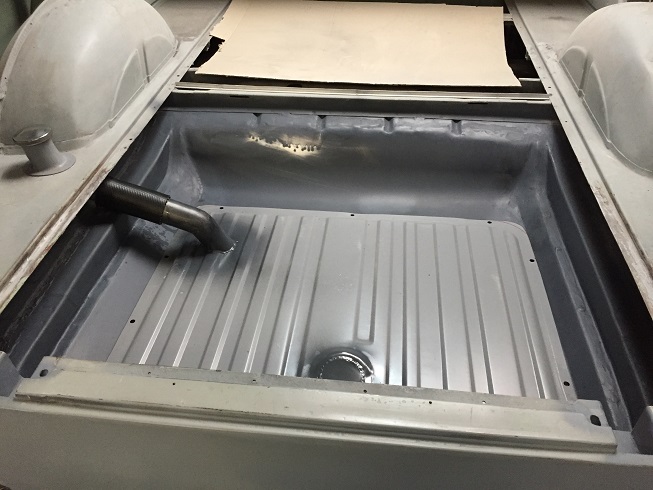

I have the new 16 gallon, 64 - 68 Mustang tank now for Custom Mustang in Melbourne.
Including the pickup and mounting screw $384 delivered to Adelaide.
I needed to fill the big hole I cut from the XB tank so I built a frame.
A bit of cutting, a little rolling and folding followed but a bit of welding.
Then a heap of grinding.
With no shrinker / stretcher I had to do the old pie cuts on the front edges.
The rear corners were a bugger but happy with the results.
I did a slight trim on the corners of the tank to get it to sit down.
The next one I do will be for Retro Richard but so much easier now I have had a practice. Cut the inlet off and will patch then add a new one to match the in tub setup I have.

Happy to say I have finished the fuel tank.
Relocated the inlet to the side. .

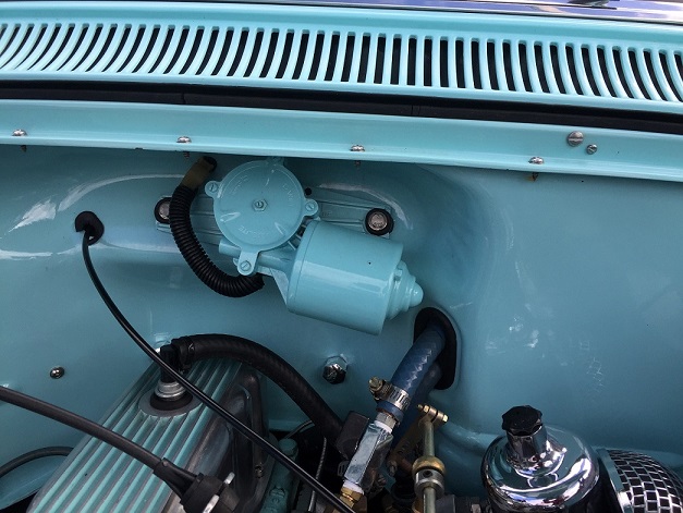

Started playing with 2 speed wiper motors from early Corolla's after seeing Phil Grima's setup at the Nationals. Not sure where this will end or if I need wipers at all. Just keep the ute in the shed when it rains

You have paint !!!!!!! And shiny things !!! Looks sweet, what colour is it ???
Looks like you have made some nice progress ???

Subtle mod on the wheel tub Roger, deleting the filler recess.
Reckon that is Phil’s car blacky.
