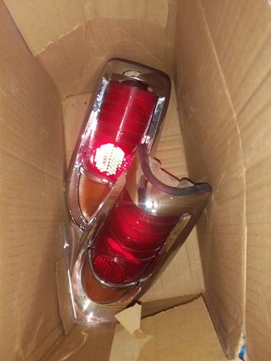

pulled the tail lights apart, cleaned them up, pinched some bits from another pair and put new seals in
tail lights.jpg (68.77 KiB) Viewed 610 times
