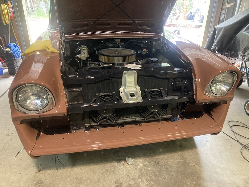

I took option E
Cut the width, then welded in some folded c channel.
The radiator frame slides into it, very strong and a self tapper holds it in.
It cant move side to side or up and down because of the top support, looks good to !!

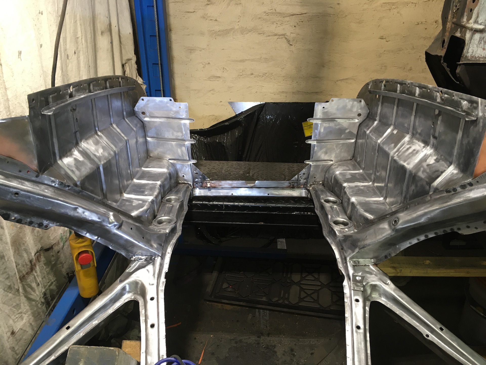

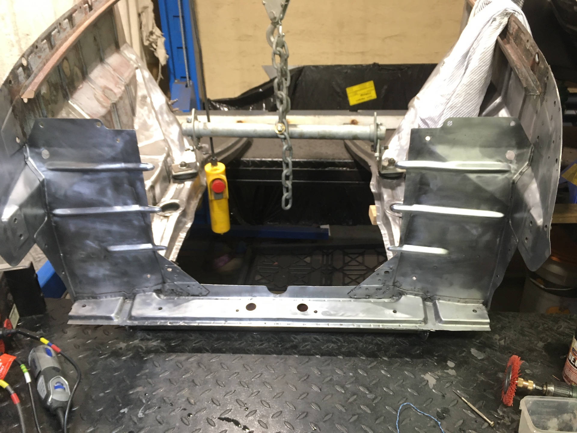

Think I'm done with this. Needs paint, but I've gone over it with deoxidine and sealed it for now with easyphos so should be good for at least 6 months stored dry. Just got to find somewhere to hang it up. Look forward to having a bit more room to move.
Front had a few holes to fill, but apart from that it was just a bit (lot) of time on the wire wheel, powerfile, and die grinder.
Inside just needed a tidy up where I opened up the front for the radiator. Bit of surface rust where the sides join the front, ground out as best as I could, wire wheel, then poured some Ranex in there to reveal what I had polished up and not removed. More grinding, wire wheel. Done.

The best I could do hanging it up. Clears my head. Just. Image
