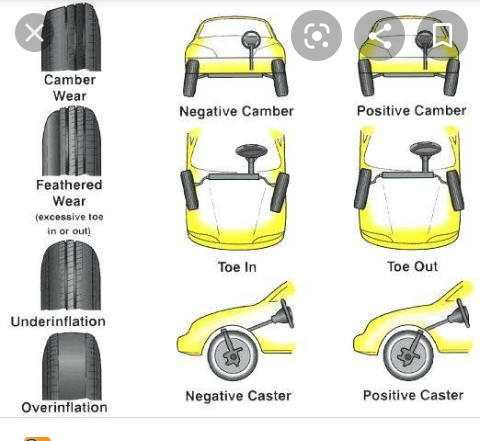

Patrick's diagram is a very useful aid.
To which I will add -
Uneven caster makes the car pull to one side. Then the outside of the front tyre on the side the car pulls to, shows feathered wear. Remedy: increase the caster on the side the car pulls toward (or decrease caster on the side the car pulls away from). A very slight pull to the right on a level road is OK, because most highways are cambered.
The only reliable way of measuring toe-in is to chalk-mark the front tyres, put the car on the ground, roll forward a yard or so, and measure the chalk marks front and rear. I've had a couple of front wheel alignments done where the toe-in was nowhere near correct, because it was not measured in a rolling condition.
If your camber is positive, set the toe-in to the more positive limit. If your camber is zero or negative, set the toe-in closer to (or even) zero. You can find the optimum setting quickly by road feel. If the car feels "wandery" at straight ahead, increase the toe-in slightly.
If the steering wheel is angled at straight ahead, correct the condition by equal and opposite adjustments of the tie rods, once all the other angles are set correctly.
Frequent cross-winds will cause front tyre wear that looks the same as under-inflation. This is more a Humpy problem.

Did your front wheel aligner note down the numbers? I would aim for something like zero camber, 1 - 2 degrees positive caster, and 1 - 2 mm toe-in. If you say "light and twitchy" at speed, I'd suspect that you need a little more toe-in; possibly bring the camber back to zero if it's negative; and maybe more caster is needed.
A twelfth of a turn on each tie-rod tube (use the nuts as guides), and see if the steering feel improves.
