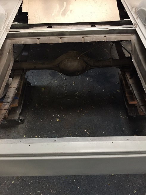

If you have welder you can un-do any quick decisions made, with the angle grinder.
I trimmed up the hole today so I have fairly straight edges to work with.
big hole.JPG (110.76 KiB) Viewed 1645 times
Thanks Clay on the heads up on the exhaust. I would be spitting if I have completed the XB tank and then fitted the driveline and exhaust.
Posts: 2687
Re: Ammo's Ute
I did the XB tank in a sedan.
A couple of things to also consider, diff pumpkin with a frod 9 inch will hit it so needs a cut out in the tank to clear it. Normal diff should be ok for clearance.
You may have to massage the tank where the spring hangers are because the shackle bolts are real close under load.
I also built a frame to sit the tank on with captive nuts and it turned out a neat fit.
I have dual 2 1/4 exhaust over the top of the springs with no issue.
