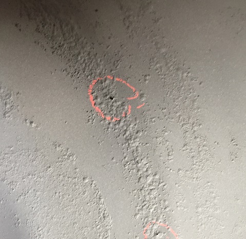

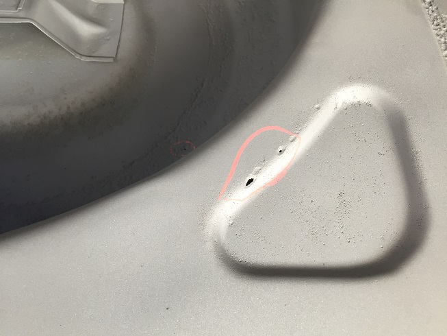

I got stuck into the fuel tank today and OMG.
Firstly the tank purchased on Market Place with the seller telling me "mate, good tank no holes". I call BS as I hade the tank grit blasted and found a number of holes. :evil: :evil:
Holes 1.JPG (94.33 KiB) Viewed 819 times
Holes 2.JPG (93.5 KiB) Viewed 819 times

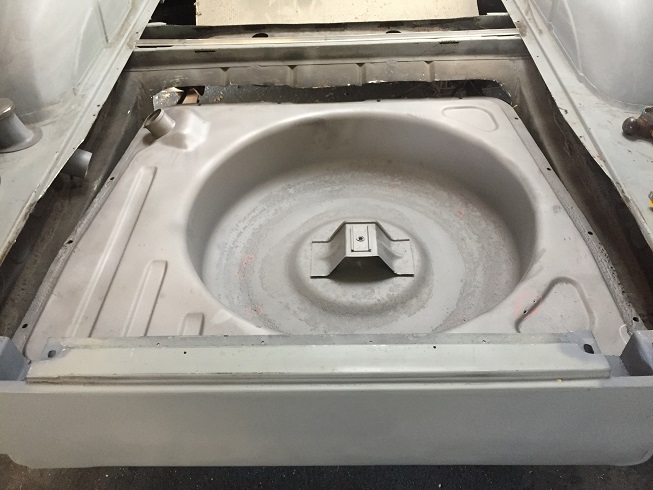

Next the tank is wider than the opening in the ute and wider than the rails.
The nuts on the spring hanging are on the inside, for neat look, which now need to be reversed.
Cut, cut and more cutting, grind cut and grind again then finished with a little shaping with the BFH and it is nearly in.

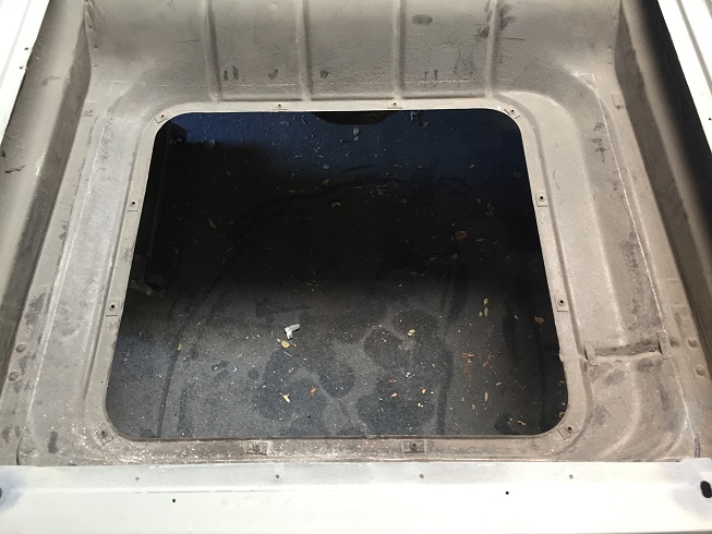

Old tank out.JPG (108.1 KiB) Viewed 819 times
tank in.JPG (103.04 KiB) Viewed 819 times
AS you can see the edge of the tank overlaps the rails.
I will be building a frame to sit it on with nut serts
In retrospect, it would have been easier to cut the original tank in half, add a section and weld it up.
Possibly used a sedan sender.
Another option could be early model F*#@D tank as they may be a little narrower.

That is a bit of a pain in the butt Roger. What is the plan to seal the tank? Maybe a two part tank lining epoxy compound?

Steve, I will weld the holes in the tank via bronze weld so I can control the heat.

Mate a brand new Mustprang tank is only a few hundred bucks and they fit nice , just don’t have the spare wheel well

Sounds like a plan Roger, could also silver solder?
Posts: 2465
Re: Ammo's Ute
Yes, or just plain solder.
