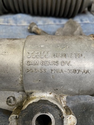

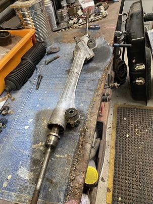

Grabbed a TE Cortina rack from Dudley's paddock on Saturday morning.
Scrubbed up fairly nicely
TE cortina.JPG (87.36 KiB) Viewed 4807 times
Cortina TRW rack.JPG (63.64 KiB) Viewed 4807 times
Just waiting on the drop stub axels from Stub Tech to arrive and then I can work on the mounts and steering arms.
Small steps forward.

you want a pair of HQ short steering arms mate , and a pair of VB/K tie rod ends, they will screw onto the rack ends - you will also need to reverse ream the steering arms so the tie rods go in the other way
When I get home I can measure where my rack is so you can make mounting brackets if you want.

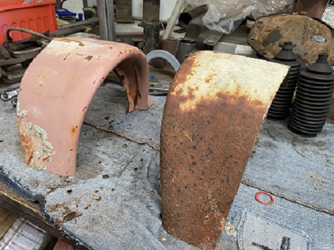

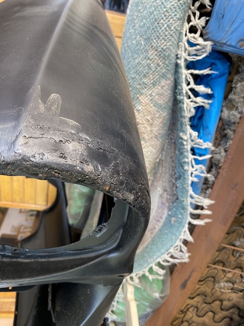

Another trip to " Dudley's " this morning, as I need to repair the front guard peaks.
The very rusty on was a guard buried in a pile of stuff. The other from EK wagon that had the roof cut off.
So no " good " guards were harmed :D
guard peak.JPG (97.96 KiB) Viewed 4649 times
These are the 2 guards I had to work with. Previous repair hidden under bog.
RH guard.JPG (116.54 KiB) Viewed 4649 times
LH guard.JPG (130.58 KiB) Viewed 4649 times
Time to cut and weld. Wish me luck with the TIG.
