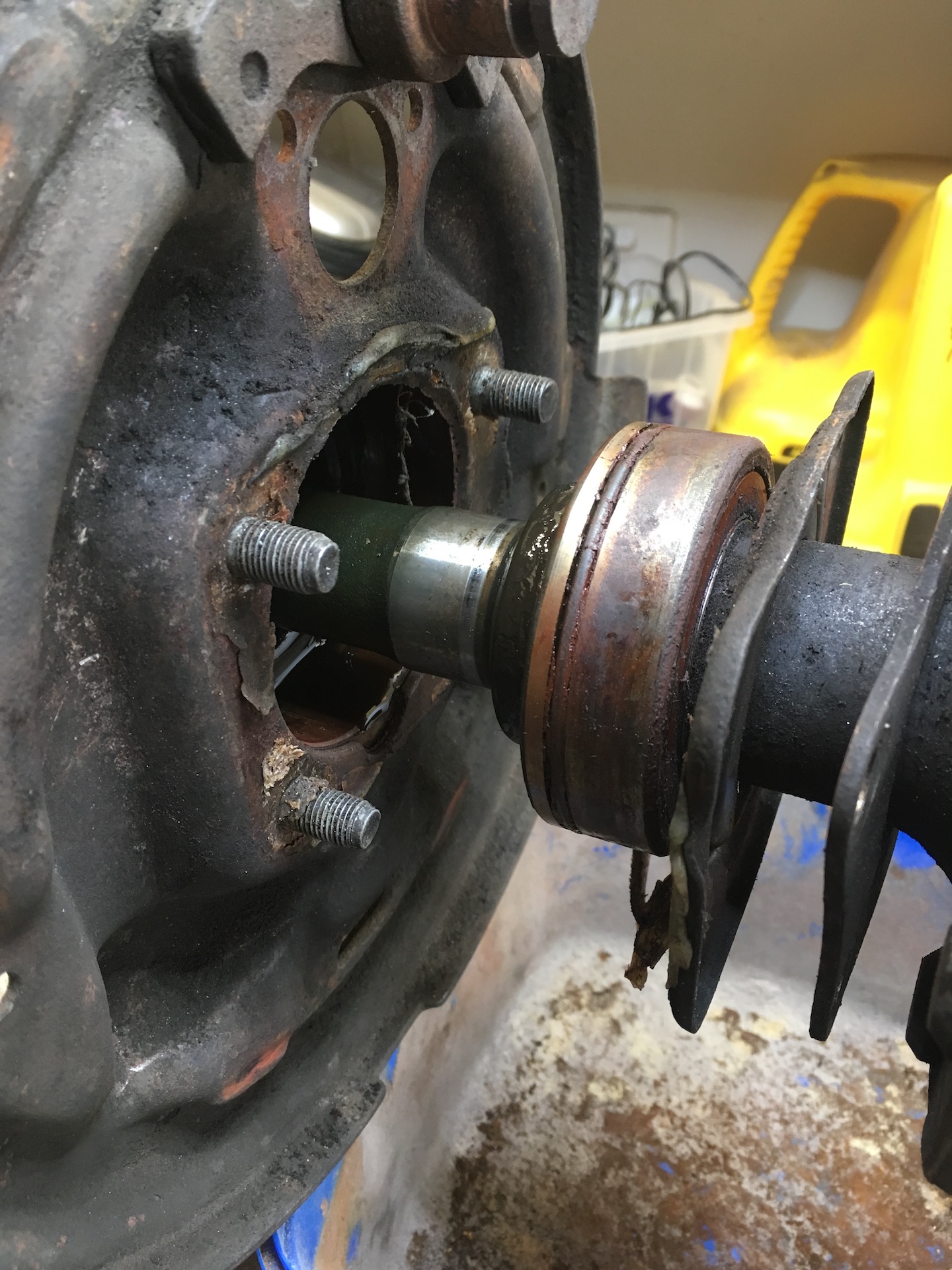

Axles out. Those bearings look a bit rough but weren’t noisy.
. Is the orientation the right way round with the I ring on the inside? Note to self, take them out when the diff is still bolted to the car!

Rear wheel bearings - yes, they've been installed backwards. O-ring on the outside is the normal way. But don't change them just for the sake of correct installation.

Figured the bearings were the wrong way round. Read that the o ring is to seal water and dirt out, not oil in. Is that true? Anyway decided to leave well enough alone for now.
