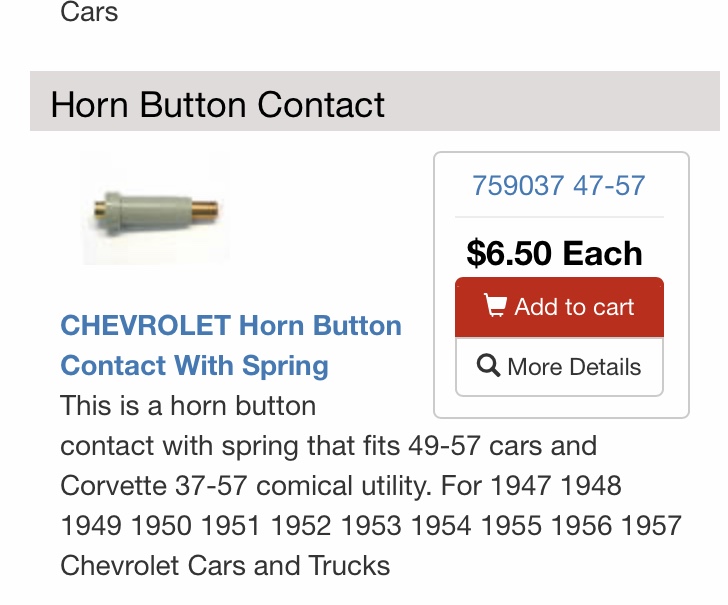

Thanks mate. Part number is 759037 47-57. No dramas if it doesn’t work out.

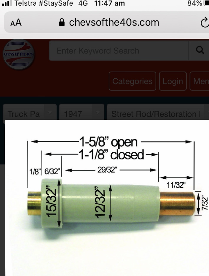

I couldn't even remember what i had ordered - this is it her , no idea of dimensions just taking pot luck at this :lol:
https://www.chevsofthe40s.com/detail/34 ... pring.html
Was $10 for the part , $15 to ship to LA , plus shipping from there to Perth and wait 3 months, probably would have been not a whole lot more to ship direct .... if they work I will get 20 of them or so to make it cost effective - Rares ones were $37.50 each but probably made in China by the look of the photo of the one on the Rares site.
