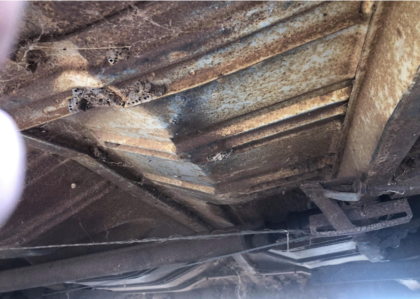

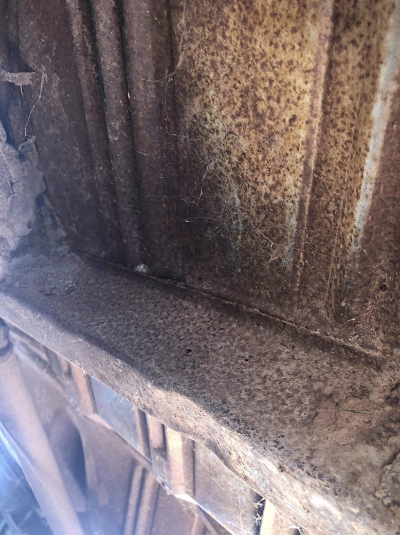

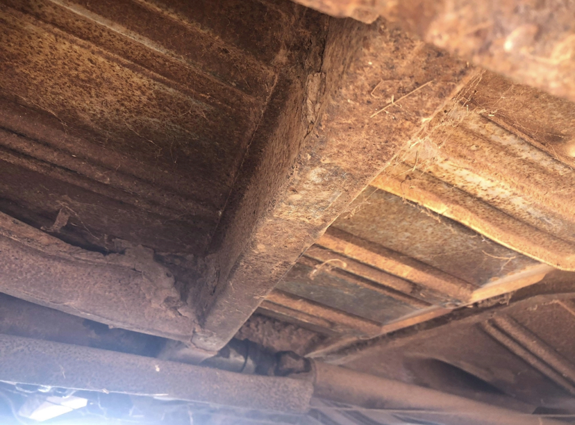

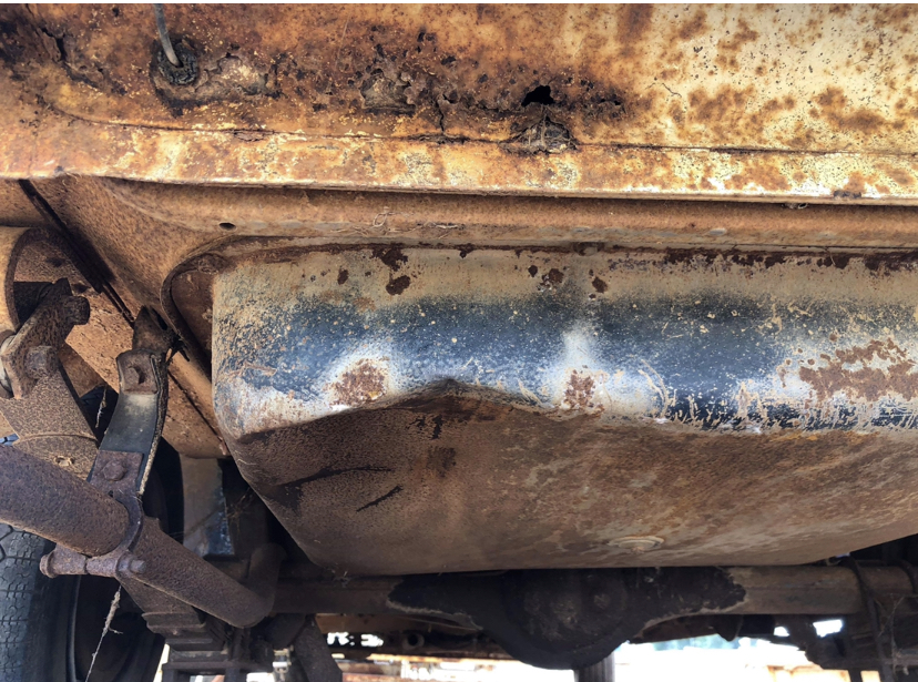

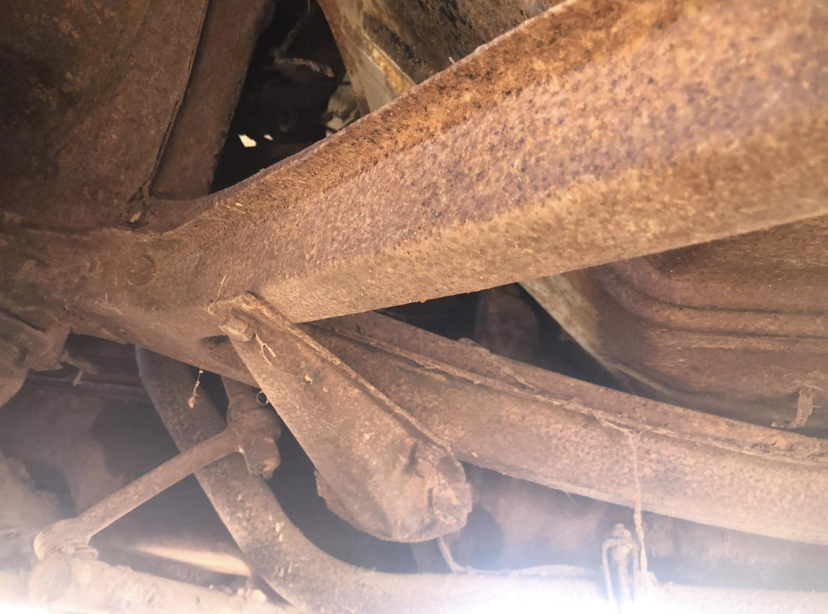

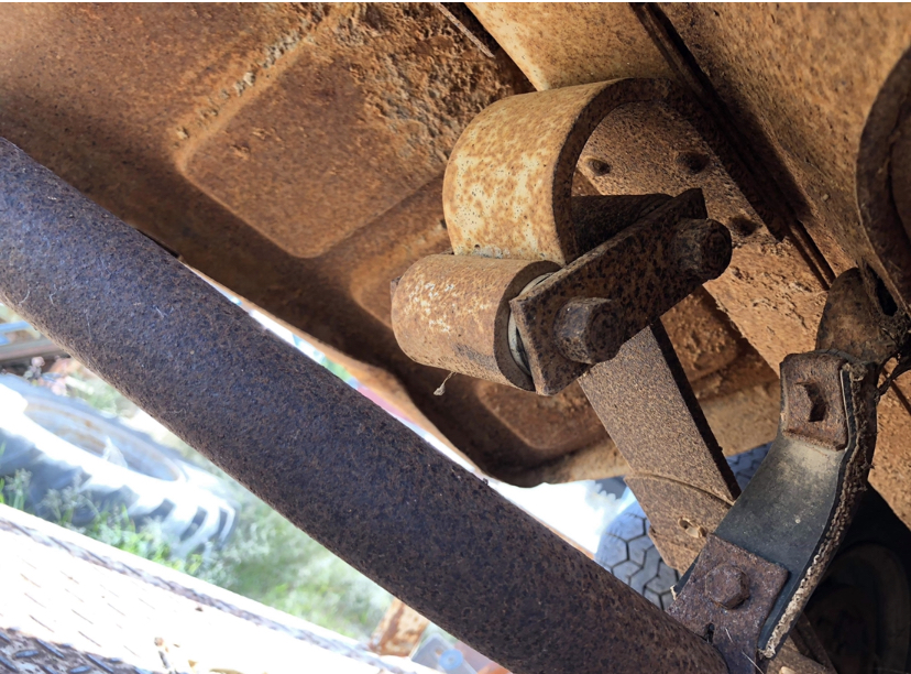

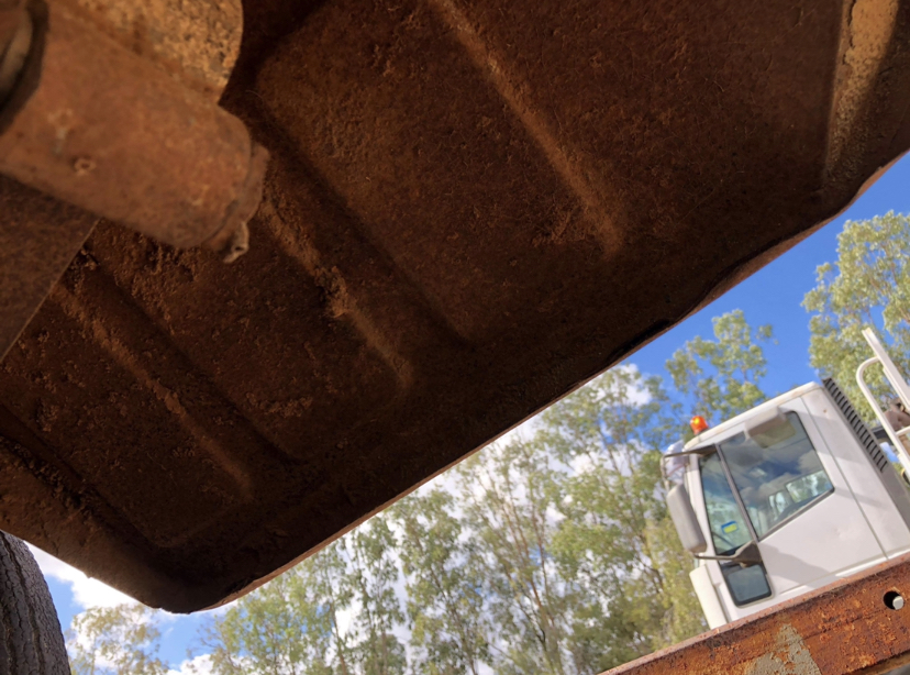

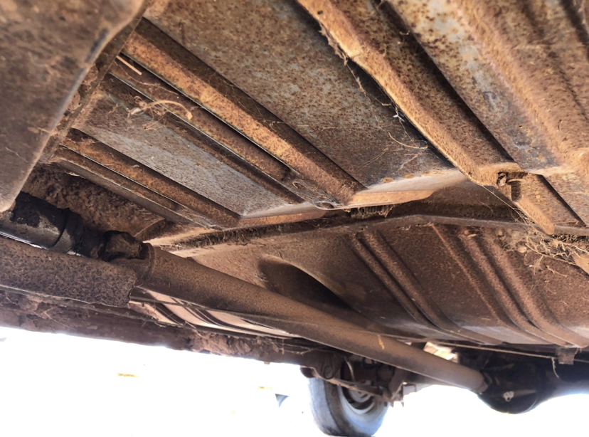

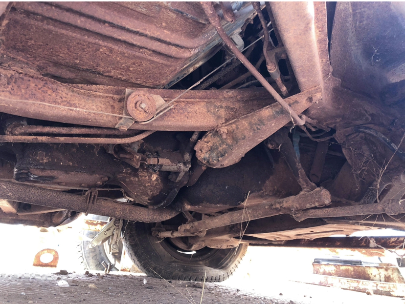

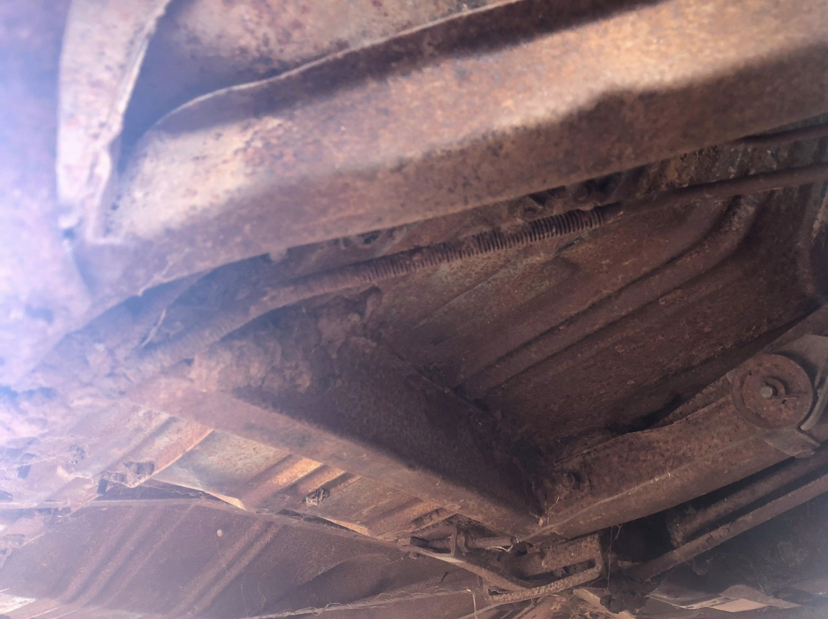

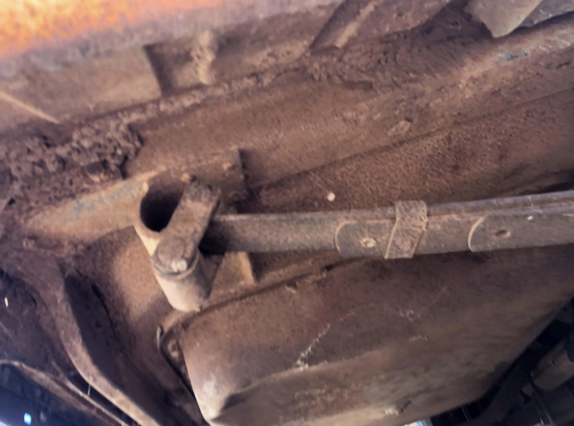

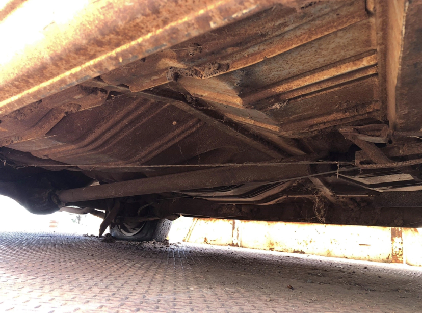

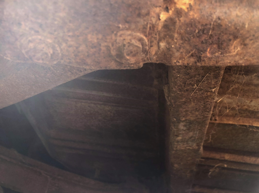

And these are the last photos I have, the underbody area.

And a few more phots of underbody

Finally some rust in the rear beaver so now I believe it is an FB. 585 9895 is honey beige dulon acrylic, same as my panel van and was the old Electricity Trust of SA fleet colour. That doesn’t me@n it was an ETSA car of course, but my van had the fleet numbers painted in yellow inside the hub caps. You said it came from western qld but is an Adelaide body by the number. What about subframe number? I’m beginning to wonder if all wagon bodies were made in Adelaide Woodville as were the vans, due to the size of the press required to form the roof panel.

I'll echo Clay's comments about rust: it took a lot of looking, but you finally found some.

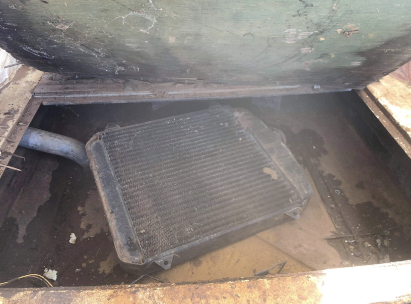

And it's good that you have an original radiator core. They last forever. So find an old-school radiator shop who is prepared to take the tanks off and clean the tubes out.

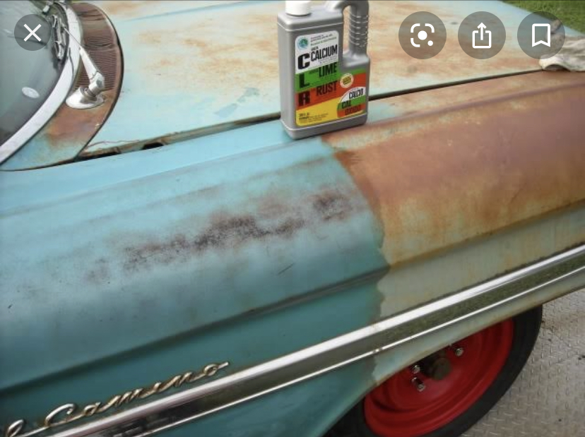

Seems a mix of CLR with water at a ratio of 1:4 does a good job a cleaning up for the patina finish...
Has anyone been successful with holding a nice patina on their vehicles?
